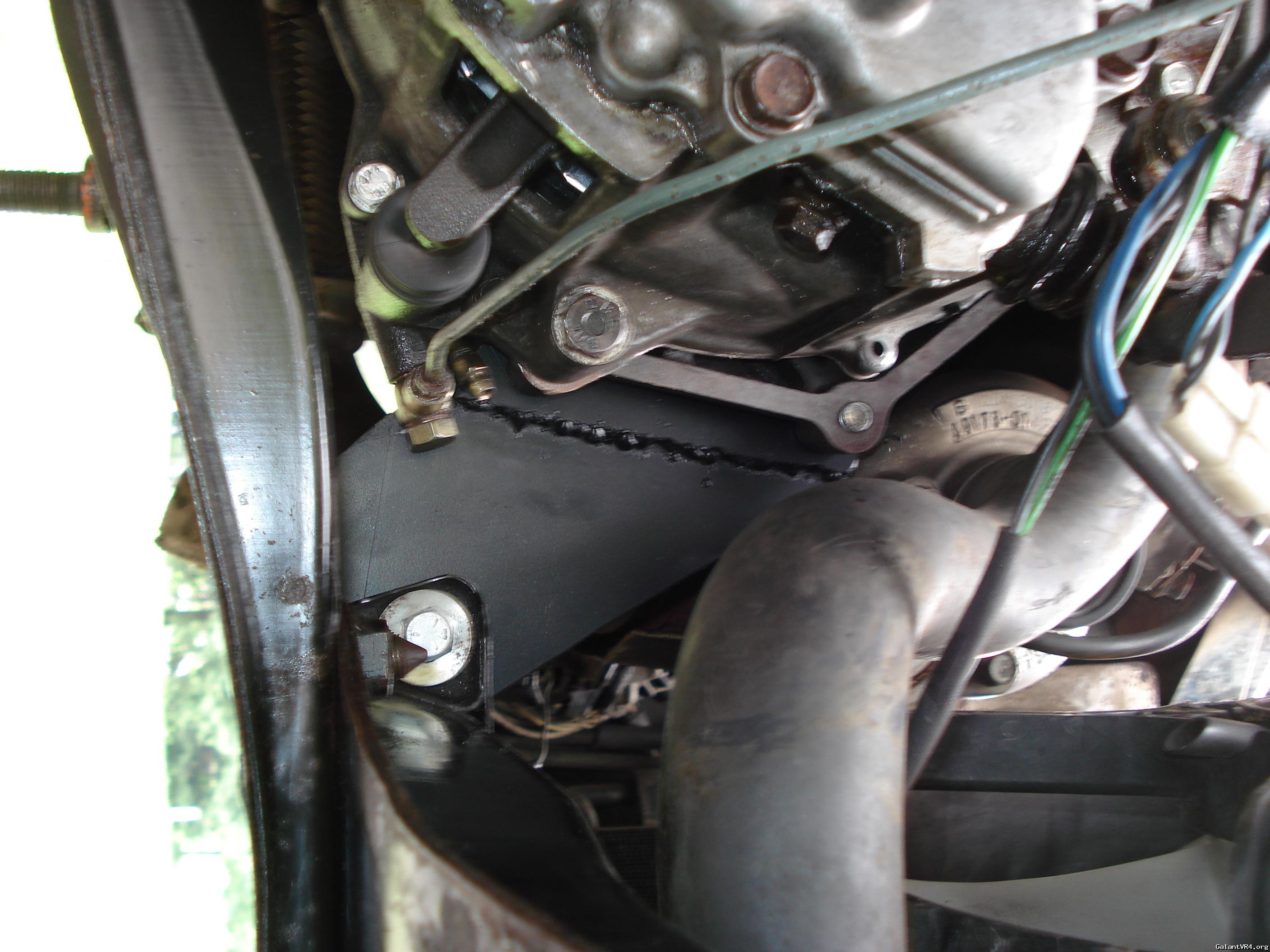

front engine bracket.
hey guys Swanee here, s i bought 1138 about 4 months ago and it has the 2.4 stroker 4g64 block, as most of you know the front motor mount for this block was completly different for our cars, so i custom fabed this new one out of 1/4 inch thick steel, bc befor the engine was all over the place and i ended up crakin my bellhousing bc it was seperating from the block to the trans, so far this bracket seems to do the job quite well just i can feel the vibes rea good sitting in her at idle.
