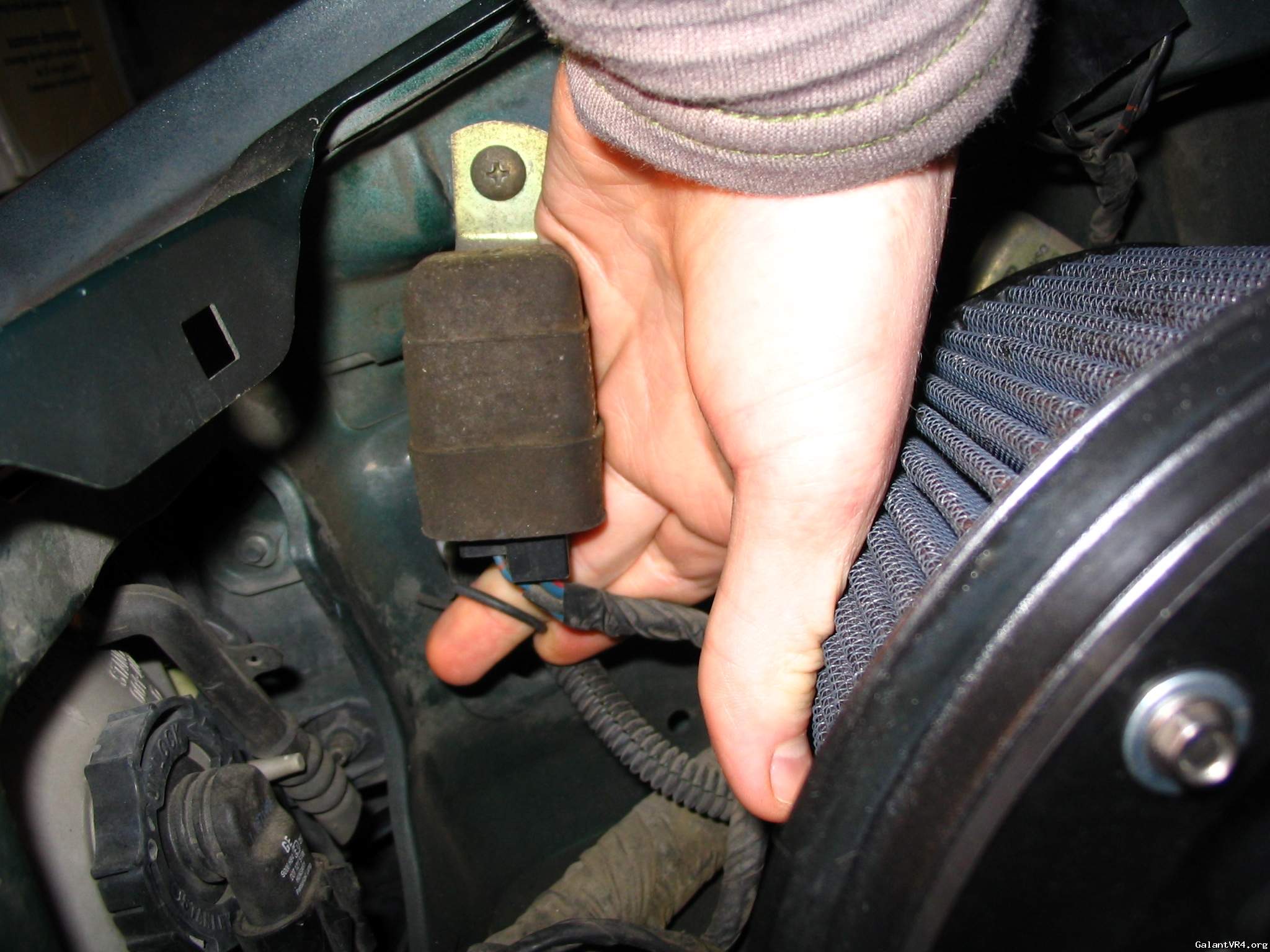

there is a little spring with a hook on each side that hooks around the light and around the frame of the car. its down in there kinda hidden so u really need to look or remove some stuff to get a better view. Try doing the Passenger side first cause u can see it easier so when u get to the DS u will know what ur lookin for
On a stock car, there might be some stuff in front of the PS clip, like battery or intake piping or something, but it's been a while since I've seen one of those. /ubbthreads/images/graemlins/wink.gif Here's me holding the PS clip:

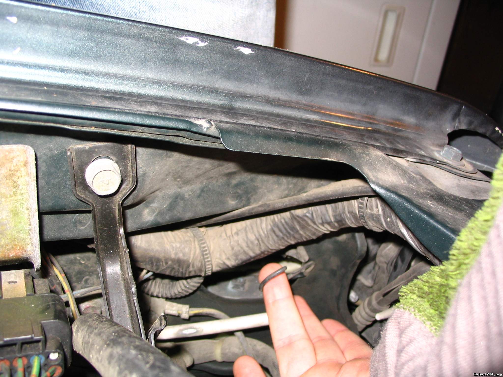

On the DS you have to remove the coolant overflow reservoir, which just slides up and angled slightly towards the PS off it's bracket. Here's me holding the DS clip, after removing the reservoir:

Spectacular, thanks for the help and pics gents!
Luckily it's the PS and I have a K&N filter to make access a little easier.

Just finished the bulb replacement, thanks again for the pics!
I also suggest following the directions in the other link, gently push the front of the lens towards the headlight then push the whole lens forward to separate the lens clips from the body.
