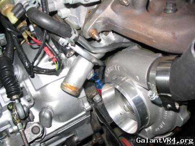

turbowop
Apr 29, 2001
11,972
Yakima, WA
Old pic, but this is what I did:
SS line from the water pipe to the front of the turbo, stock line coming off the back massaged to fit.

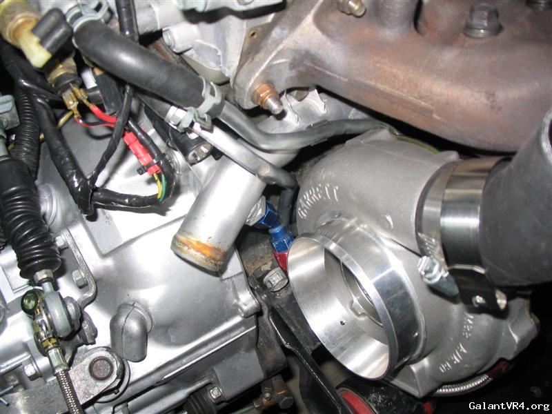

mitsuturbo
Jun 2, 2008
3,551
Near Seattle, Washington
You could try doing what i did...
That's a -6 AN line with a 45° and a straight fitting.
Water pipe adapter fitting is M14x1.5 to 6AN
Turbo adapter fitting is M12x1.5 to 6AN
