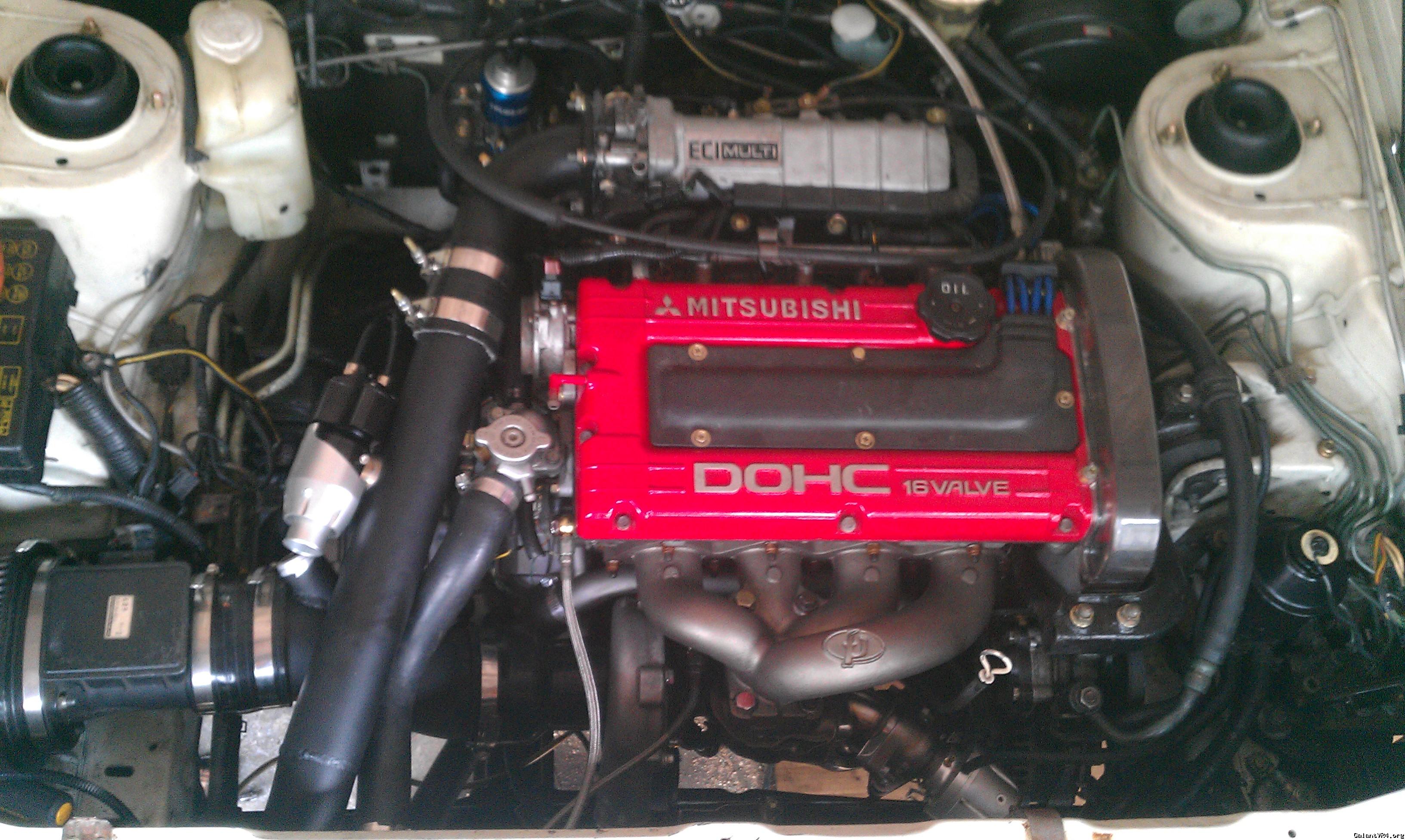

Who is running a FP manifold and is running their intercooler piping over the manifold as in the factory route?
So I have a little flange coming off the compressor outlet on my 16G and a coupler that connects to the pipe that goes over the manifold. I'm having a problem with the coupler touching the exhaust manifold. I was wondering if anyone had any good ideas on how to re-route with without using a j-pipe.
If anyone has any pictures they'd like to share that would be cool.

OP: I have an old RRE pipe for my turbo outlet and it fits great with my 16G and FP manifold. It sounds like you just need to have a shop build you a new piece.

Yea i know, but just throwing it out their, If I were him i would buy a 1g j pipe instead of the j pipe for the gvr4.

Quoting prove_it:
That's not a 16G. LOL
Do you have a picture of it?

Quoting MellowVR4:
I can't use a 1st gen j pipe due to the fact that I'm running a factory radiator and fan.

then it might need to be extended in some way by a fabricator, maybe cutting it at the flange and extended it might help. It would help if you post some pics of the issue, is this the ETS j pipe for the gvr4??
