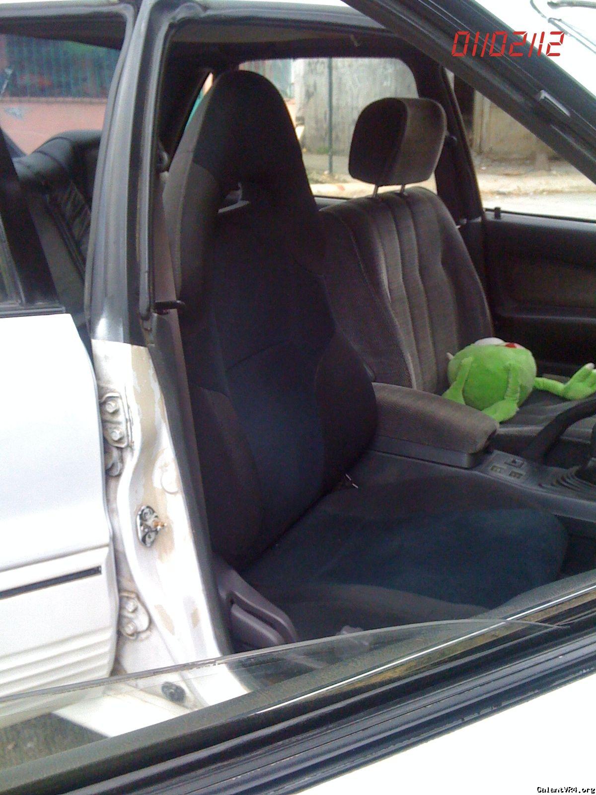

hello everyone,

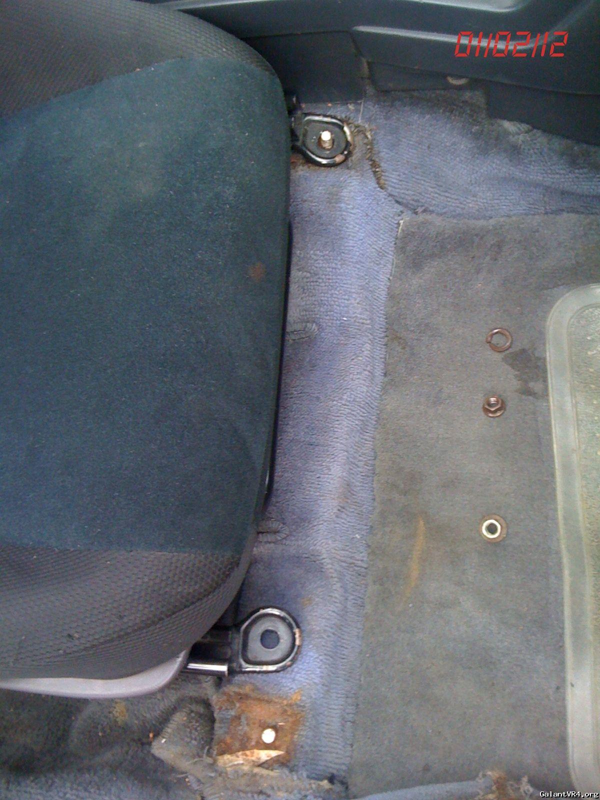

my friend gave me these seats for Christmas, he said i could use another set of seats since mine were worn out and springs started hurting my butt. i believe these are JDM Celica 96 semi buckets. I tried installing them this afternoon, but i can't. I need help or a step by step guide on how to fit these things. How to make brackets or something like that. Any help is highly appreciated.
Thanks! /ubbthreads/images/graemlins/smile.gif

Do you have access to any aftermarket seat rails that bolt into the Galant. Sparco, Recaro, Bride etc. If you have brackets that will bolt into the car, all you then need to do is make an adapter plate with holes drilled in the correct place to fit your seat onto the new rails.
those look like standard usdm celica seats, had a set in one of my old Colts. Great seat for a daily driver. I would try to get another set of galant rails (standard or aftermarket), align the celica seats in the car like it looks like you have (sit in the driver side to make sure the wheel is directly in front of you) then mark them and come up with a solid base between the two. My only helpful advice is this: overbuild it, because a seat that comes loose in an accident is not what you want.

And just for the record, WHAT IS THAT on the passenger seat? /ubbthreads/images/graemlins/rofl.gif

I'll keep you guys posted on the updates done and with whatever alternative I may have taken to do it. that's actually my daughter's stuffed doll. Mike Wazowski of Monsters Inc. She usually leaves toys behind after riding with me.
