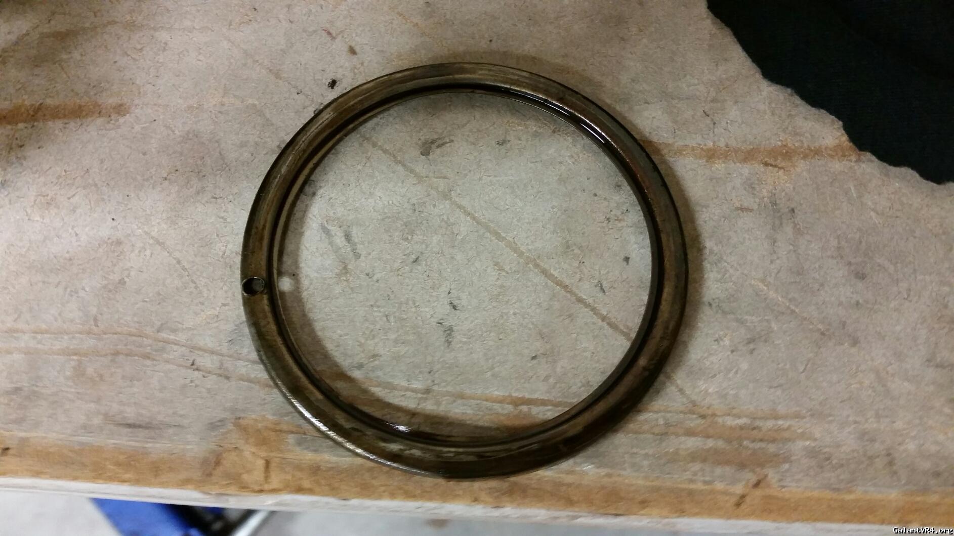

While stripping the block I pulled the rear main plate off and this metal ring fell out. It is a little bent up. Is it like a seal retainer or some type of oil slinger? How exactly is it installed?

It is a main seal retainer. Put a new seal in then this one. It sits beween the seal and the block once the seal body is attached to the block. It prevents the seal from moving towards the block.
