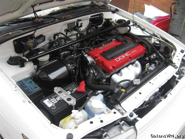

I'd just pick any color or a red that you think looks close. It's not like there is anything you are matching it too anyways. It was the only thing red under the hood unless you have the JDM intake. And even then, they have faded over time.
I painted one in the satin wrinkle red that the hondas used on the type r motors, looked better than the factory red anyways.
Look at it in this pic.
Wiz

I was a bit confused at first, until I remembered... Galant VR4 valve cover is red, what I am asking about is for my Galant GSX. So I guess my next question is, because I want under the hood to be how it rolled of the production line, does anyone know if the Galant GSX had a valve cover like that of a VR4 or like a DSM? Currently it has a DSM style valve cover...

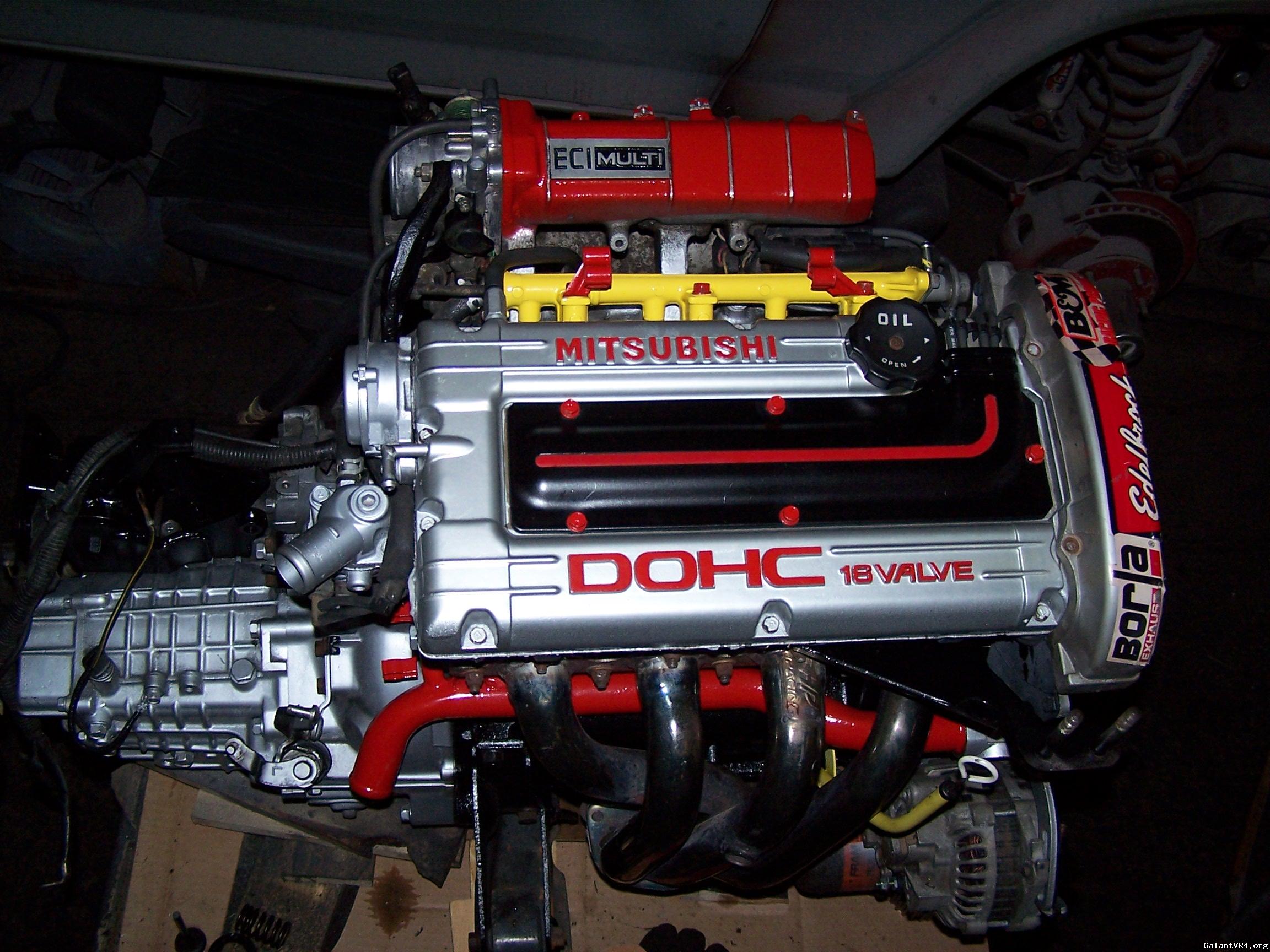

Justin at Detective Coating powdercoat's them to a very close red called "Mirror Red" I love it.
Looks great in the bay, And lasts way longer than paint.

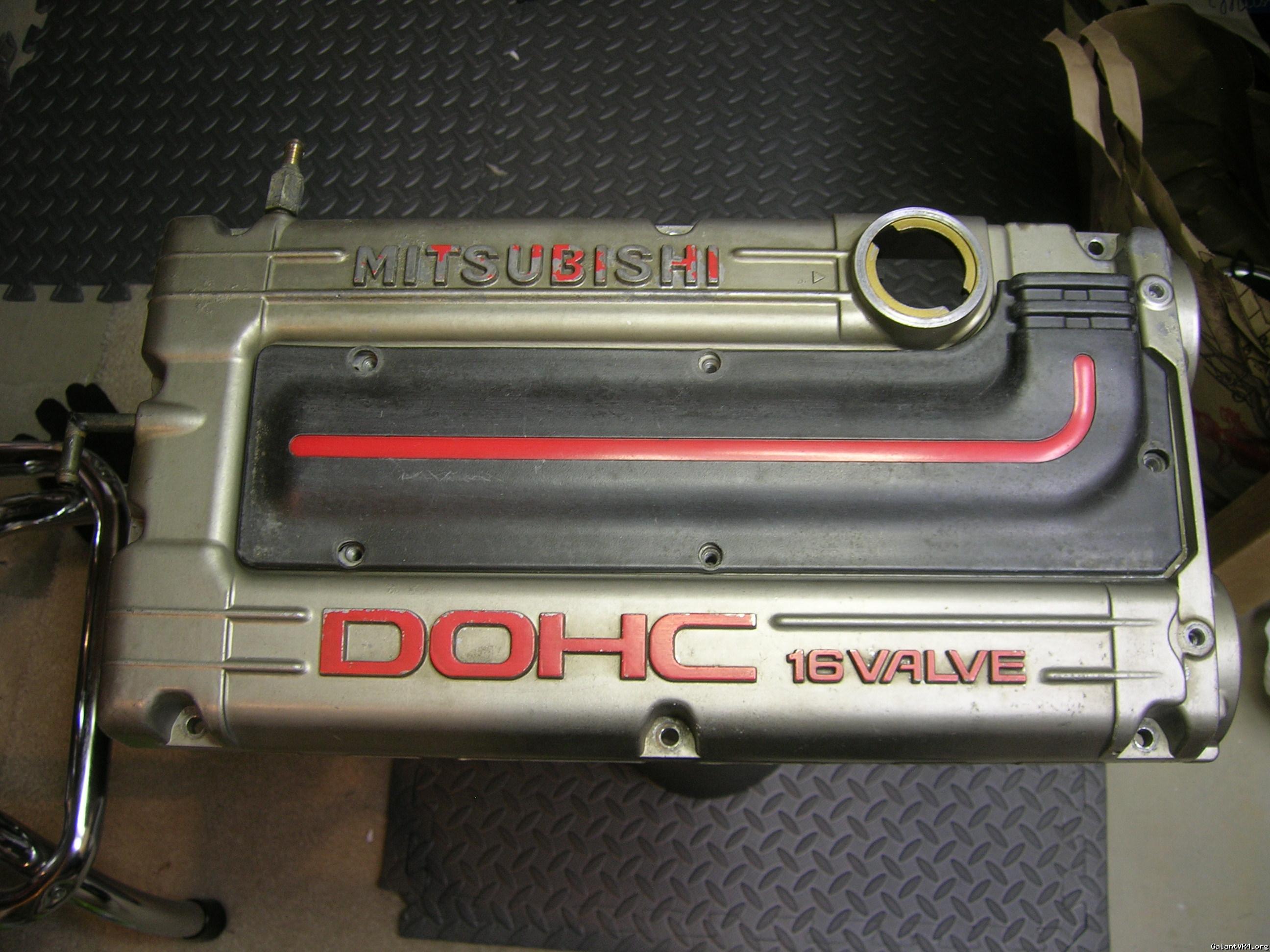

G
Feb 24, 2004
8,896
zompton
CSM vc.
