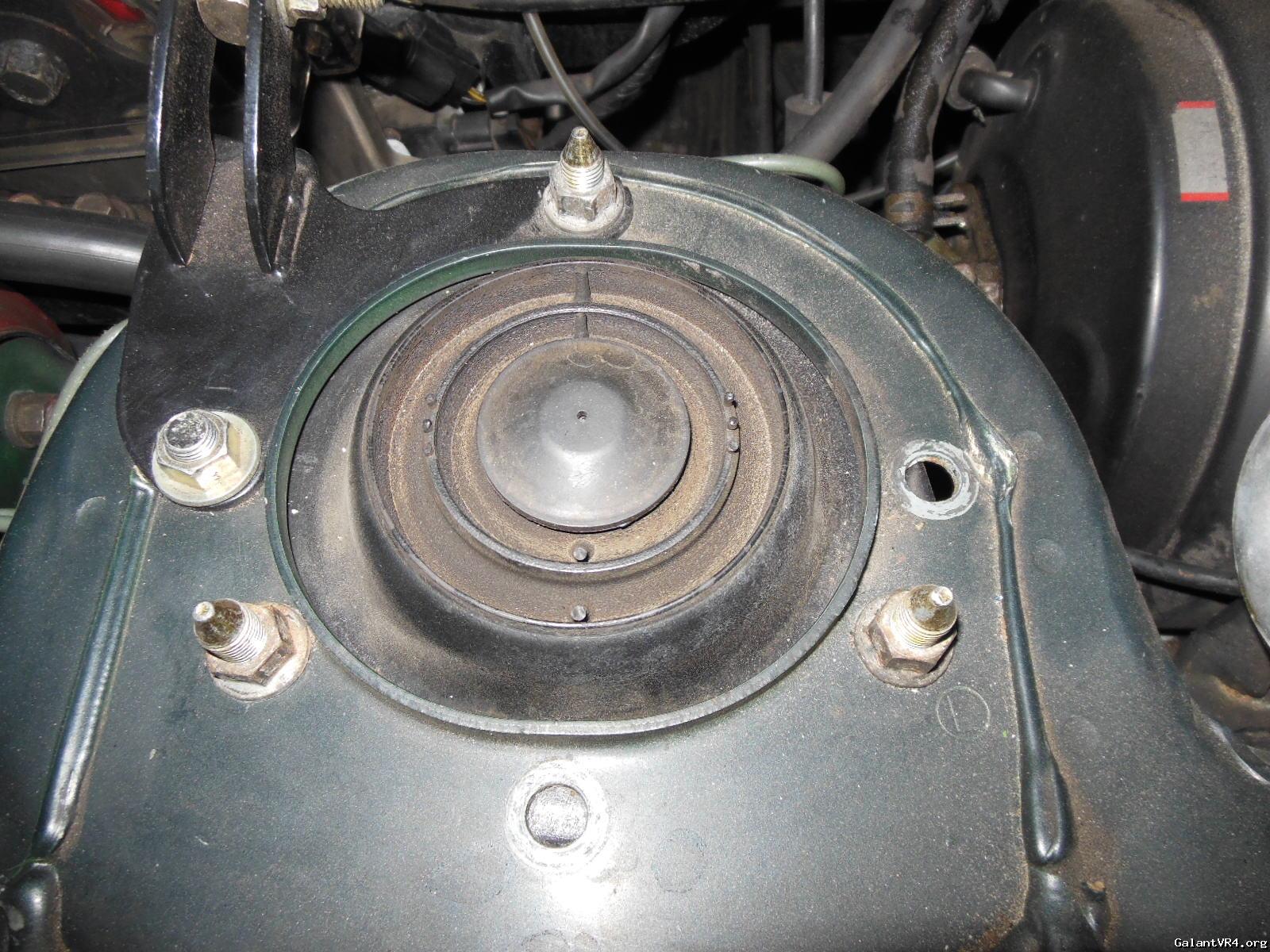

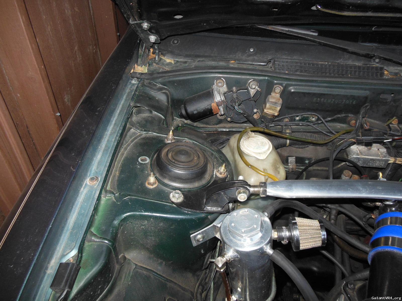

i have those and i didnt do anything to strut tops at all. i drilled two holes in each side for the fronts. the rears i had to cut off the stock bottom bushing and have them welded into the evo 9's bottoms. look at my build thread if you want to see how the car sits and if you need i can take pictures of the top hats up front tomorrow for you. also you need to get 8 2mm thick hardened washers and a 19mm drill bit and 4 new bolts. all the hardware up front needs to be changed out.

could you post of pictures of the work you had to do transparentdsm to make the strut assembly to work on the gvr4? I am wanting to do this mod

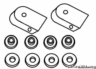

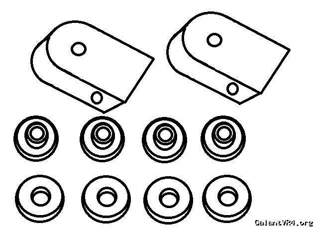

When I do a search in the past, I found a kit existing to install evo strut on our car without welding. But I can't found it again.
The kit contain inset for rear lower strut and shim for front strut.
The kit look like this: Sorry about my low paint skill /ubbthreads/images/graemlins/laugh.gif )
Is somebody know this kit. There are made for GVR4 & 3000GT to install Evo suspension.

I have those adapters on my gvr4, i got them from a forum member and they bolted right in
Alainb7
Mar 24, 2011
60
Montreal, Quebec, Canada
Thanks for the picture.
Quoting ade:
You use everithing in the kit?
Rear lower mount & front lower mount CNC-machined oval adapter washers?
Tell me if I'm wrong, but these front lower mount CNC-machined oval adapter washers are replacing the 2 1/16" shim, and fit in the 14mm strut mount hole and use 12mm bolt for knuckle hole mount,the oval shape is to adjust camber? I am right

Curious to how the rear just bolted right up if they are designed for the 3000GT/Stealth and everyone says that the bushing size is different?

For piece of mind, I would trust the brackets more plus you would not have to hack the Evo suspension for resale or reuse on another vehicle.

i only received the rear adapter and it bolted right on.
