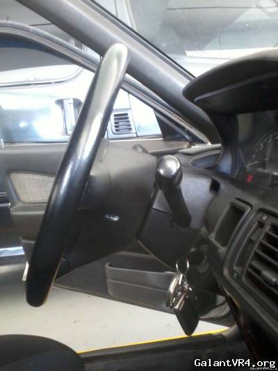

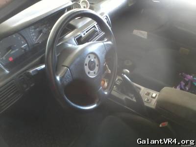

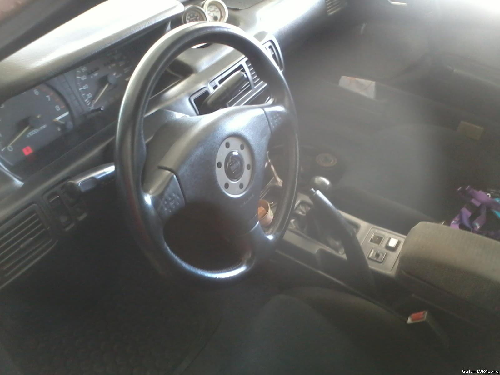

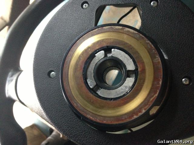

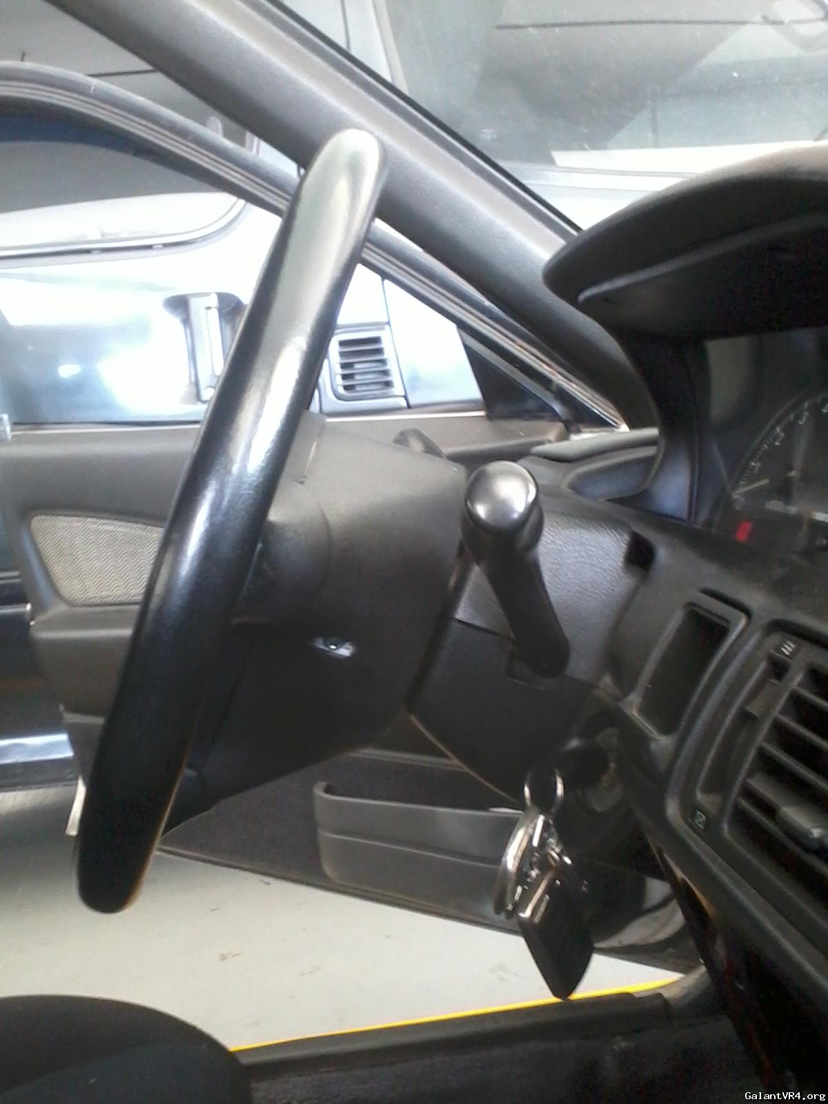

I managed to finally remove the Boss Kit Adapter which is PITA to remove unless you have a tool to remove it and installed an Evolution 456 steering wheel.
I need help in getting the horn to work though. /ubbthreads/images/graemlins/dunno.gif
Any advice? Thanks!

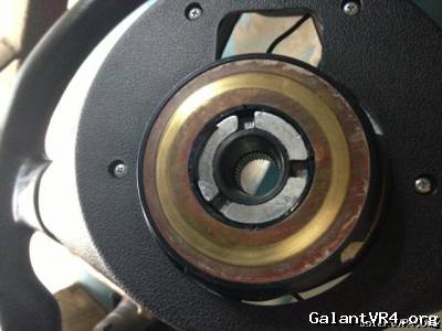

I placed the bottom part of the boss kit adapter. I think that for the contact, connected the wire tot h e horn button, but no go.
The hole in the horn contact is too big for the part where it should go, so it's kinda loose, unlike when it was on the boss kit adapter that has a snug fit or can't be moved around.

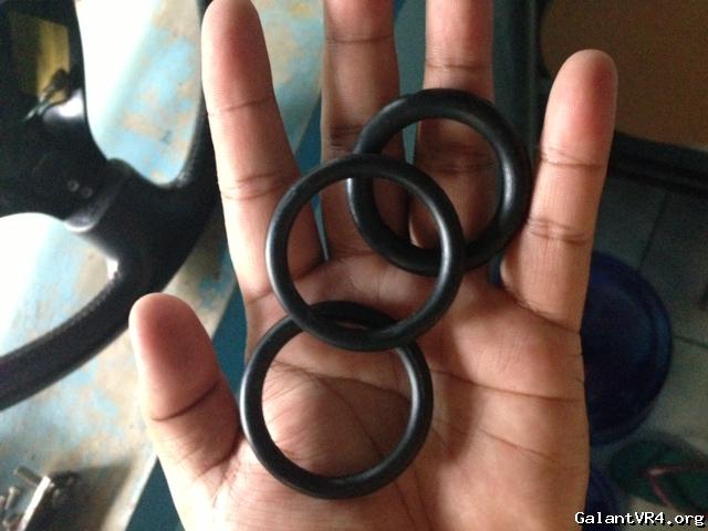

I got the horn to work, I used 3 o rings, and a piece of rubber to make sure it doesn't move around.

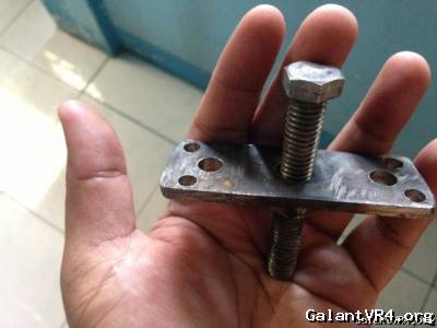

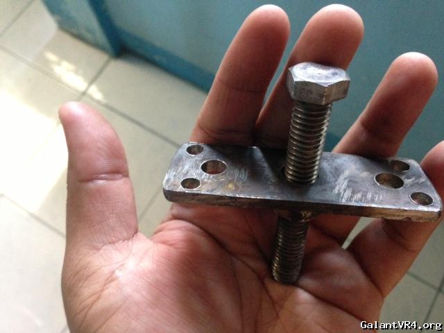

I also fabbed a steering wheel remover for the boss kit and OEM Evo steering wheel.
They are hard to find where I am from so made one instead.
