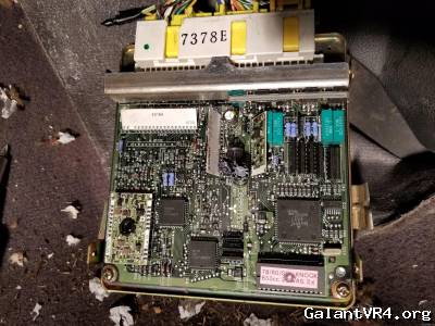

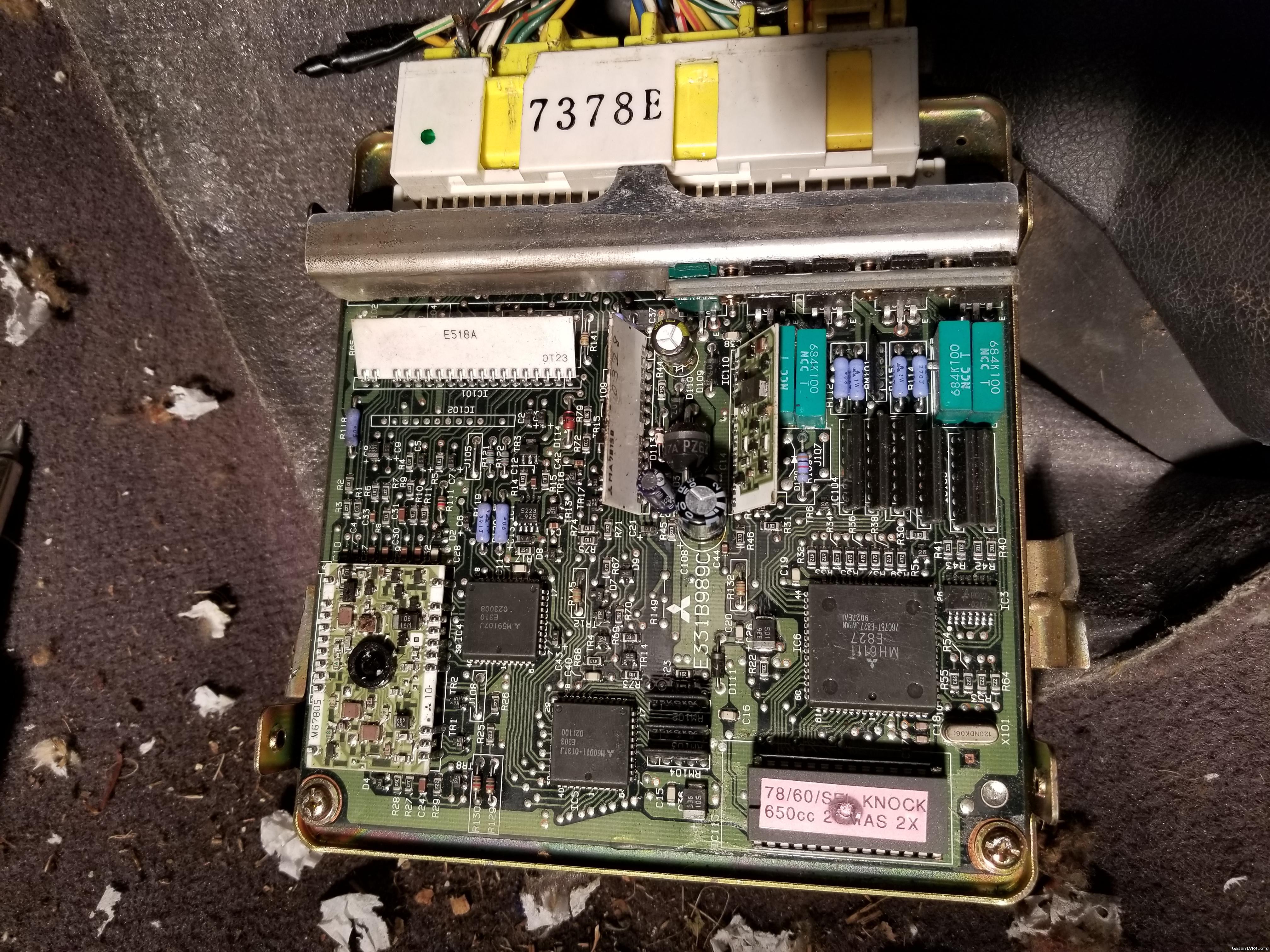

Hey guys, new to tuning and im going to order the ecm link but my eprom ecu is different from the other examples ive seen, mine has a completely different sticker on the Eprom. Wondering if yall know what it means. i am running maf translator right now, plan on doing SD

your chip states 2gMAF. But, if they changed you to a Gm-Maf with at translator, then you need to visually verify that in the engine compartment.
