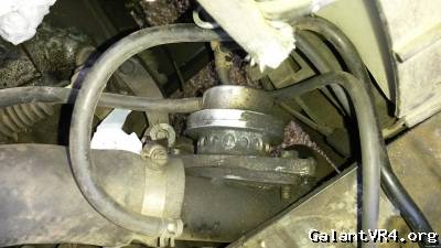

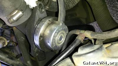

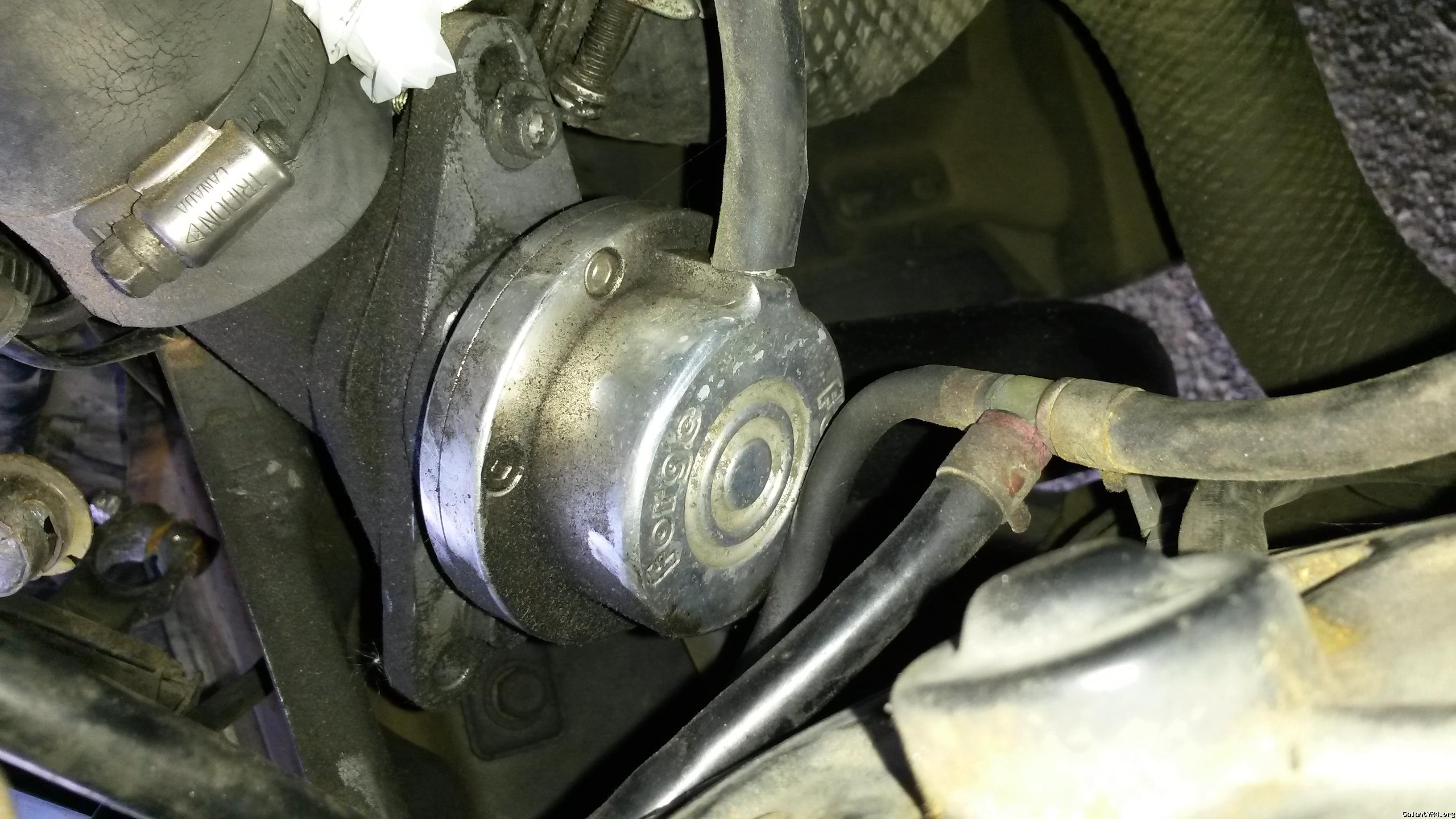

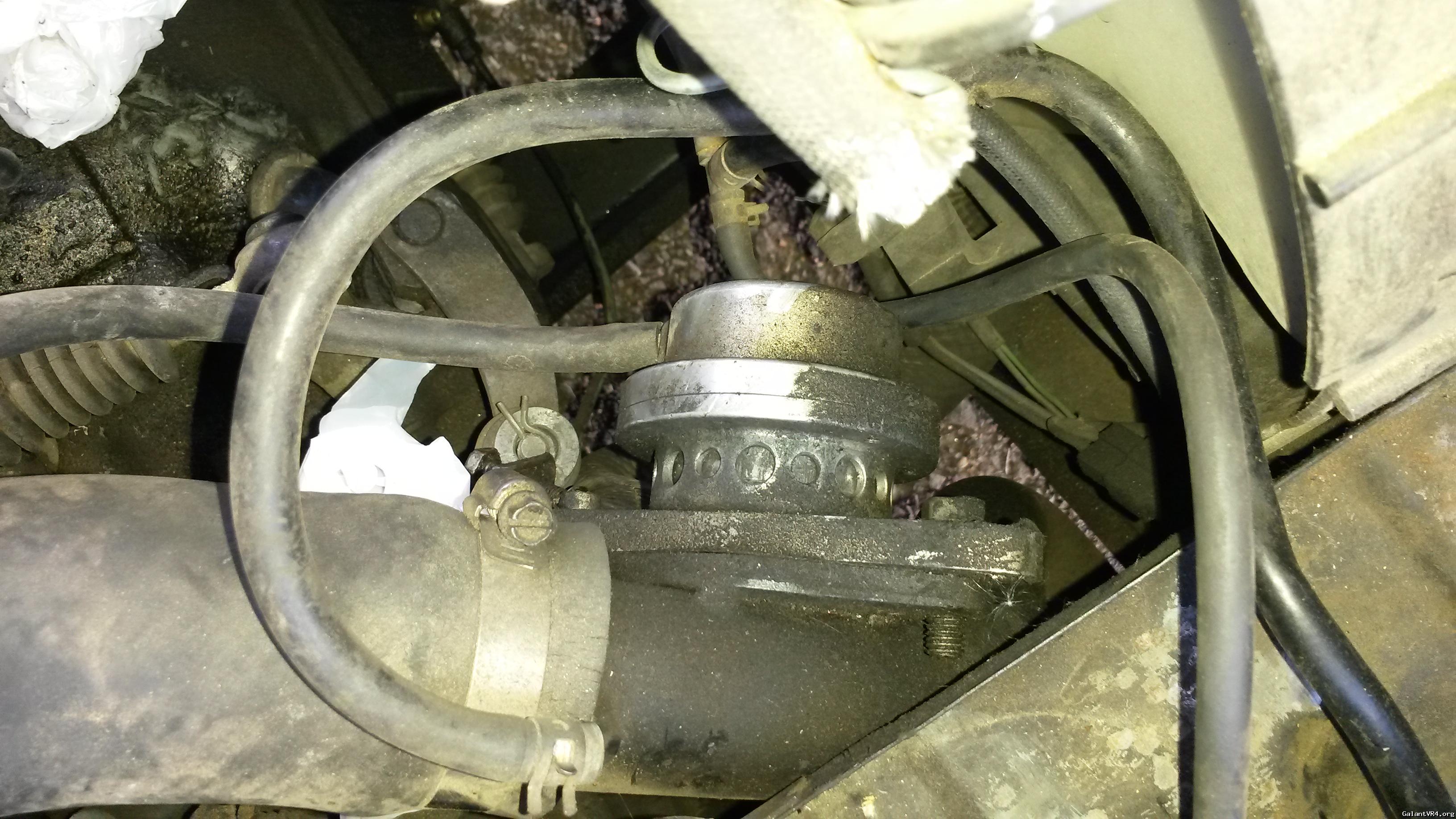

sry I was out of town for the weekend. What Turbowop said is what I feared was the case. Considering i do not plan to run speed density just yet, what part is missing? I doubt that the BOV installed is stock.
for the vacuum line, sounds like I should just size up a new one and reattach it?
I will post more detailed pics a little later today

So that's an aftermarket BOV on the stock flange. I don't see how a gasket could properly seal that. I would just find a stock one and stock recirculation hose

Nevermind, I blew up the picture and realized there is no way to recirculate that Forge BOV. Reminds me a bit of the Worx DS2, just that the DS2 has and outlet that let you adjust how much you wanted to vent and and recirculate.
