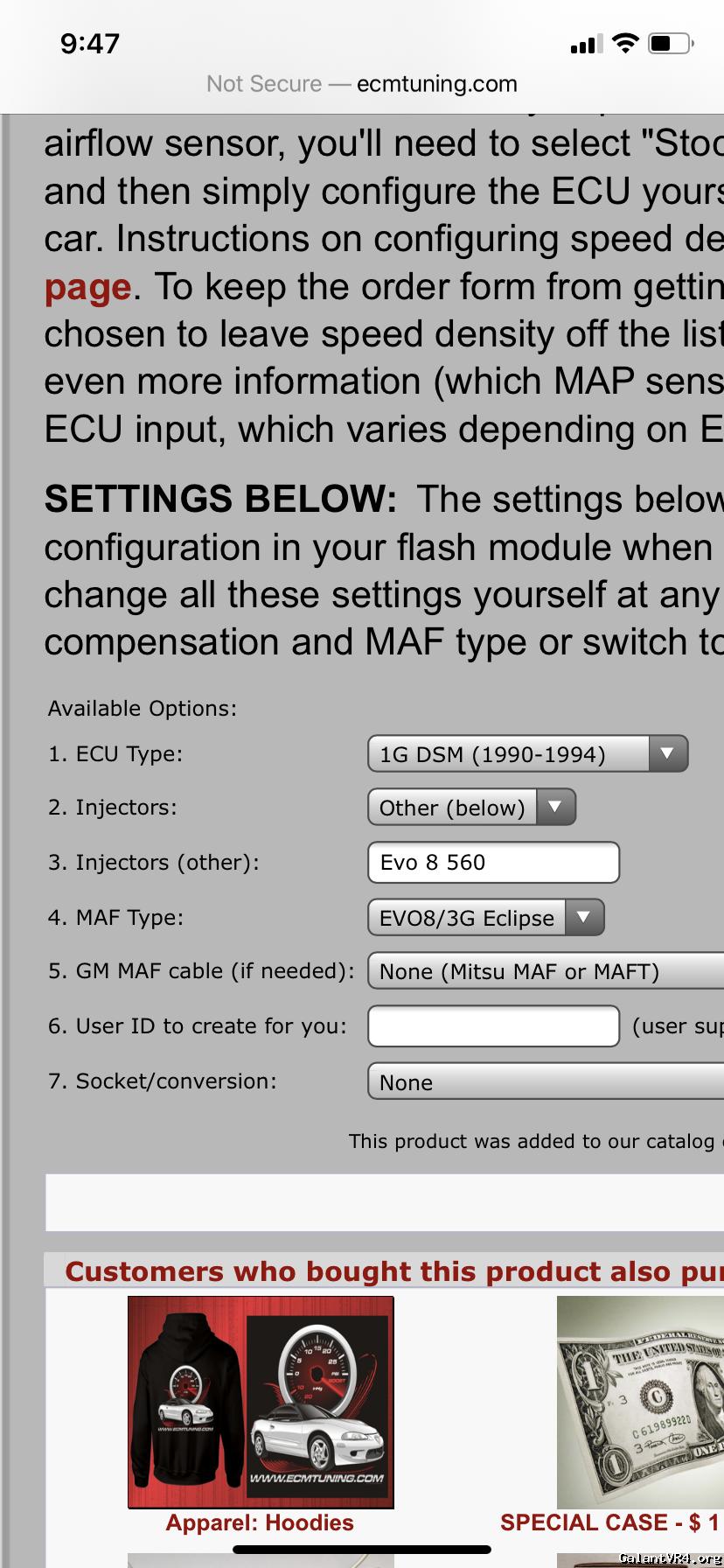

So I’m looking to switch from the key chip to the ecm link.

Here is what I selected on my Ecm link but feel like I may be off or I should add things that could be better for later on when I want to add more power.

That's the right website and those selections look correct to me besides the maf. You said you have the 2G MAF but have the 3G selected. This is a good website to glance over (http://www.ecmtuning.com/wiki/start), and make sure your ECU is eprom before you send it in, I don't think they can do non-eprom conversions right now.

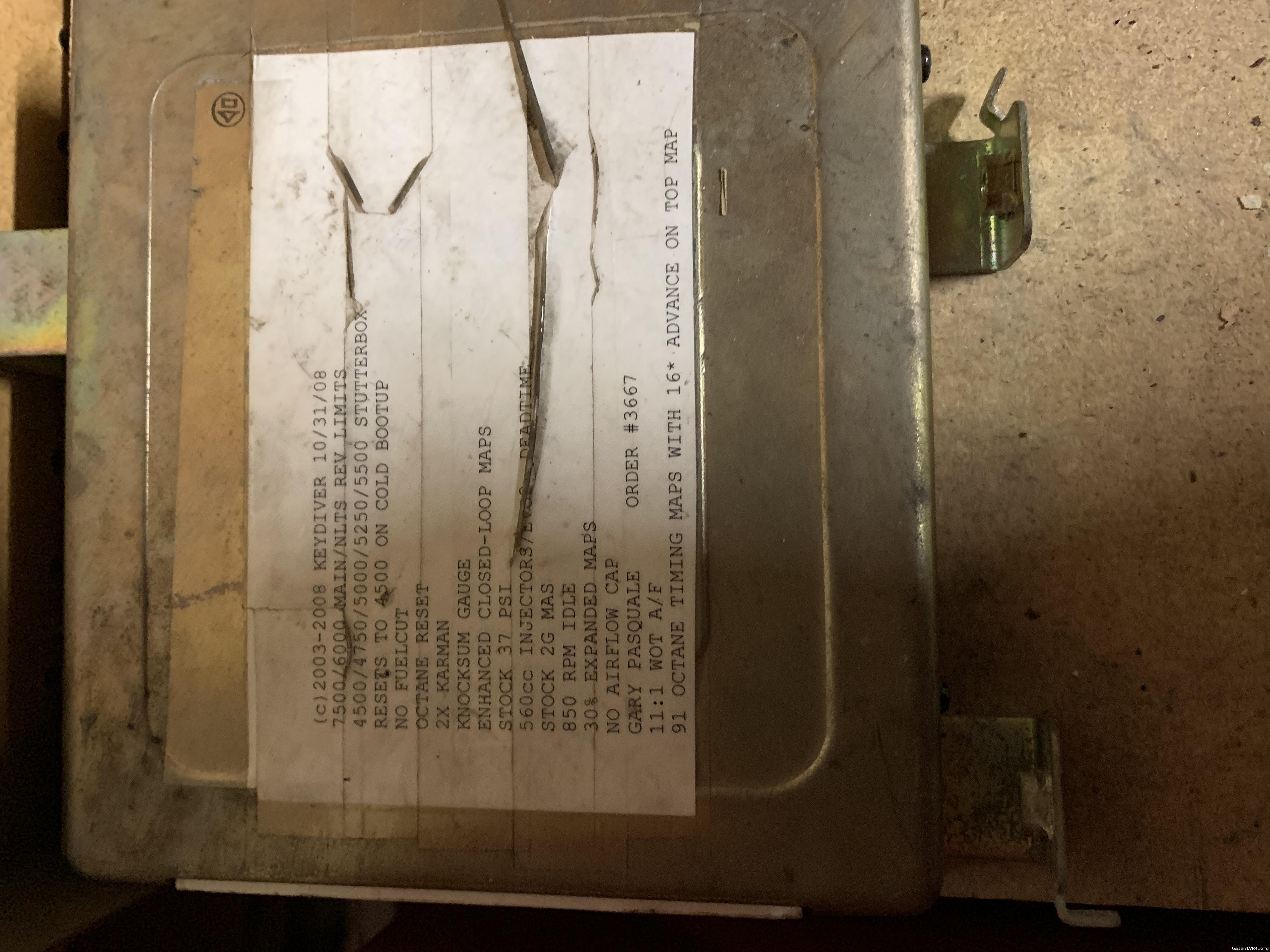

You have a keydiver chip already installed so the ECU is a eprom and it is already socketed. So those are two big pluses. I would email ecmtuning, tell them everything you have done to the car, send them your ecu to examine it and make sure the ECU is 100%, then have them install and base tune the chip so you can install it, fire the car up and take it to a real tuner who can finalize everything for you.

You also need to replace your ecu case for a proper Galant case. The case needs to be properly mounted in it's spot and it also need to be properly grounded.
Edit: is there a specific reason your switching over to dsmlink? You upgrading parts? Looking for more power or are you trying to resolve an issue you think is being caused by the ECU?
to be fair (regarding the mounting) the grounding strap can be bolted in with the DSM case dangling. I put at least 500 miles at a pretty stout power level with it dangling in the footwell, and yelling at passengers not to kick it). /ubbthreads/images/graemlins/dunno.gif/ubbthreads/images/graemlins/rofl.gif That said, when I finally got the galant case, it was so much nicer /ubbthreads/images/graemlins/idea.gif

I've noticed slight differences during cold starts and it seems to idle a bit smoother, at least in my situation, with the ECU mounted and grounded. When it was dangling on the floor it would take a few more cranks to turn on and it would hunt a bit, once I bolted it in place things changed.
