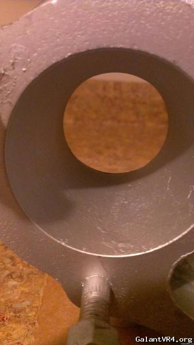

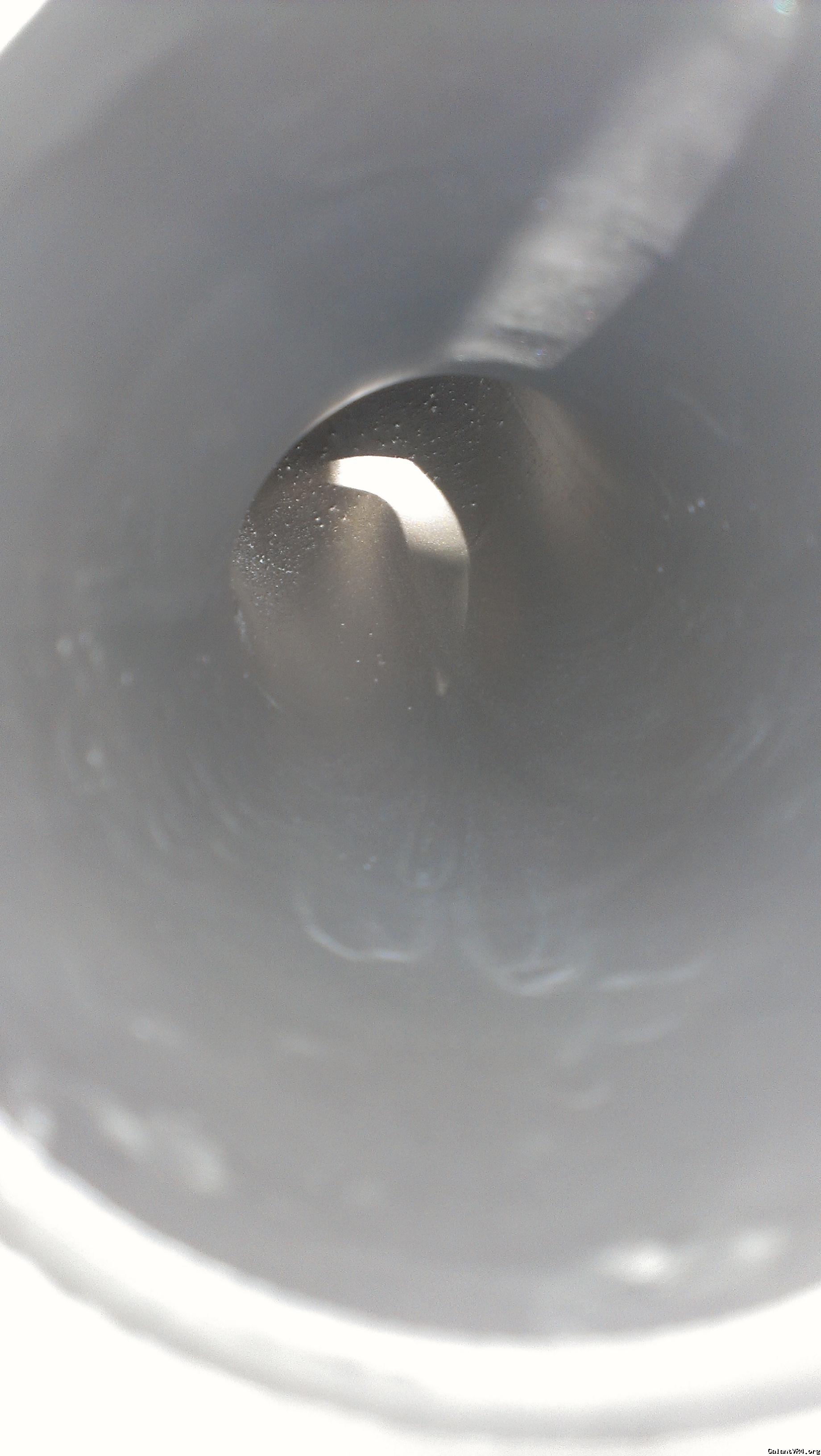

Reply: Well, Its a new product in there catalog.

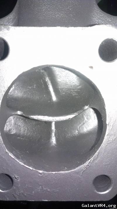

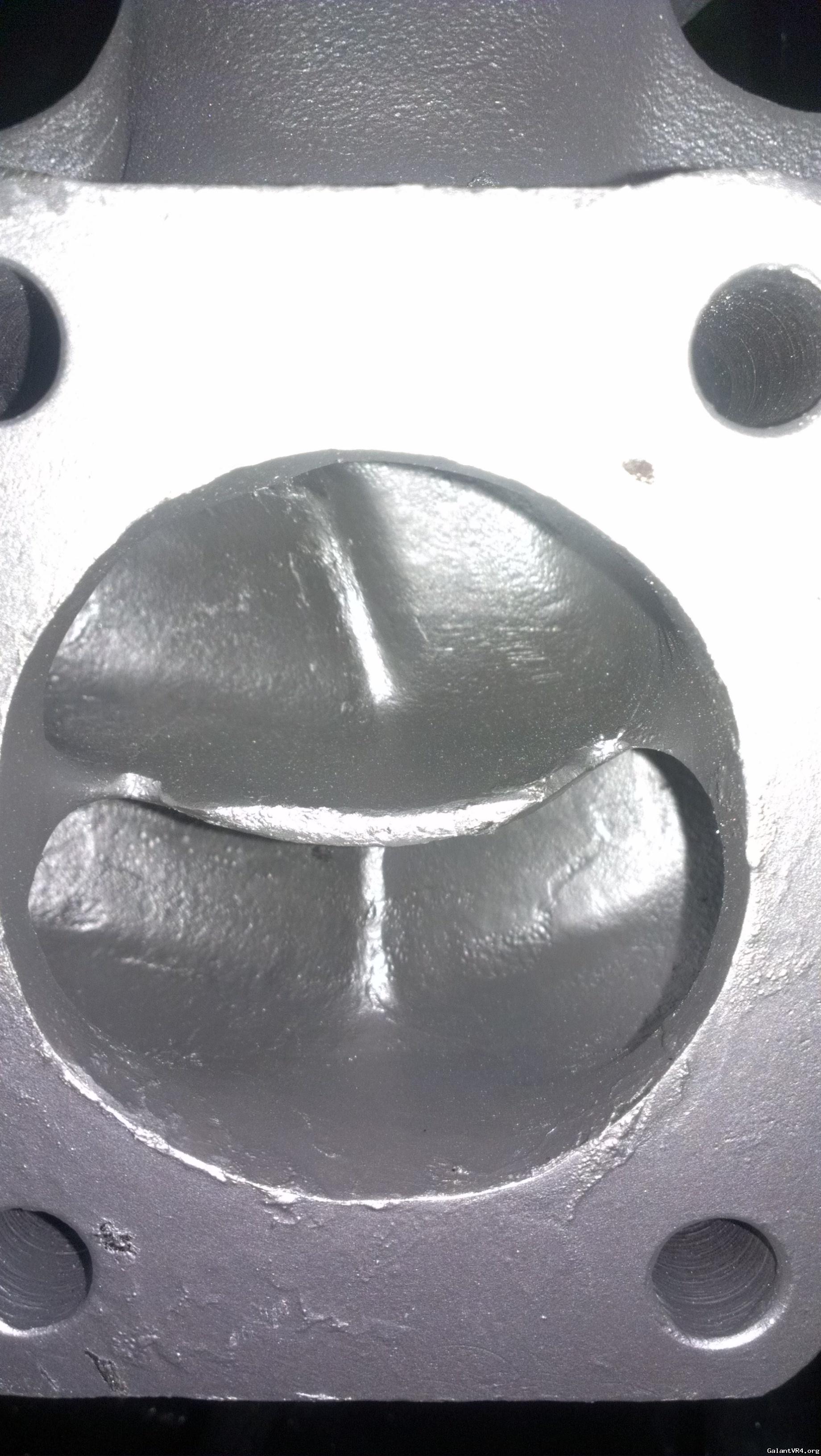

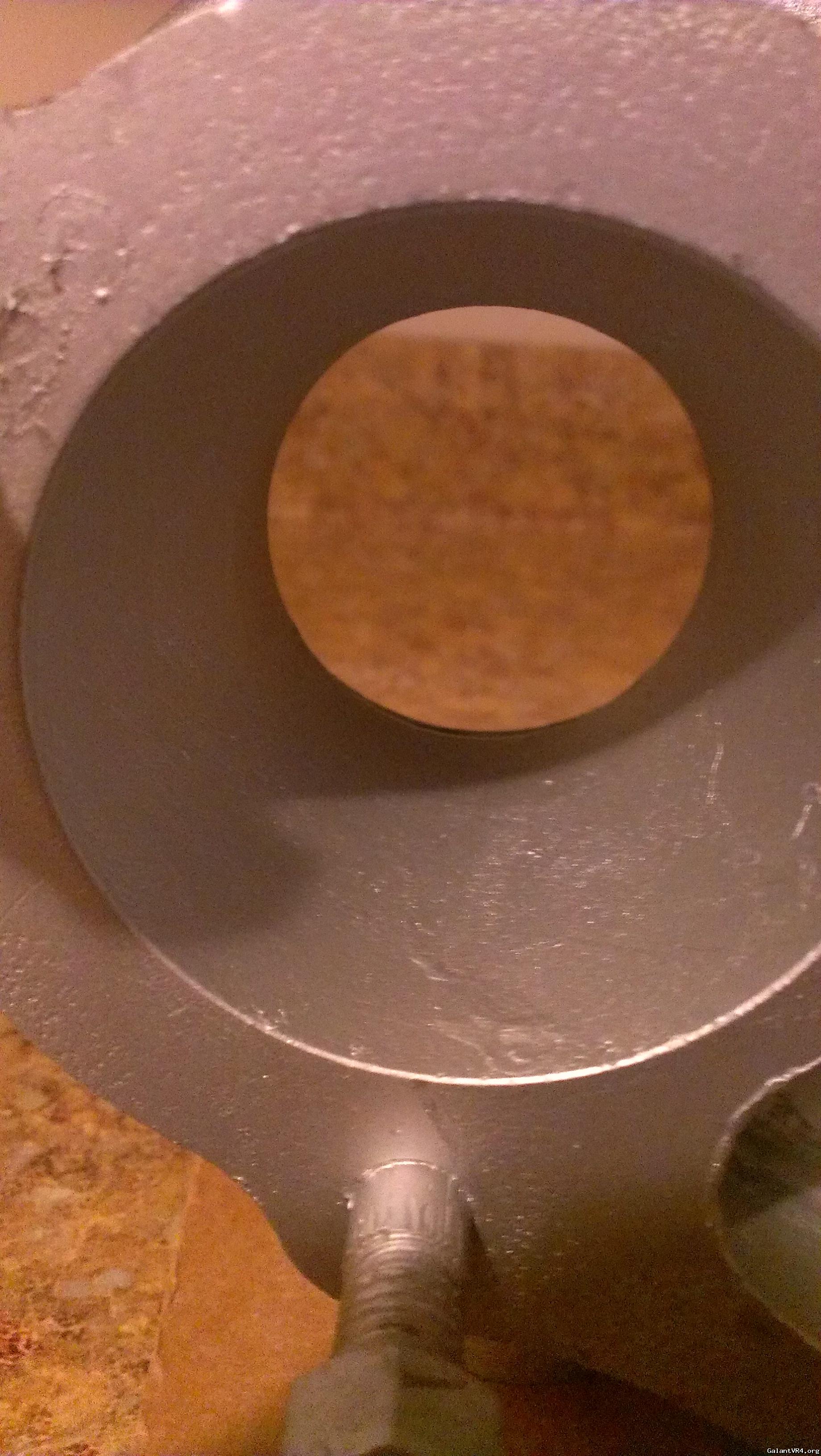

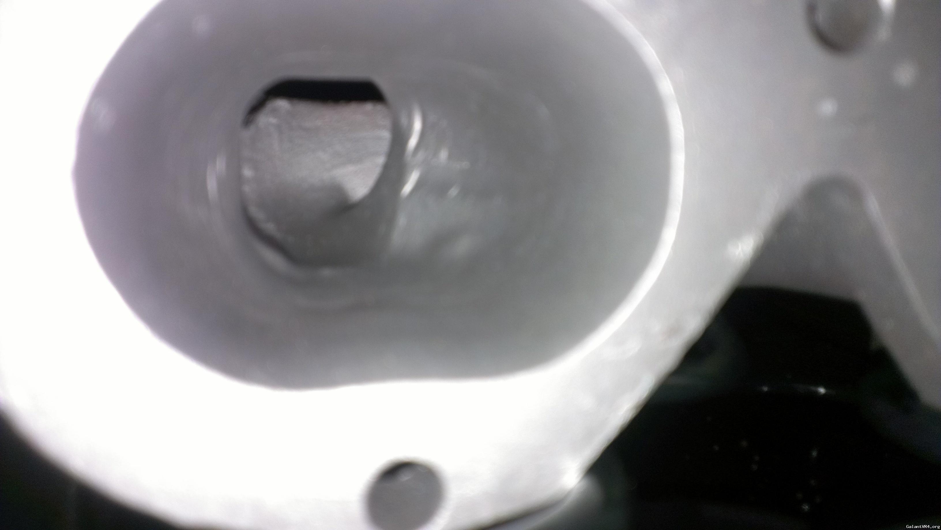

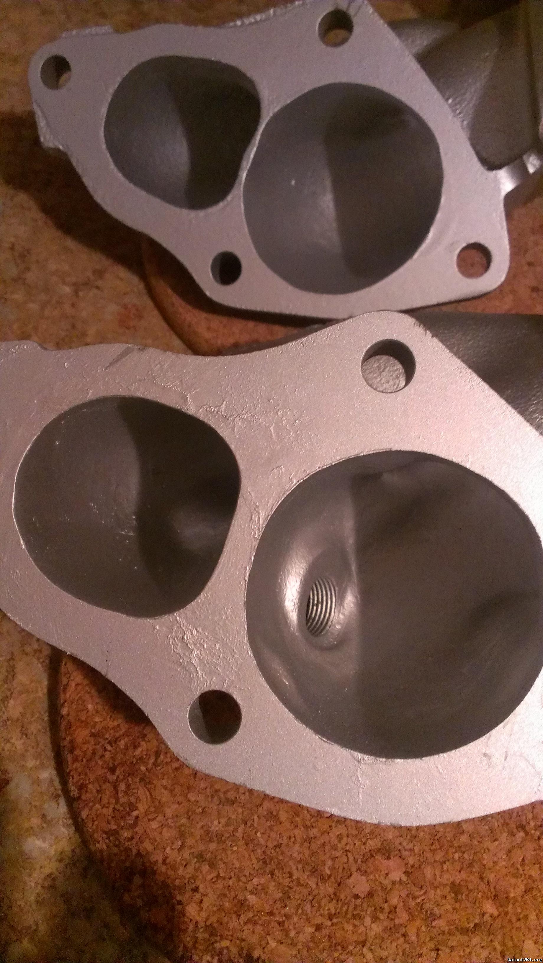

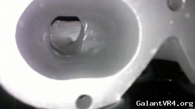

edited after heating in oven and reassessing:
Ported, Sand blasted, and coated (inside and out).
Downpipe
manifold
exhaust runner
O2
turbo
I got to admit, It looks like it's going to burn right off in some spots. So much came out of the tube that it pooled with very minimal application. If I was doing it again I would go very very lightly with the tube applicator in only the deepest part of the pipes, after spraying as much as I could with the regular spray tip. After being in my oven to bake at 350° for 15 min. it's hard and smooth to the touch. As of right now it looks like I'll be wire wheeling it off the turbo housing where the turbo goes in. There are a lot of drips, and its very uneven. I'll leave it on the manifold and 02 housing to see what happens. It seems like it will be better than having no coating, especially after seeing how fast everything rusted after sand blasting.

EMX5636
Jun 28, 2008
1,631
Bucks County, PA
Run it for a few hundred miles (with full load pulls) and take a pic inside and see if it's still there. It seems like a standard ceramic coating in a can. Hope it works out for you, but I'm not holding my breath. Either way, it looks nice, and might help keep some of the rust down on the outside.
