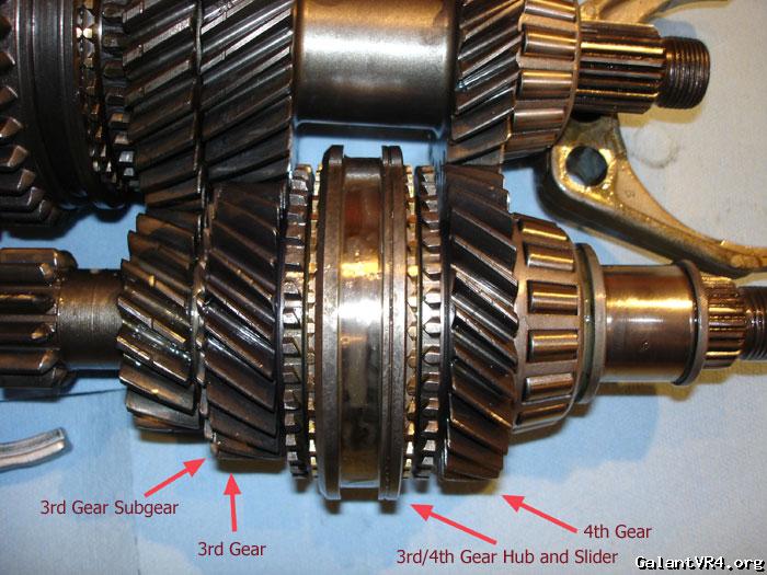

Do you have 4th gear?
If not then you have more than likely broken the 3rd/4th hub.
Most of the time you won't even see the problem till you actually press the gears off the input shaft.
The switchable trans has a pretty bad name for breaking that hub.
A new hub from a regular VR4 gearbox fits right in with no problem.
The actual hub is hidden from view in the pic below. It's under the slider that you can see.
Of course you may have also stripped the teeth from 3rd gear but you would have heard all sorts horrible sounds if that had happened!
