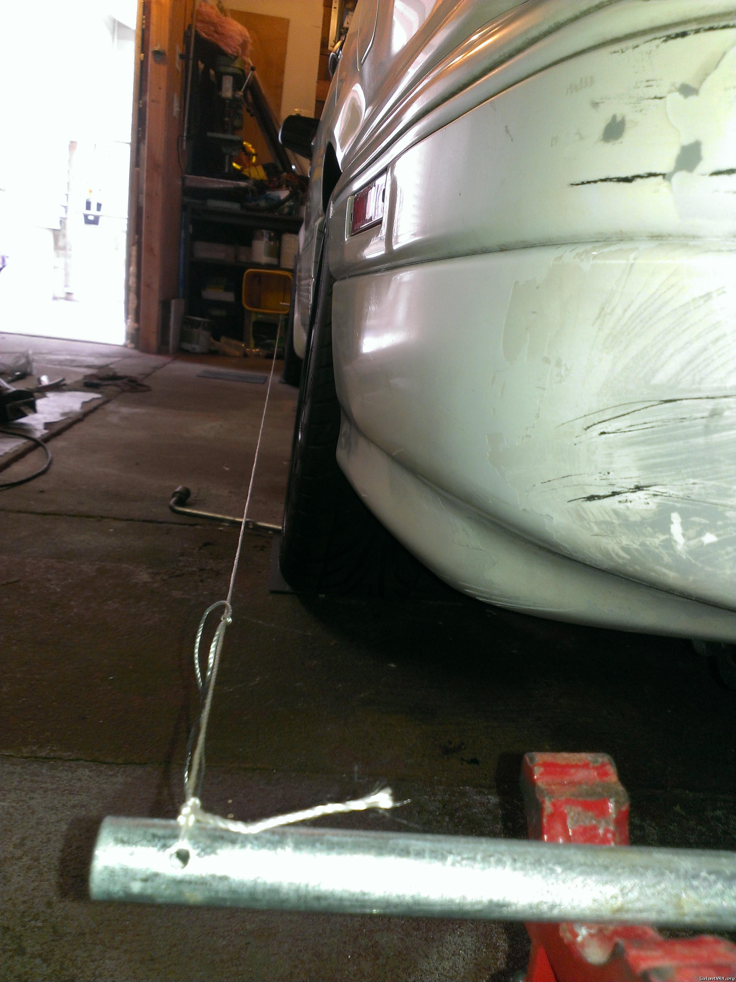

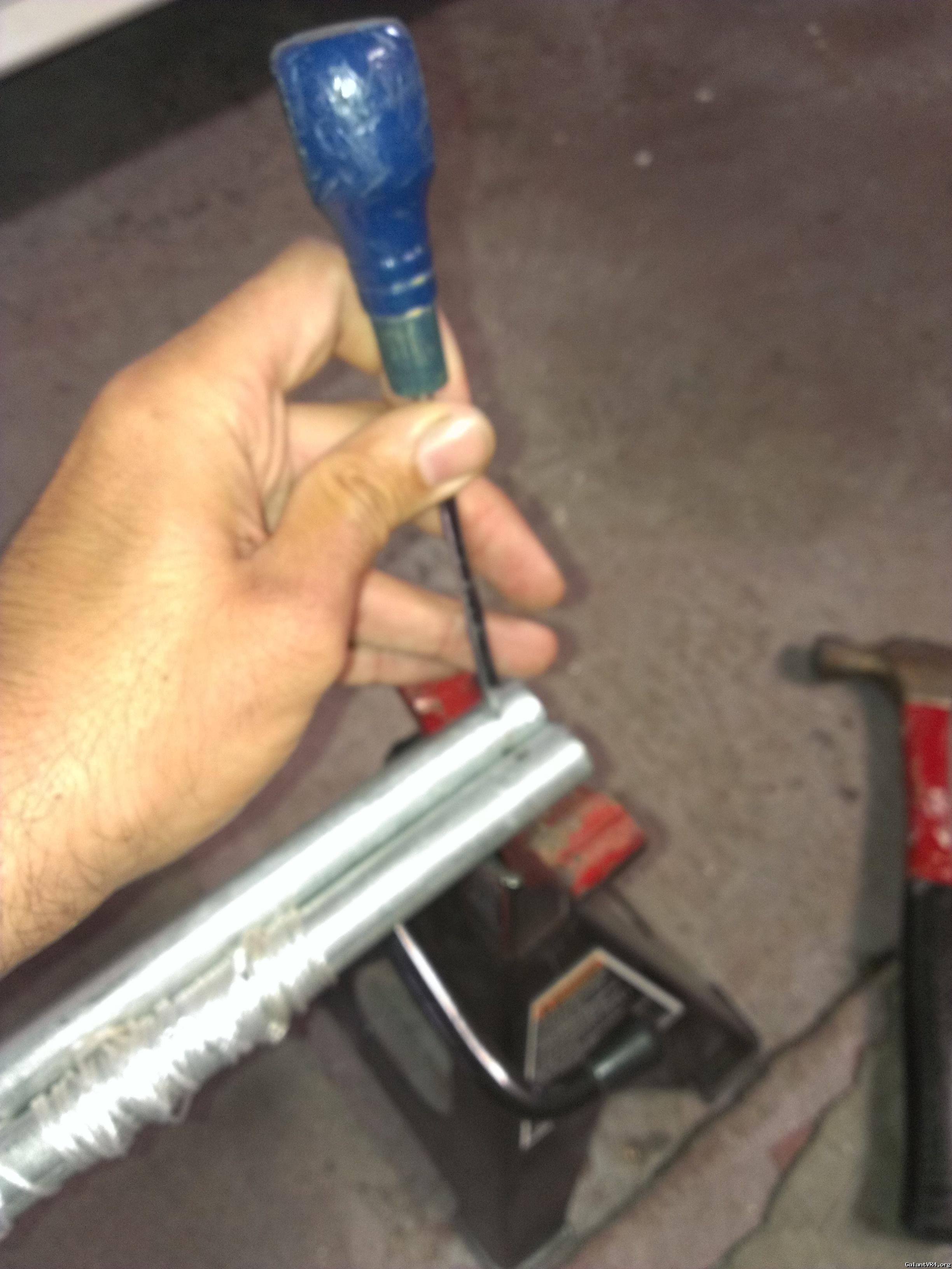

So I rushed through making the tools again and the came out less than perfect, however the idea here remains the same. The goal is to make two identical rods with holes at either end to place equal lengths of string or fishing line. The more exact you make it the easier it is to set up each time you do the alignment. My rear toe was significantly off and I was getting a difference of 2mm measuring hub to hub on the drivers side. At the time I thought it was the tools being sub-par but it turns out that the alignment was just that far off. (probably a combination of the two) I aligned the string to the hubs best I could then I set the front toe. I took a quick look at the back and couldn't really make seance of it. I made an apointment for the rack at a local shop. We ended up having to remove my lower control arm and trailing arm and adjust the heim joint because the toe adjuster bolt wasn't within spec. I had to turn the heim joint out 5 turns until the center of the bolt and the mount holes measured 4.77". It was a job much easier done on a lift with a laser alignment machine measuring while I work.
Conclusion: If you just want to check and tweak your alignment after changing out struts this idea will work accurately without much trouble. With my unacuret set up procedure (aligning the string to the center caps of the rims, I have the ones with the 3-d triple Diamond emblems )the front toe was 0.0L and 0.05R. That's a decent result $10 worth of tool supply. Preliminary measuring between hubs with a tape measure may have exposed my bigger problems in the rear and allowed me to tackle those issues however it was frustrating enough to get it right on the alignment rack , so it just wouldn't have been worth the trouble for the issues I was up against in this particular situation.
