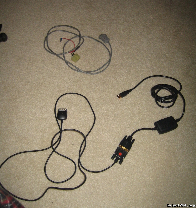

Heres what I use.
Top cable plugs into diagnostic port next to clutch pedal and then connects to bottom left cable which is plugged into logger for logging while you drive.
Bottom left cable also plugs into bottom right cable which then plugs into port on your computer so you can transfer data to pc.
Bottom right cable purchased at radio shack or other electronics store.

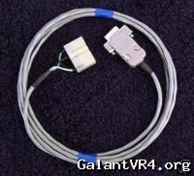

Quoting mountaineerjeff:
this? if so wouldnt I need the 'laptop cable' not the 'pda cable'? the laptop cable would have a male end and the sync cable is female
