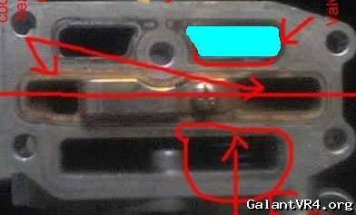

The TB has two systems for controlling the idle. The ISC is computer controlled whereas the FIAV is passive and works based on coolant temperature. If you just bypass the coolant lines then the FIAV stays in "cold" mode and the idle will never drop. To do it properly you need to block the airflow through the FIAV so that it is completely disabled. The ISC will then take total control of idle conditions. This is still a very functional arrangement as the ISC is perfectly capable of handling cold-start conditions and keeping the rpms up when appropriate. The simplest way to deal with this is to get an FIAV block-off plate that leaves the ISC functional. You can also build one yourself if you'd like. The basic function is that they share a common air source which is split into two to run to the two systems. You need a plate which blocks the FIAV outlet but leaves the inlet and the ISC outlet unrestricted. Then you can remove the bead/spring from the lower half of the tb, bypass the coolant lines, and reassemble.

I don't think this is right. Its not the coolant part that you need to block with JB Weld. Its the section of the FAIV that allows air to bypass the throttle plates. I believe its the section I colored in blue:
The section to the left you want to leave open, so the ISC can still function.
