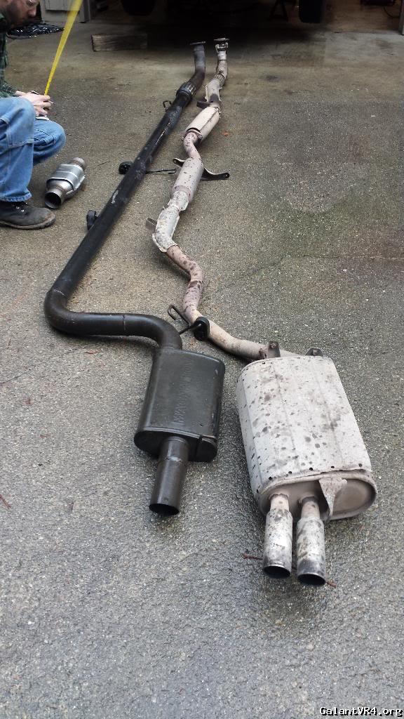

Cm performance downpipe, 3" cat, 1g catback modified to extend xx inches to cat=full exhaust?? Its a hks hi power. I raised the car and it looks like everything lines up.

That is pretty much how I fit a 1g turboback to my car. Didn't have to modify any hangers, just lengthened it about 9 inches. Worked out perfect because I welded in a high flow cat. I had to do some other modifications, rotated some of the pipe for a bit better fitment
coyotes
Nov 15, 2013
1,544
Seattle, WA
your results may vary, I had to rotate the muffler a little bit on the elbow pipe going into it, and also rotated the downpipe to make things fit better. Was worth the work, my exhaust is very straight compared to some others I have seen out there. I need to take it back off though to make it two pieces (it's all one long pipe) and put in a new flex section.
It's not too bad at all, but takes a day to figure out fitment and weld everything. I also painted mine black after all was said and done.

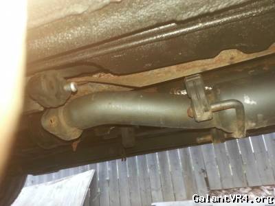

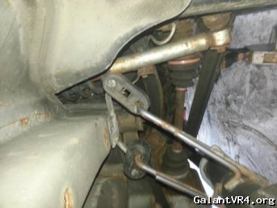

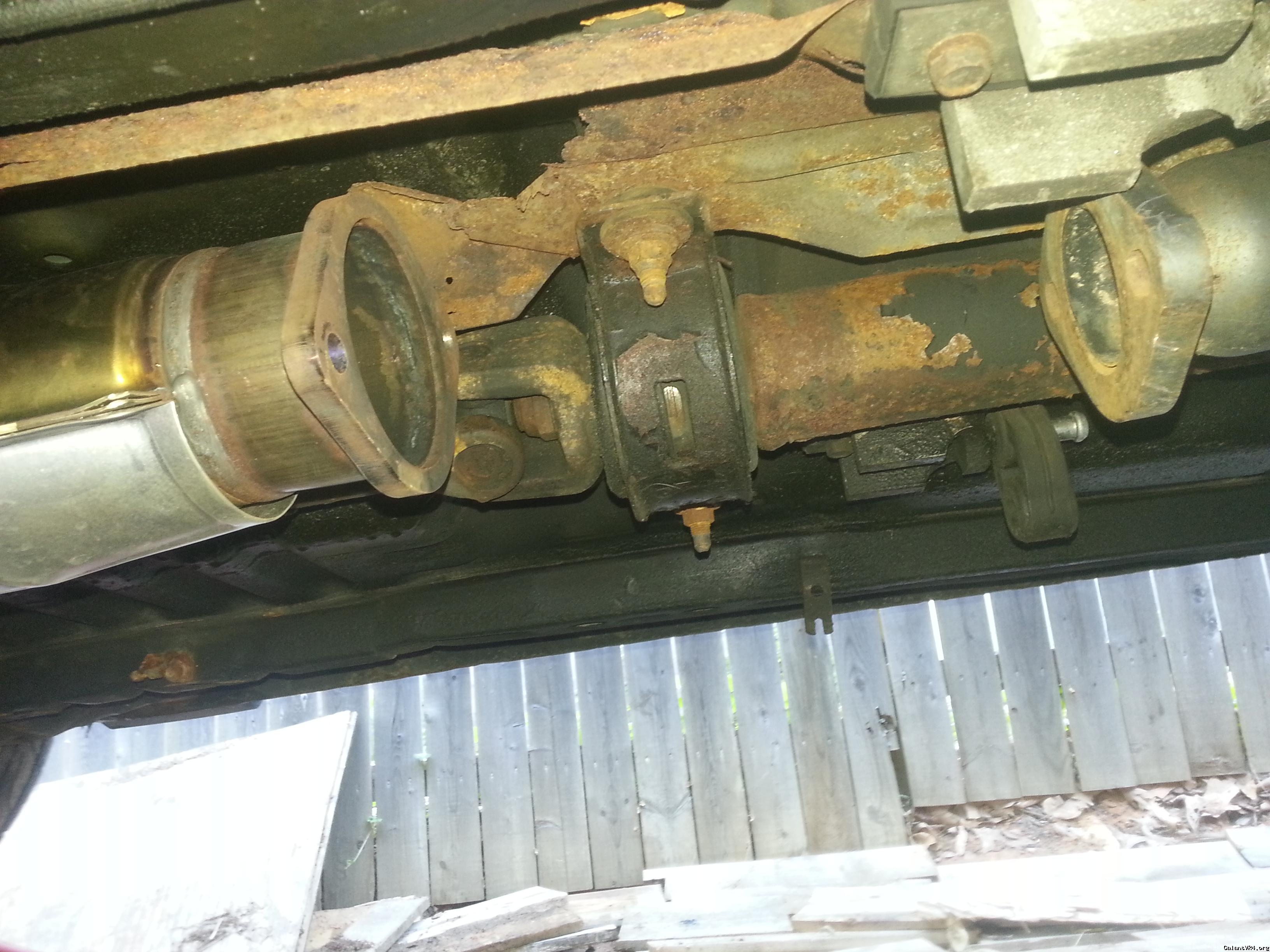

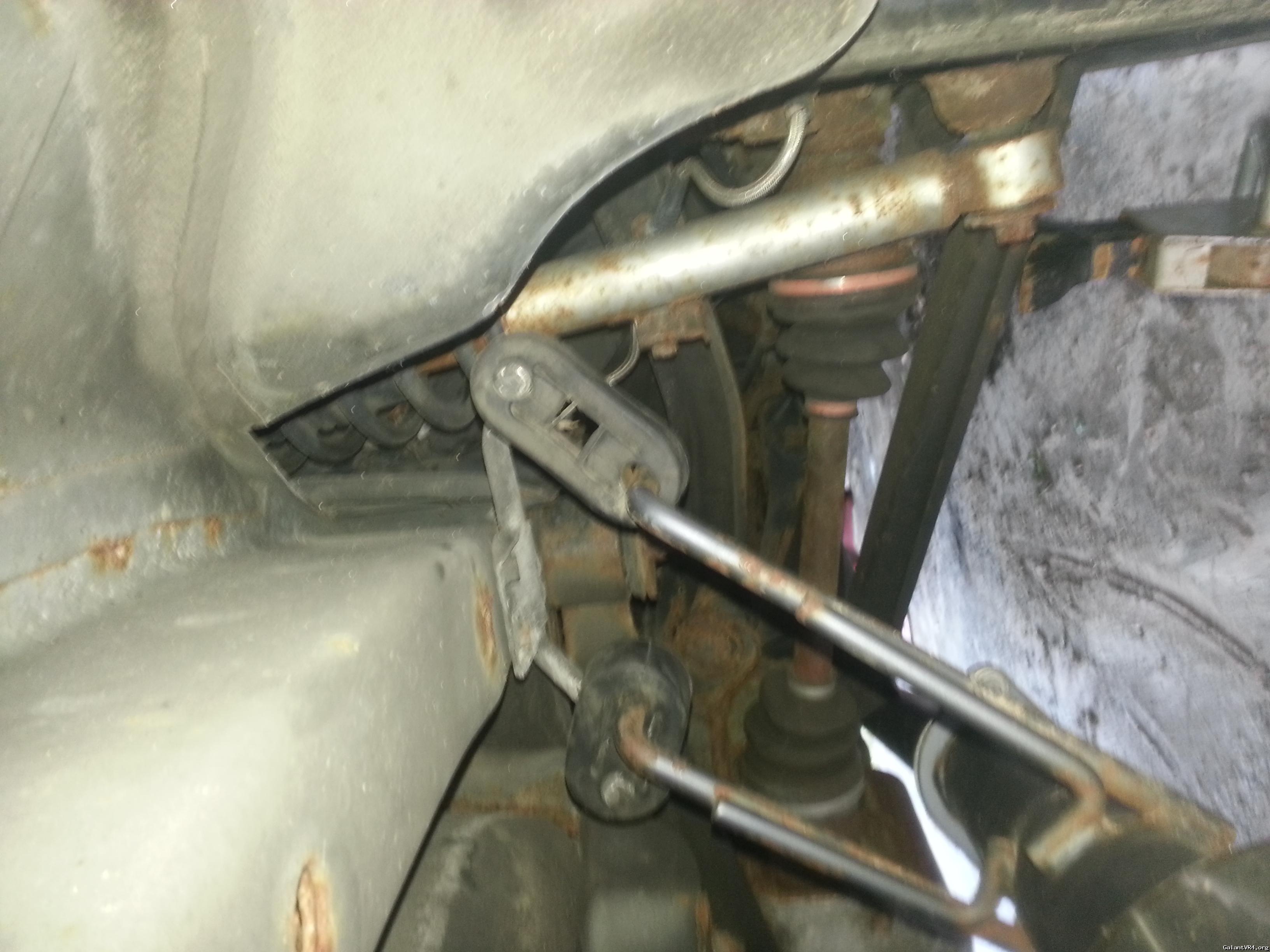

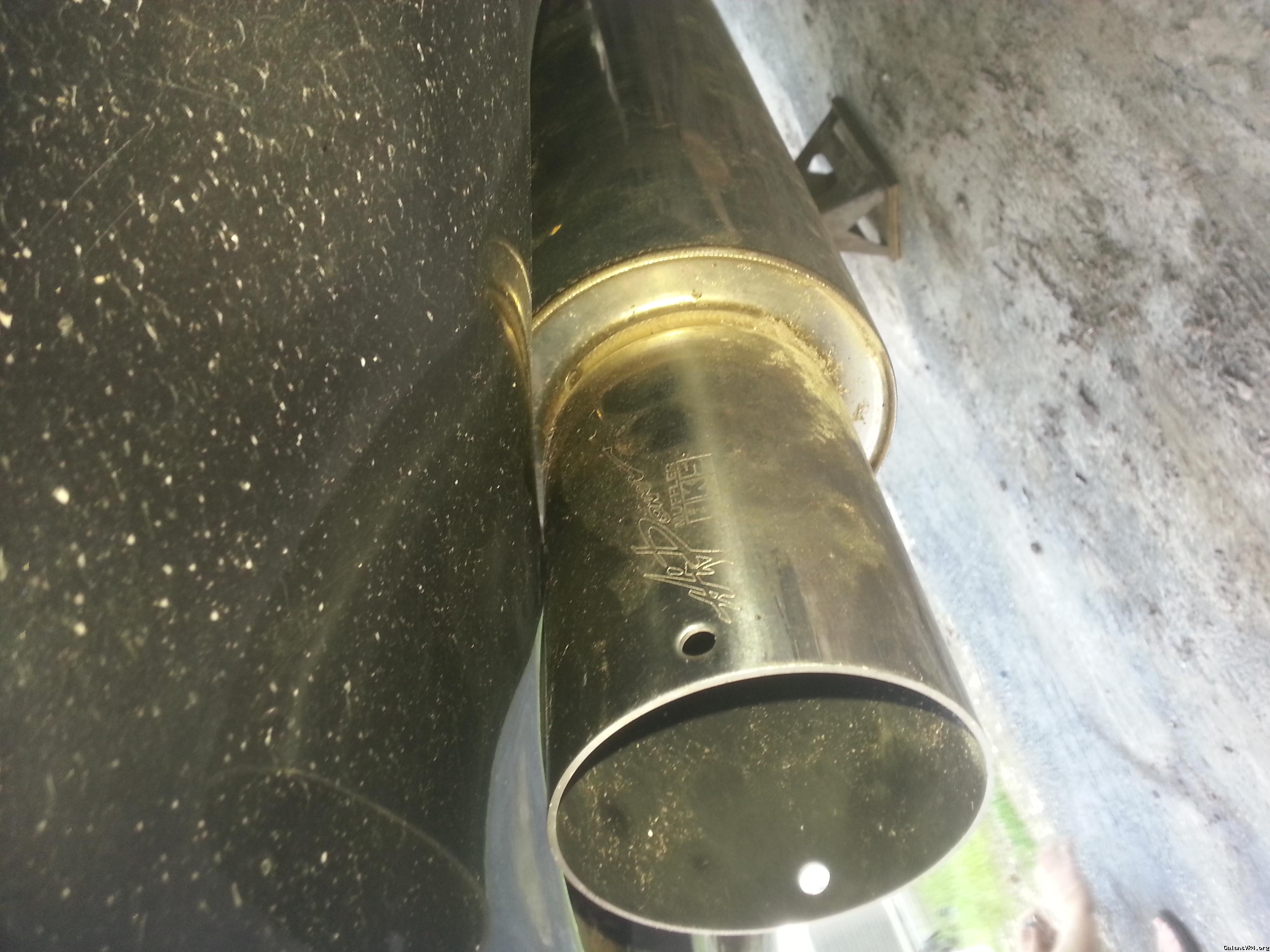

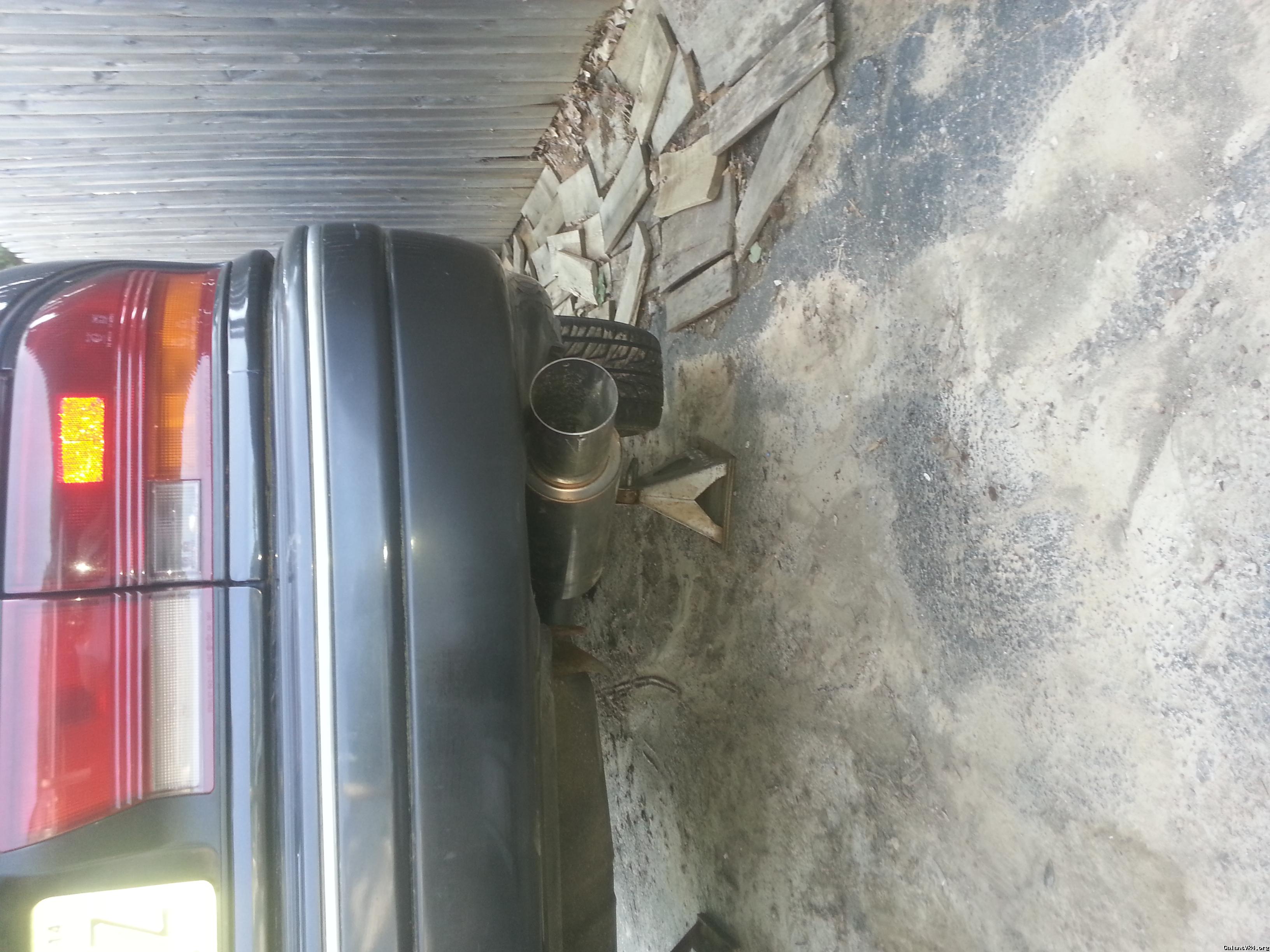

Im gonna have to take some pics whenever its not raining and I have more day light. On the ground under the car the catback seemed to line up perfect aside from needing to be lengthened. I just tried to work my way back to front and was only able to get the mufler hanger and one of the dual hangers behind the muffler on. Then further up the dual hanger right after the cat doesnt reach both by lenth to it and the spread. Idk maybe its hitting something. Insomia sucks when you dont have a garage or good lighting at 9pm lol.
Kibby
Jan 16, 2013
217
Baltimore,MD

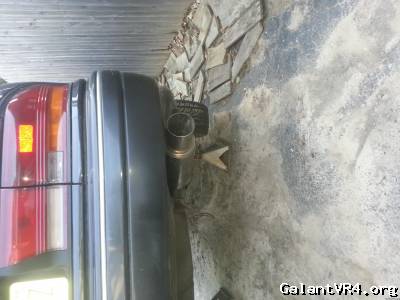

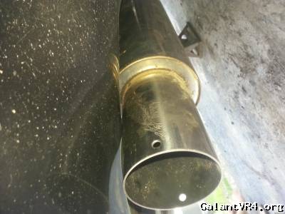

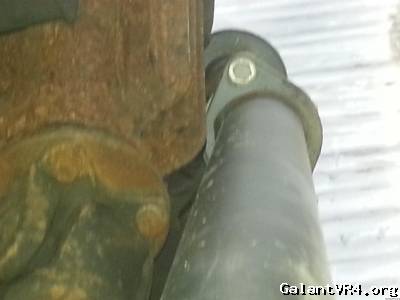

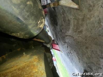

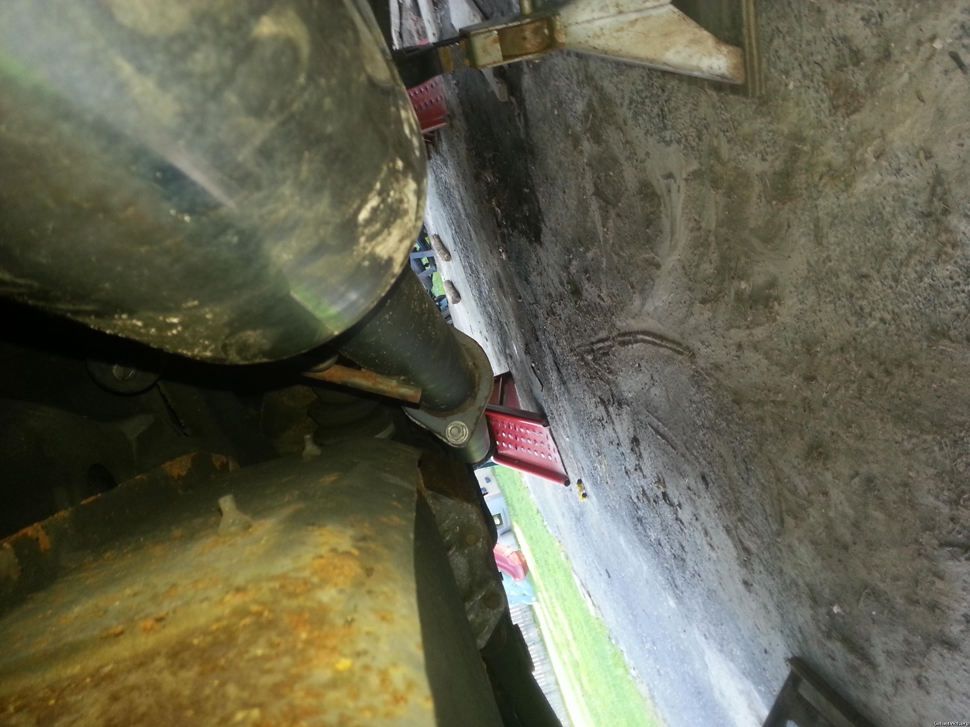

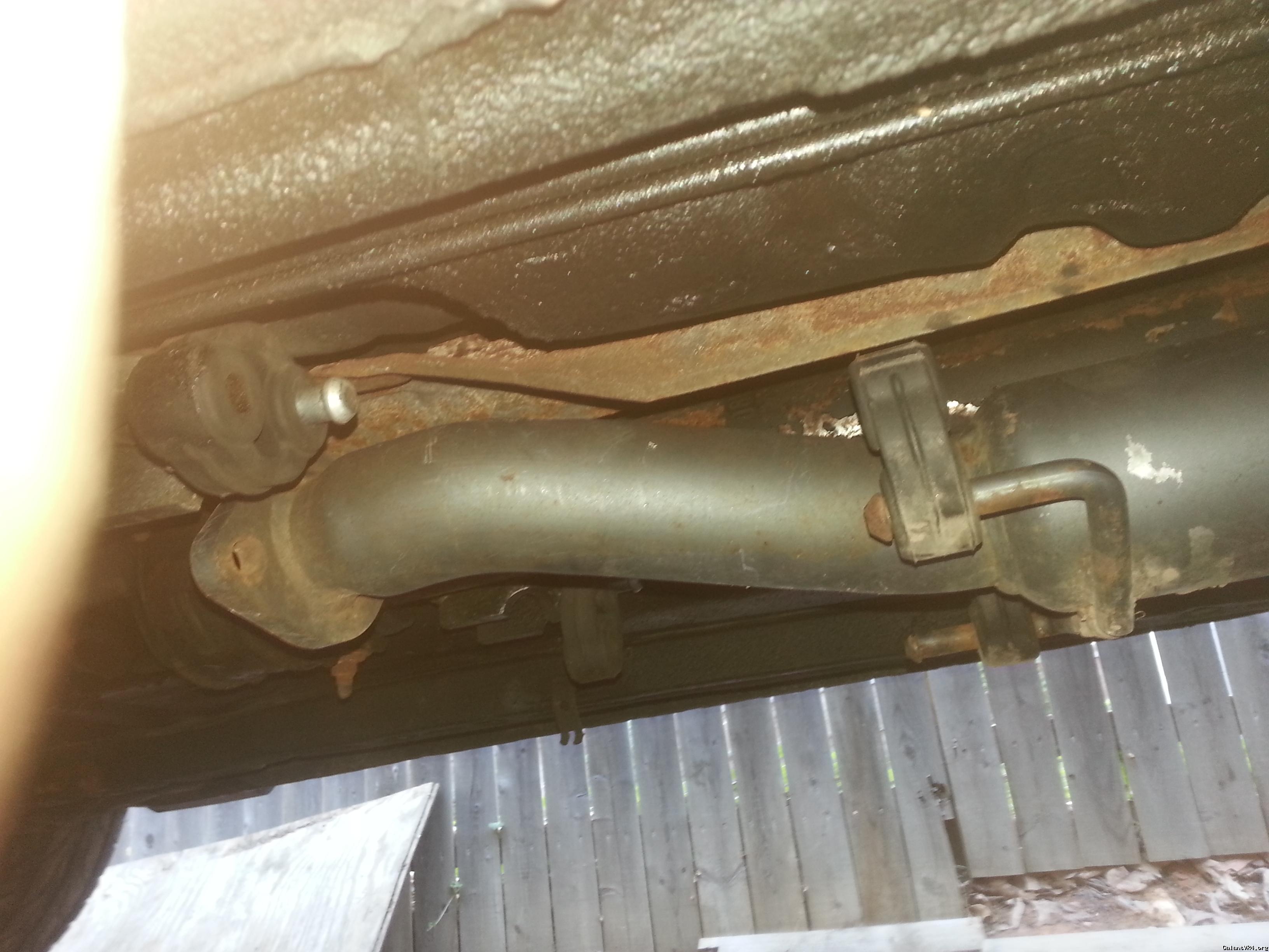

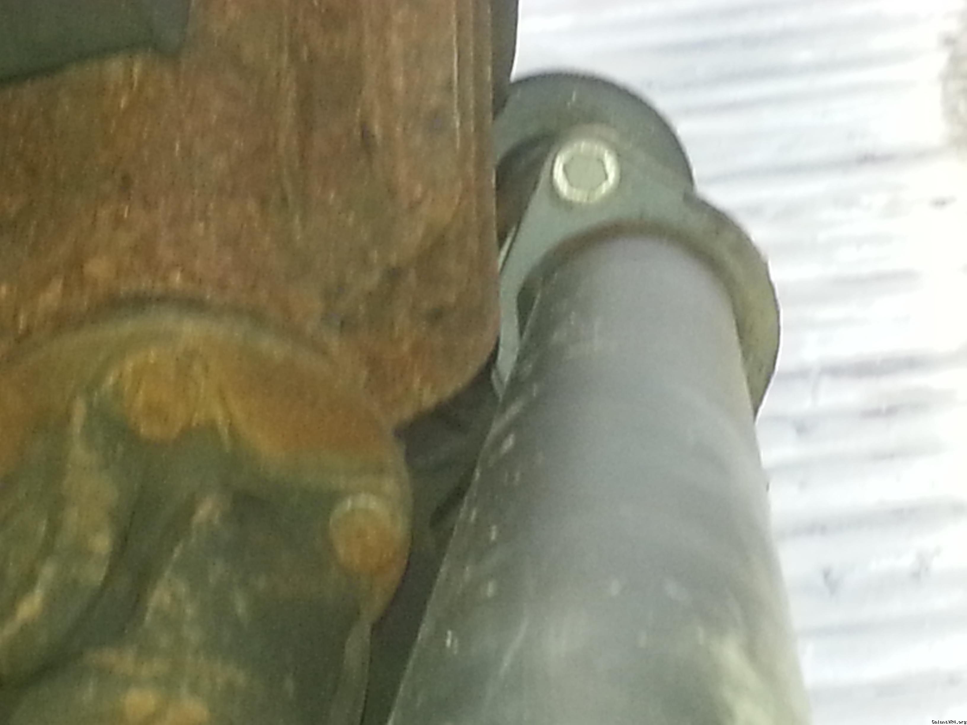

Sorry for the delay. Rain and wet driveway issues. So I got it off the ground so I could work under it. The muffler seems too far to the right and is puahing against the lip where the oem muffler goes under. It barely clears the rear end. Looks like the hangers are being stretched bad. The rod after the resonator needs to be moved up a few inches. The dual hangers need to be moved up to where the exhaust extension is going to be. Seems good to me. Maybe some hanger rod relocations. I spun the images to the right and it still turned them left... I give up.
3,479
Looks like you just need to cut off the hangers and start new. Do you have a welder? I'm located in Annapolis, if you need some help. My welder would probably do the job.
