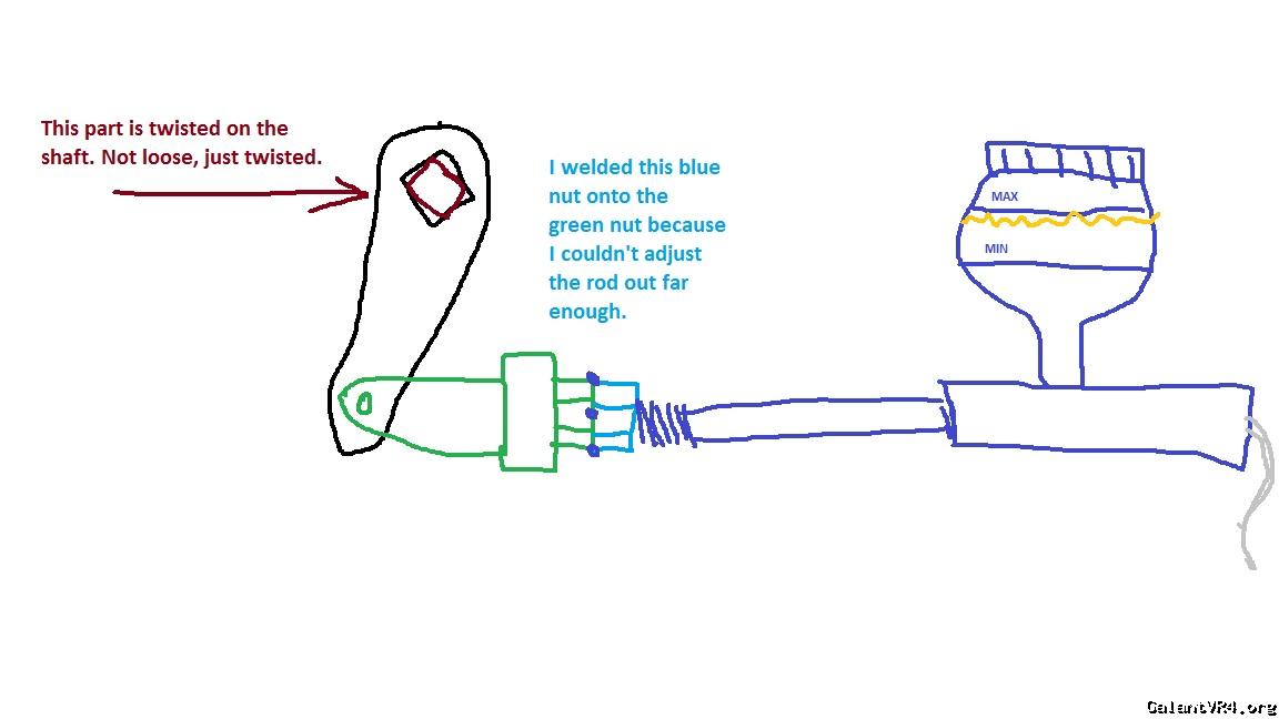

Mine doesn't release unless I kick the floormat out of the way either. The little arm that pushes the master starts twisting/wearing on the pedal pivot shaft and can get twisted so far back that you run out of adjustment. I welded a second nut onto my master adjustment shackle as a temporary fix, but it's still not awesome. What bothers me most is that my Colt has the opposite clutch feel, so going back and forth is difficult.
Outside of adjustment and bleeding, the only option I see left is looking for a wider bore master, and/or a narrower bore slave.
Ps. Another thing to consider is adjusting the cruise cut switch as far up as possible to get the longest pedal swing you can, then adjusting the master rod accordingly.

Fixing the broken clutch pedal assembly is an option, but in my particular case, it doesn't seem like that's enough. As I mentioned, I found a work around that made up for the twisted pedal assembly restoring my missing adjustment but it just barely allows me to shift with a floormat under the pedal.
I realize they offer different diameter bores, but the listings were cryptic and I think my car ended up with the wrong combination of cylinders. That's why in my case, it seems like the only option left.

I wasn't looking to hijack this thread or make it all about my car, but yeah I had to do some temporary McGuyvereing to my car, but it's my daily, it was -15 degrees out, and I just wanted to be able to shift gears without pulling the entire pedal assembly out right then and there. As for the analogy that I want to re-engineer the whole system to make up for my rigging, that's not the case at all.
Yeah it's not ideal, but when I pull the whole dash this summer to address it heating issues, mouse sh*t issues, and random rattle issues, I can toss the little modified part in the trash and replace/repair the pedal. The fact is, this horribly unwholesome repair does effectively negate the worn pedal issue, but my clutch still engages about four millimeters from the carpet. That's why I want to see if I'm possibly running too narrow of a master, or too wide of a slave. I know none of the parts on this thing are original, so the possibility still exists that I would be restoring the car to it's original condition rather than hacking it by doing so.

that isn't where play will be. push the clutch down with your foot all the way to the floor, get out of the car, grab the clutch pedal arm and pull it straight up. if it pulls up higher then it was then the pedal assembly is broken. ive fixed these. when i did mine i just removed the assembly, cut the nut and thread off the end, set the pedal to where i wanted it and welded in the whole area that was worn, broken and/or twisted. took a little while as i had to weld it slow and constantly put water on it to not melt the rubber inside the assembly, but it worked and has been for thousands of miles on 4 different cars.
