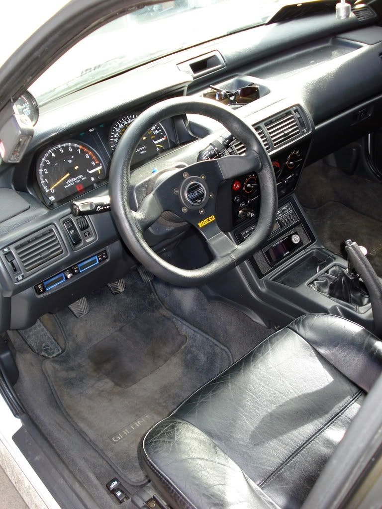

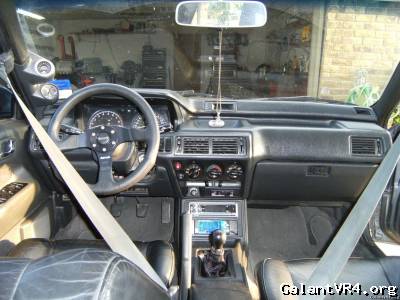

I wanted the exact same thing. I found a very simple APEX turbo timer that matches our amber color perfectly. The boost controller would be an old GReddy profec B. People selling them are freakin' proud of them though. I have them side by side under the cd player, but that assumes you have an afftermarket single din radio.

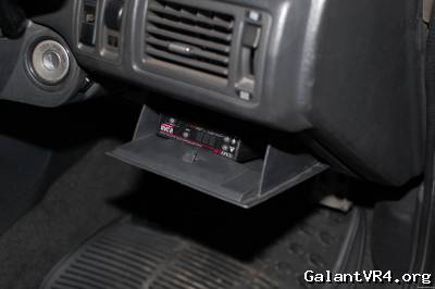

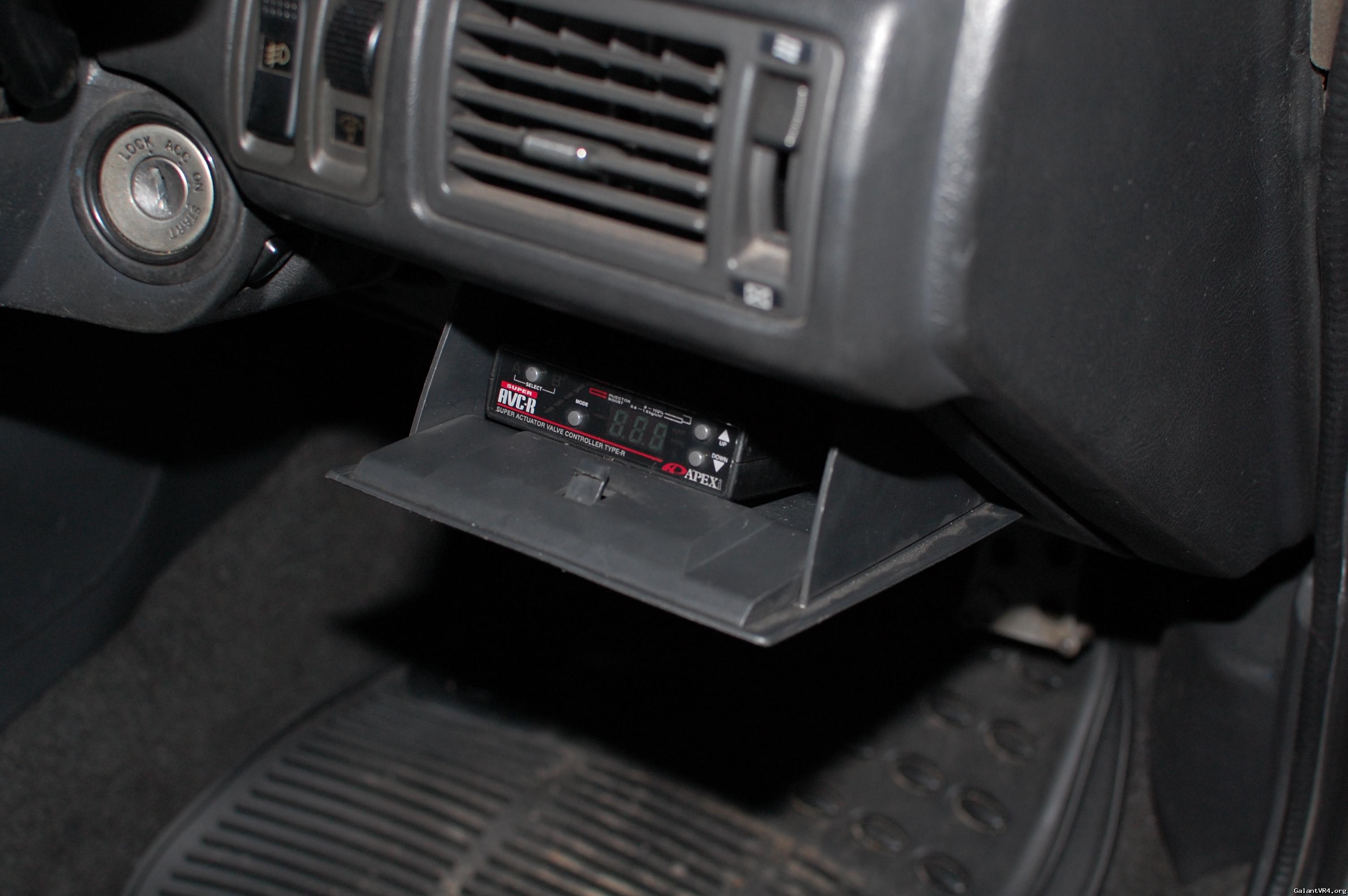

Depending on the size of your electronics, I cut the front of the ashtray out and mounted a turbo timer in there. I really took it slow and fitted it perfectly so there were no unsightly gaps.

I put my profec B (soon to be for sale) in the center console in a very nice manner. I wonder where my pics are of it. I also had an apexi turbo timer that I installed just to the left of the steering wheel.

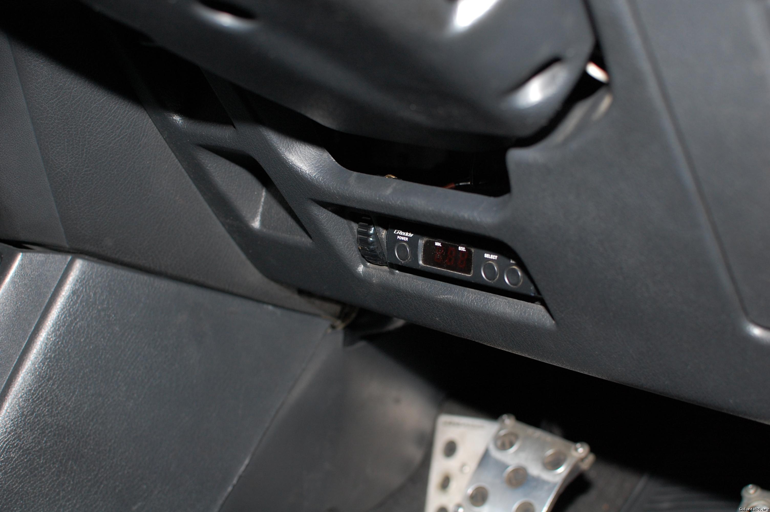

On my first GVR-4, I had my Greddy TT mounted in the vent under the steering column like Cheeky there. Worked great, with no issues until I was showing off on some back country roads one day.
Came around a corner, with my ass end hanging out and the throttle floored. Let off the gas, and the throttle cable got hung up internally. Engine is now bouncing off the rev limiter, and won't come back down. I shut off the ignition when I hear the distinctive sounds of my Turbo Timer starting its countdown. Crap. I forgot to hook up the emergency brake bypass. /ubbthreads/images/graemlins/devil.gif One of those things that I "would get to later". I'm still accelerating down said podunk two lane country road, and fumbling underneath the dash trying to find the off button on the TT. After much frantic stabbing, and cursing I finally get the damn thing turned off. Engine shuts down and I try to get the car pulled over to the side of the road with no power brakes or steering from 65 miles an hour. Fun.

I cut the front of the ashtray out and fit the tt so it was protruding out the front. Other than being silver it looks factory. A plus to mounting it like that is that you have a great stash spot within easy access that isnt noticable to the untrained eye.

Steve if you are specifically sourcing a turbo timer or boost controller with a green display to match the interior and want to put it on display, I can understand you not wanting to hide it under the dash. That said, I am 6' 5" tall and about 230 lbs so I am not what you would call small but it is pretty much impossible to catch that timer with your knee, especially if you get one with dimensions that allow it to fit right in that vent like the GReddy one. I have that specific timer on both of my cars, just because it fits so perfectly. When you remove the vertical slats in the vent, keep a few. They match the profile of the vent exactly and make excellent shims to centre the timer in the slot and get a really snug fit.
