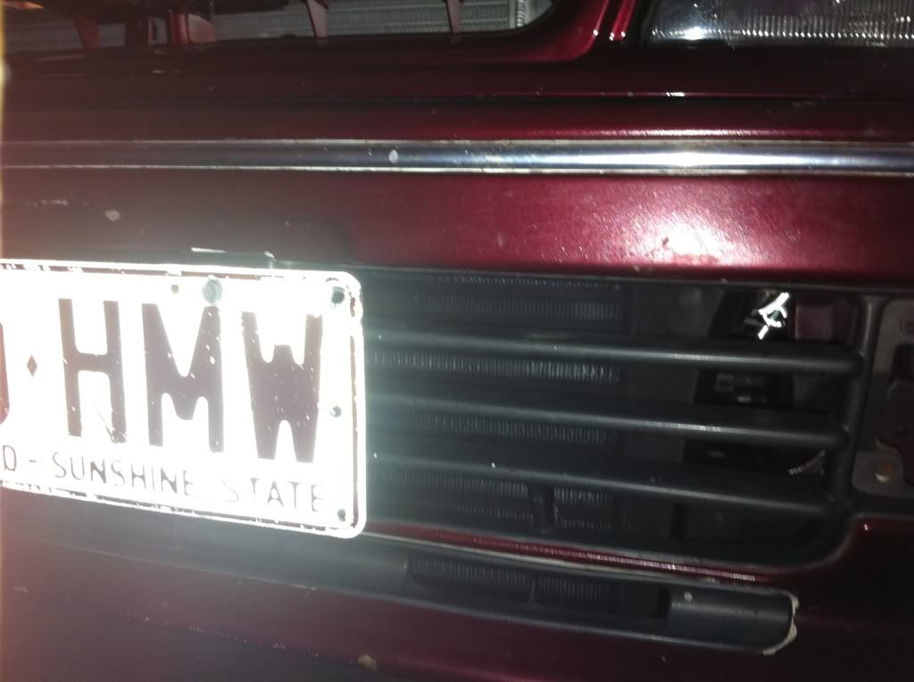

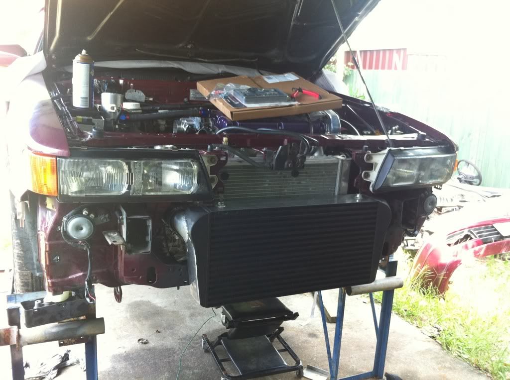

I gave mine a very light coat of flat black to hide it a bit.
Doesn't seem to affect air temps ar all.

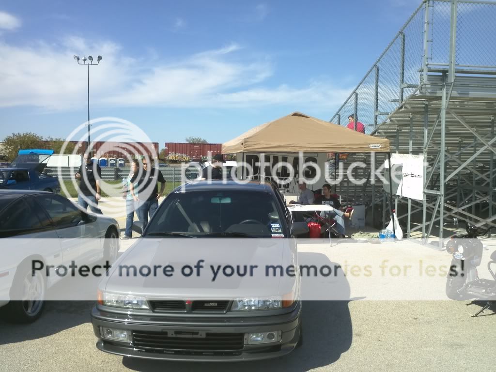

I read a ton of forums and the devilbiss plus seemed the ticket. I read good things about Napa's crossfire paint so I was going to go that route - I think it's been renamed though but still good. I thought you couldn't spray paint intercoolers so that is fantastic news will definately go that route until I can fill the gap with a big one. I like the idea of not showing it off so much too. It looks great in those pics.
