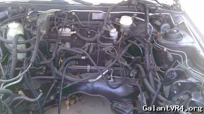

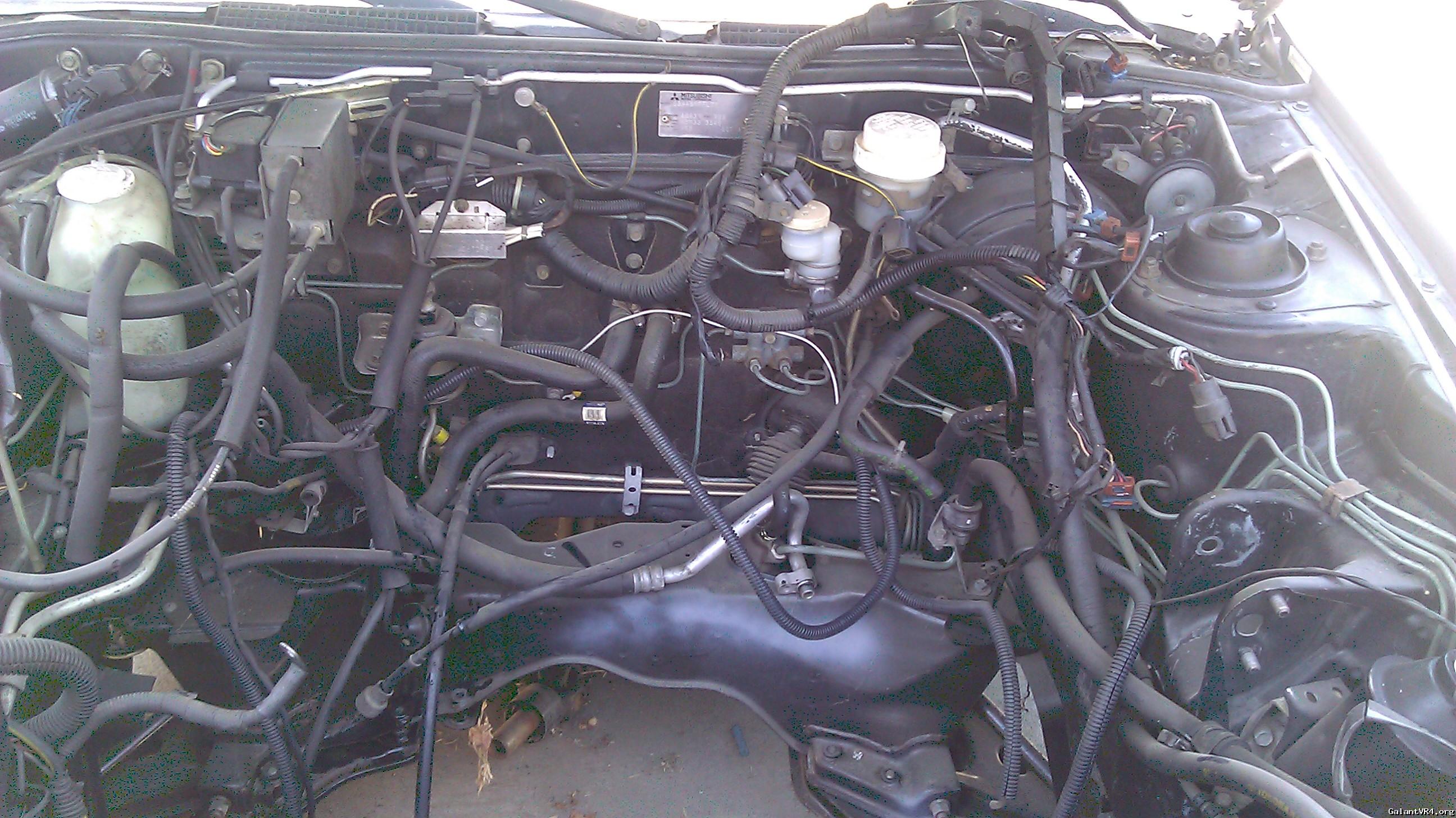

Quoting turbowop:
Or just connect 12v to the fuel pump test lead on the firewall. No need to remove the CAS, lol.
  • were exactly is the fuel pump test lead haven't been under the hood in awhile freaking mad house in there /ubbthreads/images/graemlins/ooo.gif

The test port is right on the firewall. From the factory it has a plastic cover. It sits next to another connector that you ground when you set ignition timing. The one that you want is the smaller of the two. I believe it is near the middle on the driver's side, near the top.
