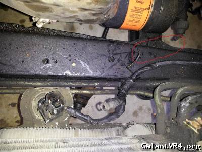

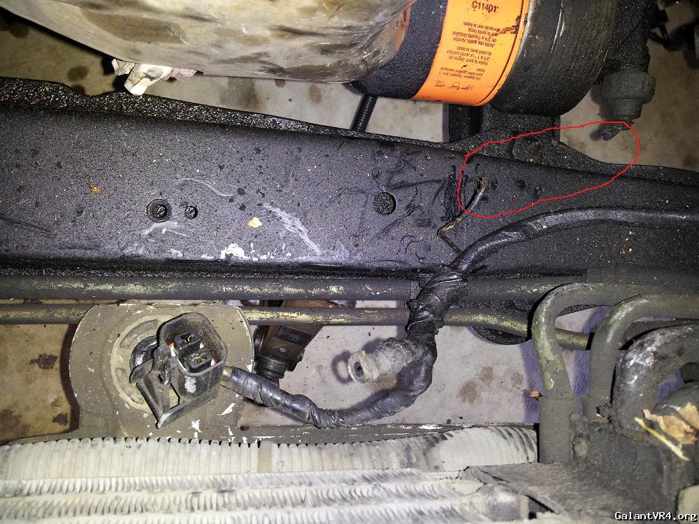

Turns out the alternator was bad, I took it to a Kragen and I guess it wasnt pumping out the right voltage. So anyway I got a new alternator (99.99) and was about to install it when I noticed this.
Im not too car savvy so I was wondering if I accidentally did this when I was pulling the alternator (seems most likely) or if it was already like that and was somehow messing with the electrical system (Im guessing its a bit of a long shot, I just dont want to install the new alternator and still have my battery die every night lol)

That wire connects to the low oil-pressure switch, (your oil-pressure dummy light won't work now) Trim and strip that, and crimp on a new spade connector, and you're good to go. Easy peasy.
Installing the new alternator is the next step, do it.
After you've charged your battery and installed the new alternator, check for current draw when the car is off.
