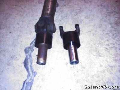

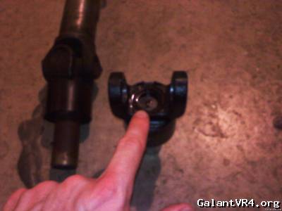

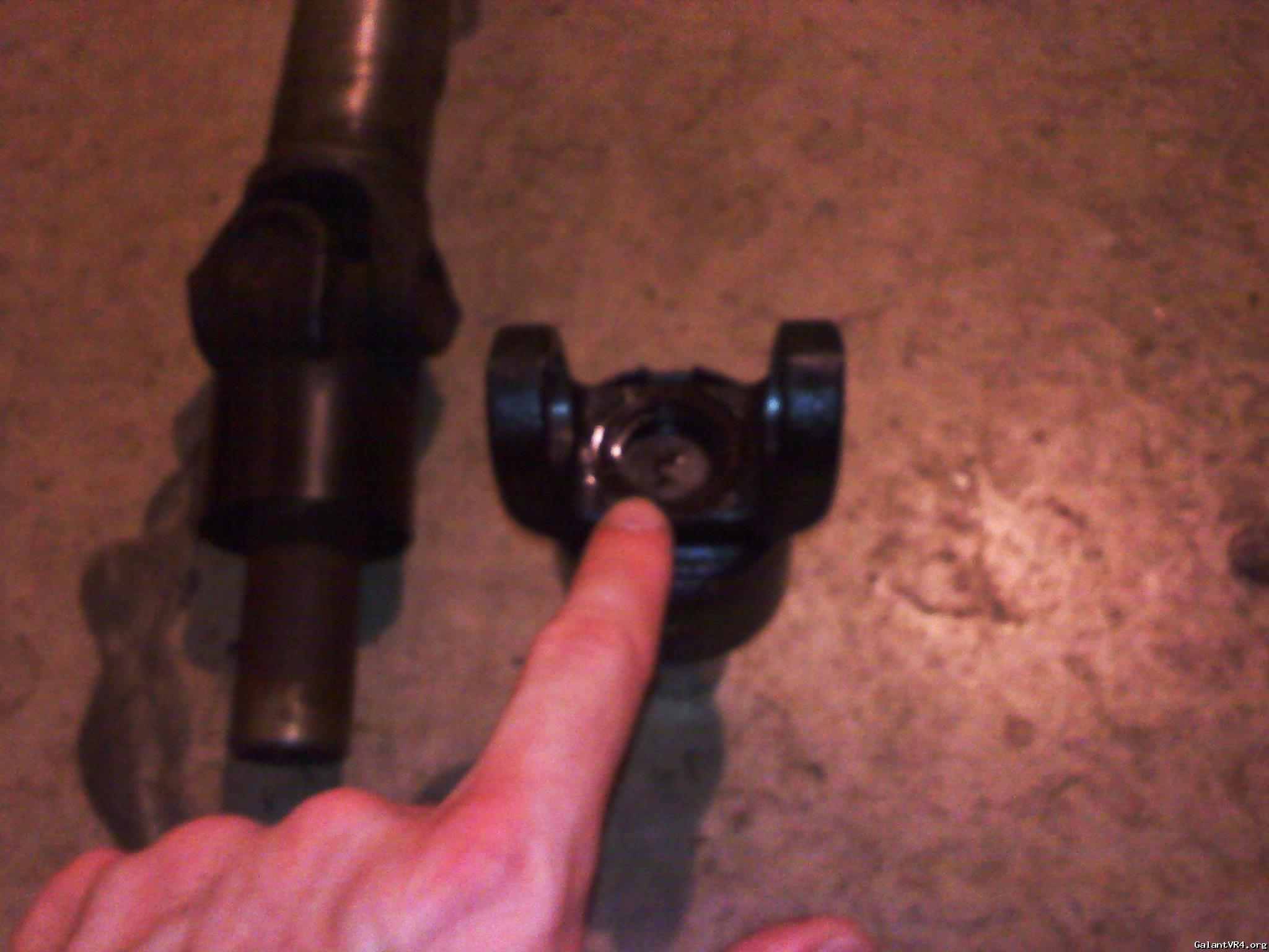

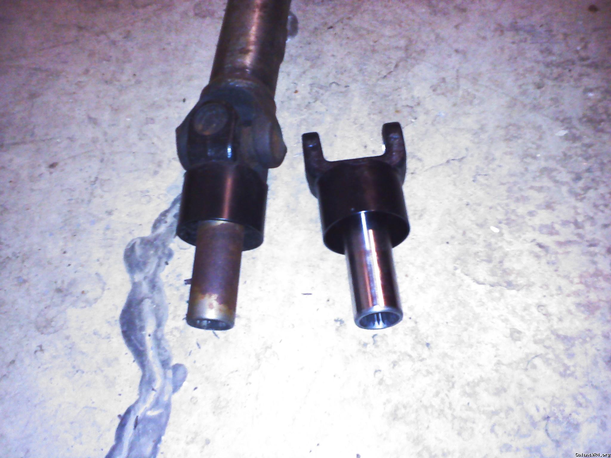

If its leaking on the backside of the yoke, that's the recall that all of our cars should have had at one point or another.
Where I'm pointing is where the yoke leaks. This yoke on the right hand side is what the recall kit consists of, but its missing the u-joint or whatever its called.
