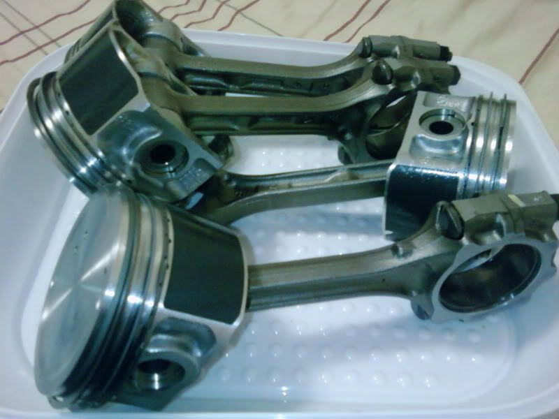

All the ones I seen are forged. I had a set for sale a while back.
http://www.youtube.com/watch?v=P9SPaYI3_wY&feature=player_embedded
Edit: Pic's of EVO 9 forged pistons
