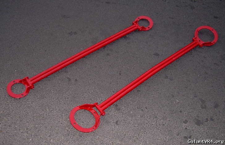

Quoting derekvr4:
has any one fabricated there own strut bars for the galant, pics and info appreciated!thank you
I have. ill get some pics.

Is that round bar or pipe? Oh and if that is for a specific application why not hard mount it and not use the movable joint to attach the bar to the mounting plate?
GIjoe
Jul 27, 2008
1,044
Budapest
Its pipe. Its not hardmounted cuz it wasnt only made for my car. The guy made 5 sets for me that I used to sell. for some cars the bar would touch the TB so it needs to be bendt a little more. with movable joints you have the option to slightly modify the strut bar to make it fit right. sure hard mount might be better but believe me, these bars are pretty tough, the guy who made these builds drift and rally cars.
