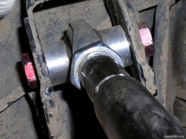

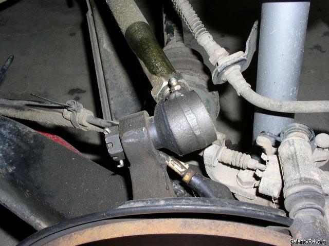

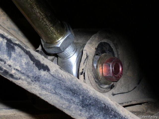

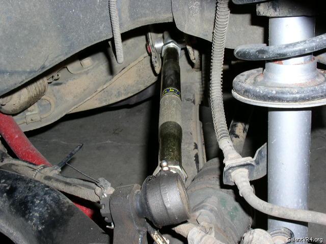

I ordered the parts listed in the first thread hoping that everything would fit. The only thing I added were the jam nuts.
I ended up with 2 extra rod ends with standard thread that came with the bushing kits and 2 extra jam nuts (they came with the standard thread rod ends). You could go with 2 reverse thread tie rod ends and 2 #20023k rod end/bushing kits and cut down the cost. I also had to cut the aluminum bushings to fit. Overall, they fit great and have more adjustment then ever necessary. I was worried about clearance since they are completely straight, but I have had no problems. They have been on my car for 500 miles now. My car has KYB GR-2's, 1g Eibach pro-kit springs, 2g upper rear strut mounts, and 17" rims with 215/45 tires. And by the way, the roads in Memphis are terrible, dime2nr can attest to that.

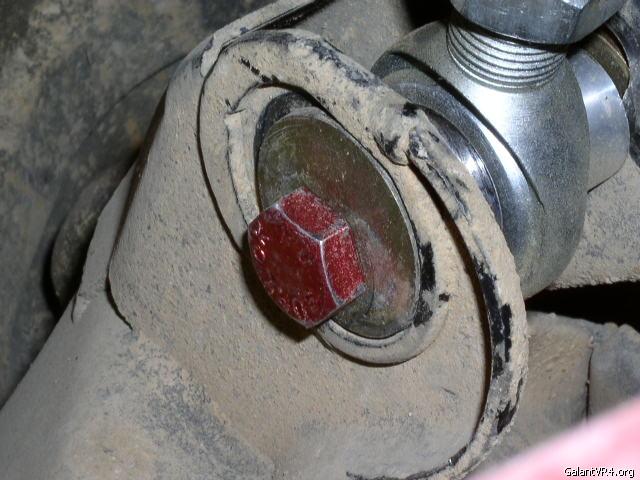

I just installed some of these sort of items on a TT Stealth. Funny thing about that.. the upper rear control arms are exactly the same size as those on my GVR4s.
He got them for like 150 shipped. Real nice units.
They sell for a bit more on 3sx, but i just thought i'd let you guys know they are indeed.. the same item for 3k VR4 AND Galant VR4.

Cool...Thanks alot! That looks pretty good and I'm sure much beefier than the stock unit, plus with the added benefit of so much adjustment...

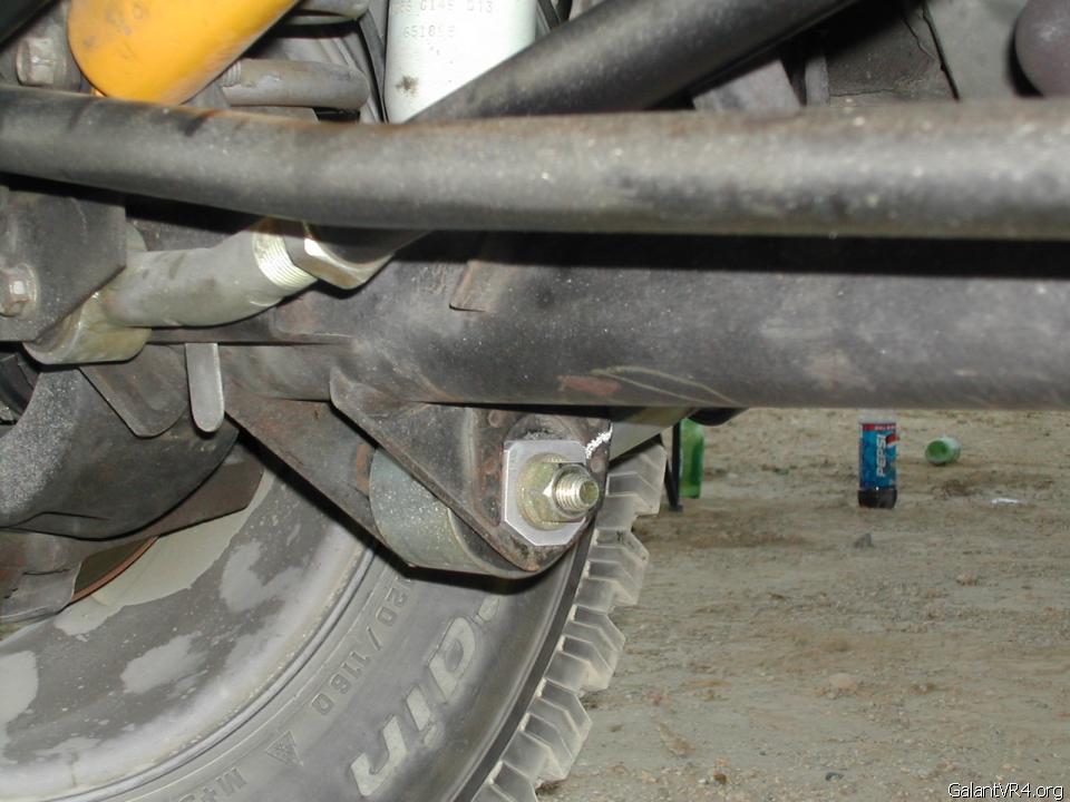

When you say you used the OEM washer, is that a cambolt-type washer (for factory adjustment)? I don't think we have this problem on the Galants, but when I changed my Control Arms to adjustable on the Jeep, I ended up making a plate to eliminate the washer, because it seemed like it kept loosening, no matter how tight I got the nut down, due to the slotted hole/cambolt...Like I said, I doubt this will be the case on these, since the Control Arms on Jeep are parallel to the body, instead of perpendicular, like on independent types...you can imagine then how it would keep loosening on my Jeep, being in the same direction as movement, if that makes sense...
Anyhow, here are those plates I made, fwiw:
