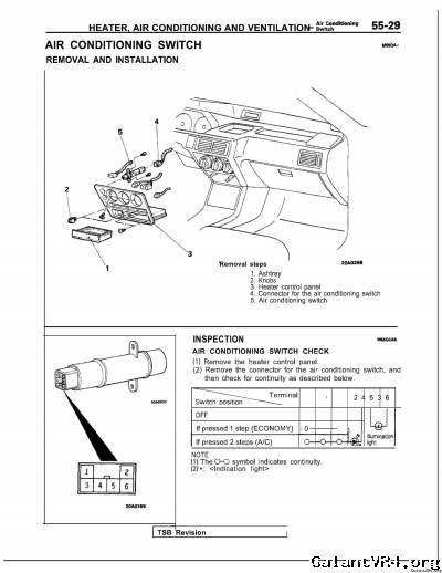

Really? Wouldn't cycling through the switch (econ then ac then off and then back to econ) be the same as restarting the car or does the restarting process somehow do something else that I can't think of?
And we are talking about this switch?

i am talking about that switch, with the car on you can hit that switch as many times as you want, but there is still going to be power to it. once you shut the car down it removes all power from the switch letting whatever is wrong to "reset" for a period of time before doing it again. it could even be something as simple as a wire in the back of that harness coming slightly loose, like the tabs on the harness side are spread apart a bit to much and sometimes making contact and sometimes not and when you shut the car down and turn it back on the electricity arcs back over and reaches the other side
