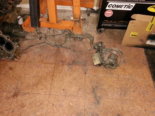

shitty picture of the ABS junk. off to the left you might notice the AC compressor (in a pile of junk Honda single cam motors)

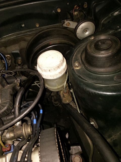

3G MC... took a little bending of the lines. looks legit.

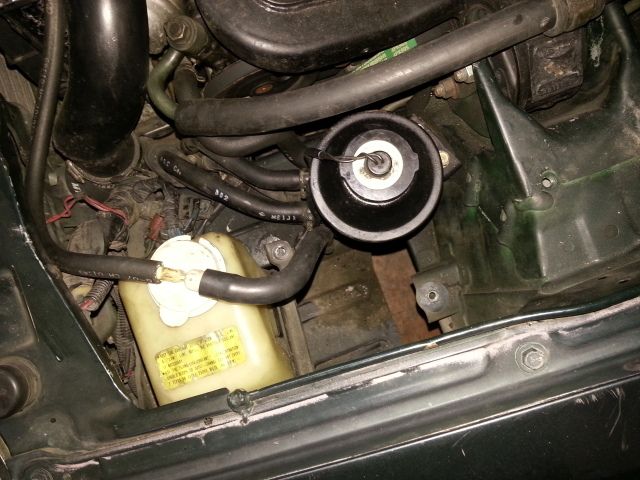

lots of room down there now. need to do something about the big ass hole /ubbthreads/images/graemlins/dunno.gif

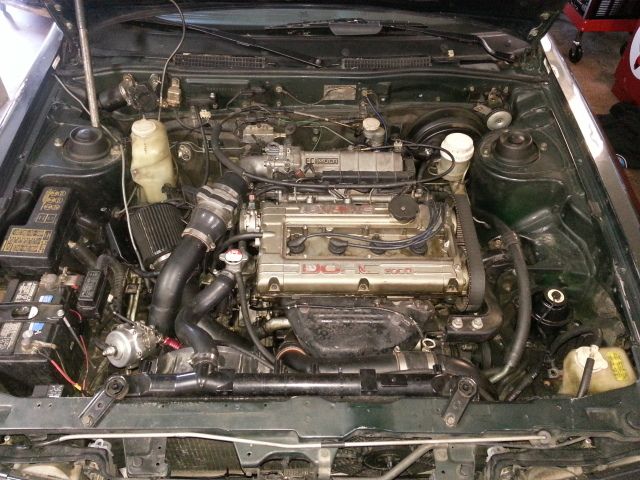

engine bay shot, cuz it was on the phone... still needs some work/cleaning/valvecover painted...
