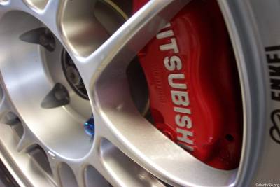

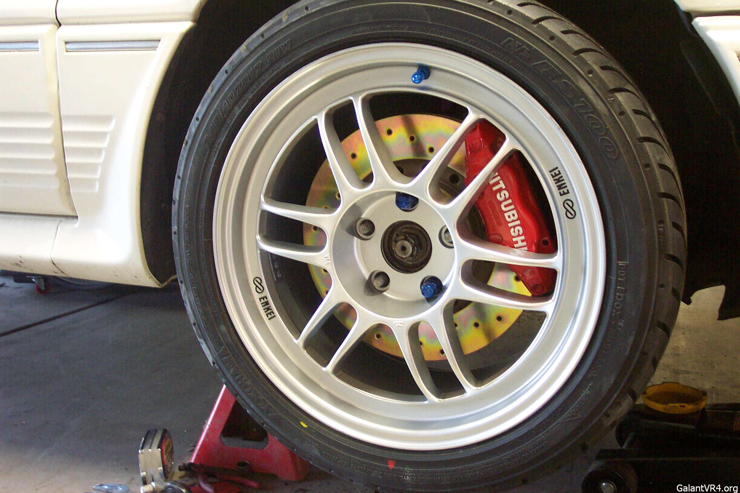

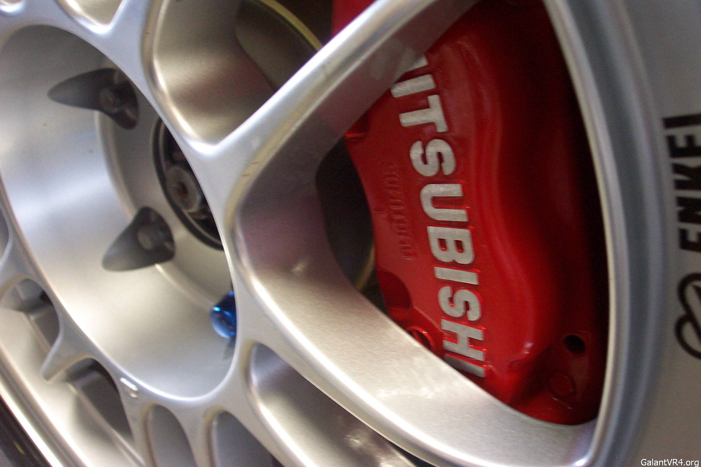

16's will absolutely not work. Here is a picture to prove it...
Those wheels are 17x8 with an offset of 35
There just isn't enough room under a 16in. wheel. You might be able to get a way with a stock size rotor maybe.... but then what's the point?
That's a tight fit /ubbthreads/images/graemlins/cool.gif
How much caliper -> spoke clearance do you have?
Kcpaz: Do the calipers or rotors actually touch those wheels anywhere? If you have 1/4" clearance that's plenty, even for a daily drivers. I have 1/8" and have had no problems over three years.

My clearance is actually probably more like 3/16in. I just said 1/4 because it was more than 1/8. I have no prolblems with rubbing.
i had no problem with the brakes on my mr2 and it literally had .010" clearance between the spoke and caliper
