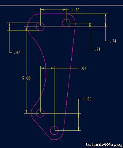

since the calipers i have havent sold i am thinking of putting them on. i need the dimentions of the brackets so can just make them v.s buying them. also what are thoughts of steel v.s aluminum

I was thinking of doing the same thing with my big brake setup. But before you dig too much deeper into DIYing, consider the value of paying the $109 (they're on sale right now) for a tried and true, r&d product. It is a bit risky gabbing up brackets that hold on crucial components like brakes.
yea but i willng to take chances and it gives me something to do.
this is what i found does this look right, using 1/4" steel

That design is for the DSM, using 1g 3000gt VR4 calipers and rotors for a mustang cobra, but I don't recall the year. There really is alot in the R&D of the brackets. The ones on tuners nation are made for the Galant, with 1g 3kGT Calipers and 2g 3kGT rotors IIRC. If you're going to make your own, go all out. Pick the rotor and caliper you want and gets to measuring, but I doubt someones going to give you the formula to their profitable idea. Just my humble opinion of course.
