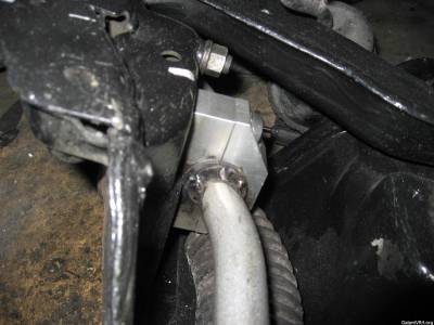

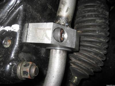

From my build thread: -
Quoting cheekychimp:
Finally got to the shop today. Didn't make loads of progress but damn it feels good to be back at the car again. First off I posted before about the problems I had with the mounts and bushings for the larger diameter front sway bar. I was so sick of trying to hack it before going back to the UK I had Ken drop it off at the machine shop for this to be done:
Not all that pretty, but very effective. I don't think I will do an aftermarket bar on the daily but I do have an uprated rear for it and I will definitely be doing mounts like this on the rear 3KGT subframe when it goes in.
Paul.

I had a machine shop custom make those, together with welding on the "washers" to stop any lateral movement. I used a solid internal nylon/delrin type bushing as well although I suppose you could use a stock/urethane one.
I will be getting some made for the rear as I said. I could ask if they could do a front set for a 22mm bar but are you looking to do this soon. It's coming up to Chinese New Year and everything shuts down for the holidays. If Ken doesn't do this within the next week or so it might be a bit of a wait.
You are welcome to copy it ... it's nothing proprietary /ubbthreads/images/graemlins/rofl.gif
