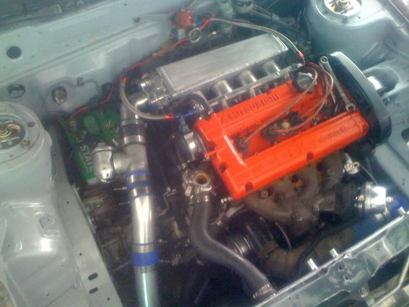

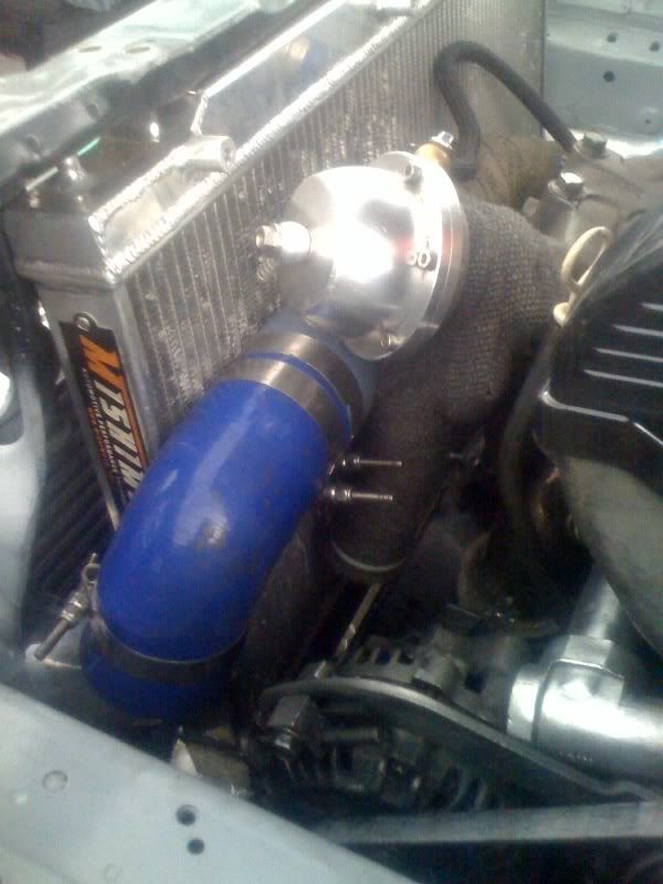

I ran a punishment racing core, custom piping with a 1g radiator. Tucks right under the the support freeing up more space for the pipings.
Tight fit but you can make it work.
