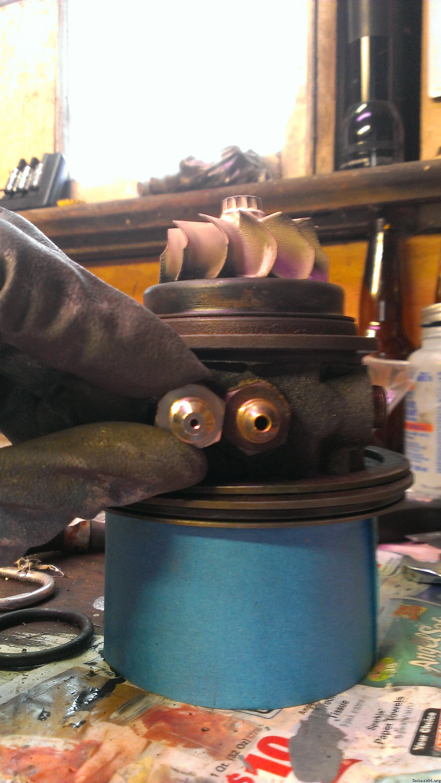

Pretty sure just wanted to be positive. Got this hahn 16g turbo and it has a m12x1.5 thread on the oil inlet, the restrictor i have is standard mitsu inlet thread m12x1.25.
Is restrictor even necessary for this turbo when fed with an 4 from ofh?

even when replacing the stock line with an-4 from the ofh?
I can get a restrictor that fits for $6 on ebay.

The reason for feeding a 16g from the oil filter housing, and not the cylinder head is that we want the higher oil pressure for the journal bearings.

You might want to compare the I.D. of the stock line to the I.D. of 4AN line lol. 4AN is not very big at all.

No it is not. Look inside the casting hole were your oil feed fitting or line screw into. There will be a pretty small hole compared to say a Garrett or holder turbo.
