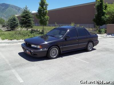

Im getting some ssr wheels that are 15x7 what are gonna be the best tires for street and some occasional autox would 225/50/15 be too wide for 7" rims should I go 205/50/15 instead? would the smaller 205/50 affect acceleration in a good way, more low end grunt.

ya wop I was thinking that too, right now I have 205/40/17's which are really small,
Im going to 15's to save weight and I cant decide between the 225/50/15 and 205/55/15.
I just dont know if the 225 would be to wide for a 7 inch wide rim and cause it to handle worse, or if the 55's would be to much sidewall and affect handling.

I went with the 205/55/15's
the tire shop put a 225/50 on one and it was huge.
the tires are falken ze502
dude thats tons of sidewall causing tire roll and you dont want to run 225s on 7in wide wheels thats gonna cause tire roll pushing would be inevetable......stick with the 205s or just buy a set of tracklights or a good cheap 17 lightweight wheel and go 235/40/17 although the 15s would improve accel quite a bit which might not be a bad thing for autox or scc racing
