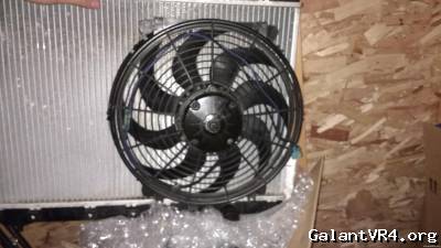

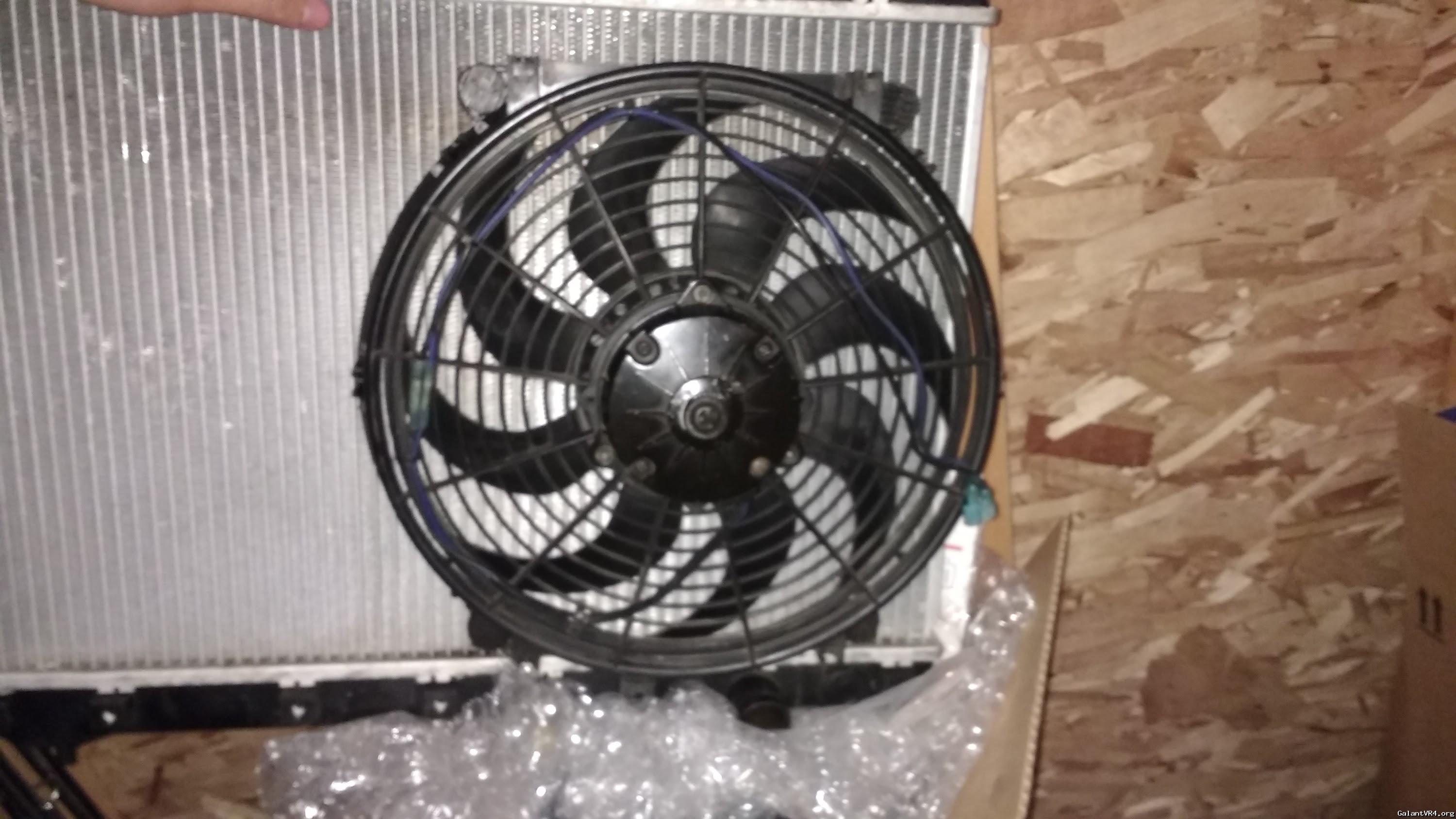

Right now running a pull slim fan and factory AC fan. No extra shroud on the slim one.
3,479
What kind/brand of slim fan. I've found out the hard way not all slim fans are created equal.
Gtpdz
Mar 12, 2015
140
Gig Harbor, WA

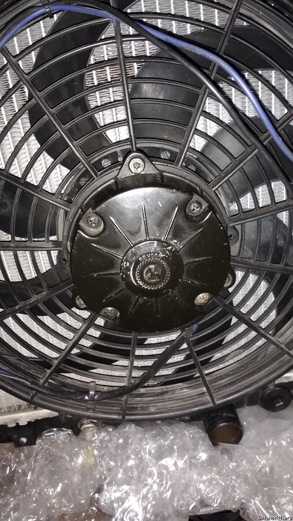

It looks like a revcor 12 inch puller fan to me, also to clear the GT3076 turbo set up, PO slightly offset the fan so the edge sticks out a bit.

100% true. Most slimline fans in my opinion are complete garbage. You need a real high output (read: big motor=not slim) fan or stick with the stock shrouded setup IF you can.
