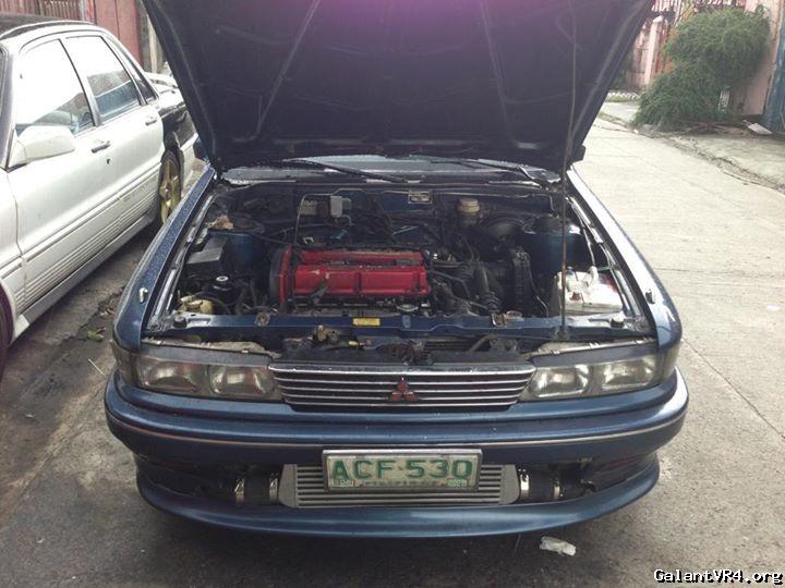

Evo into an 8g galant is a more reasonable swap idea.
You can use the suspension/diff/brakes (sort of) and the ECU (with modification), valve train (but I would not tear the engine apart for just that...).
LIV4PSI
Nov 24, 2011
1,774
O-H-I-O
OP, most of those items can be used on our platforms. Well at least the struts, brakes, ECU, diff and valve train. Swapping internal parts from the EVO is common, it's the entire swap that doesn't happen ever.
