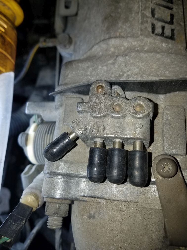

But I have a few items that don't seem resolved. A little direction here would be appreciated. I have circled the mystery parts. Like where does this bracket connect to and plug into?

1st pic looks like old connections for the now deleted AC system. and fan assembly

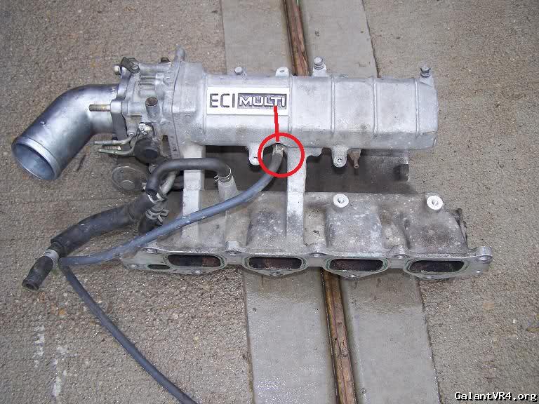

2nd pic looks like the large line that game from the EGR Canister back to the intake (plug the intake side)

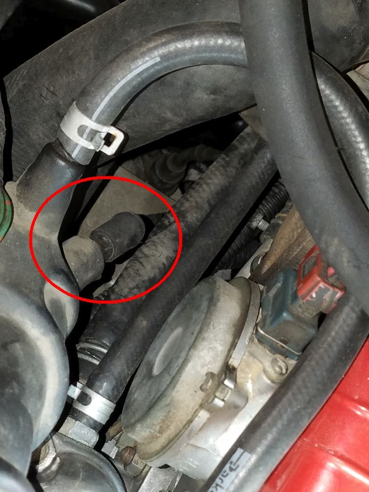

3rd pic is your Blow-off valve. The small vacuum line connects to the line coming out of the intake manifold

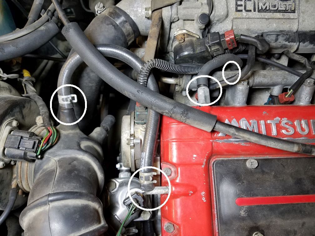

Thank you for the picture example. I already have that intake spot taken. Is this right? I also have another similarly acting vacuum on the valve cover to the left. This leaves my Blow Off valve hanging. The car runs excellent with no lights on. The turbo is smooth and doesn't give any indication of problems. But this Blow Off valve is really a diverter valve, right? I mean, it doesn't blow off to the atmosphere or exhaust. It just shuffles it right in before the turbo.
Thus, maybe I need to find a different intake manifold vacuum nipple? Or like I noted a few sentences ago, is the spot you circled going to the wrong place?

look straight down from the T in MULTI, there is a capped vacuum port. that goes to the BOV. the hose to the intake tube is fine. the other one is fine to, but you'll want to zip-tie it at the valve cover port and get a one-way/brake check valve for the hose and make sure no air can flow into the valve cover.

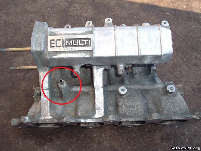

Yea, seems I grabbed a pic of an NA intake manifold.

Transparen,You reference the Multi. I do not know what that refers to.
Here is a pic of a multiple of capped nipples.
Also, should I cap this tube that I presume used to go to my cannister?

Look where it says ECI MULTI on you intake manifild. Look down from there and you will see a small vacuum nipple sticking out, that is where the BOV connects to.
