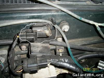

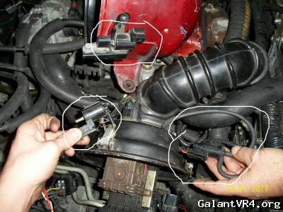

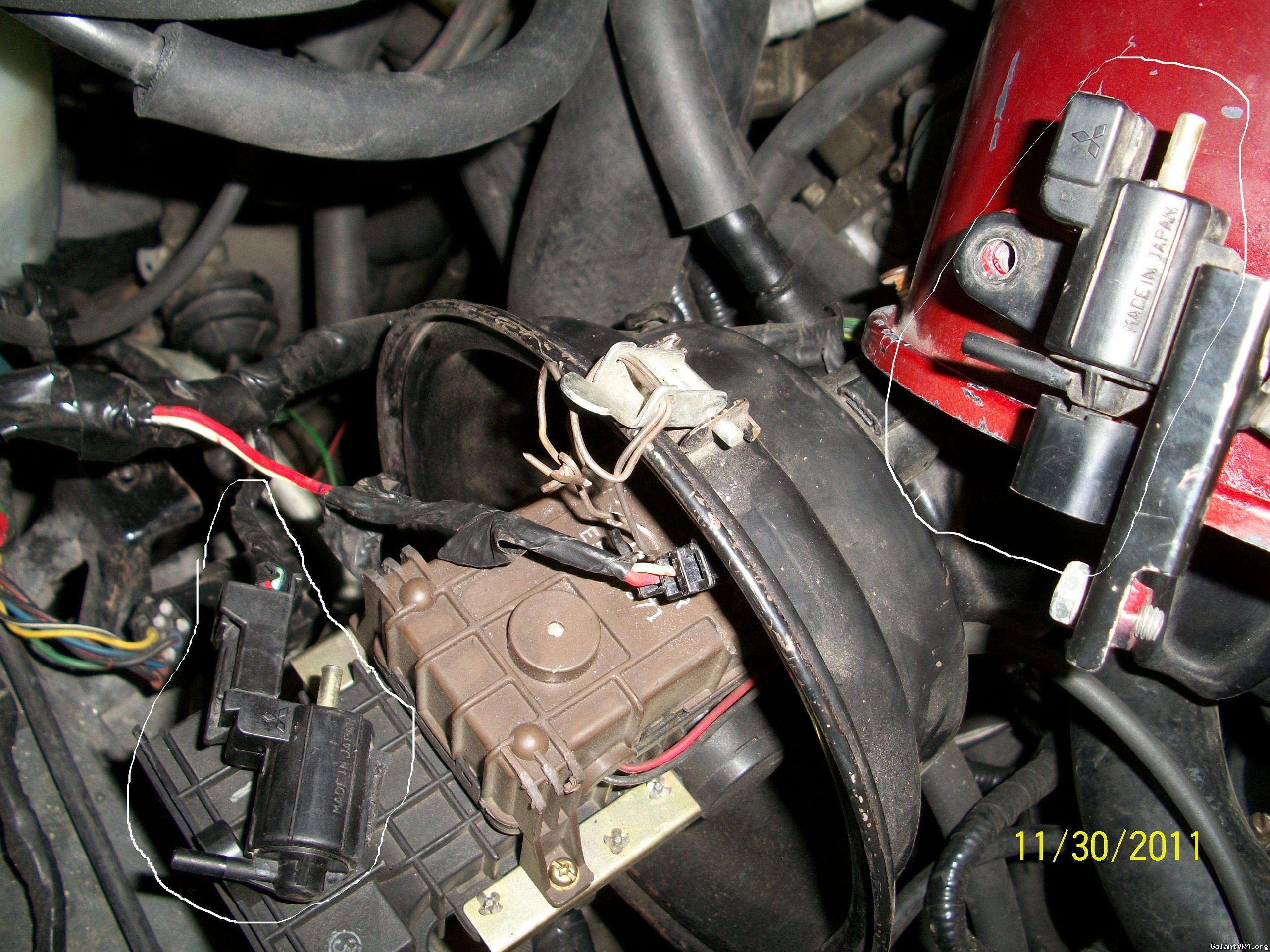

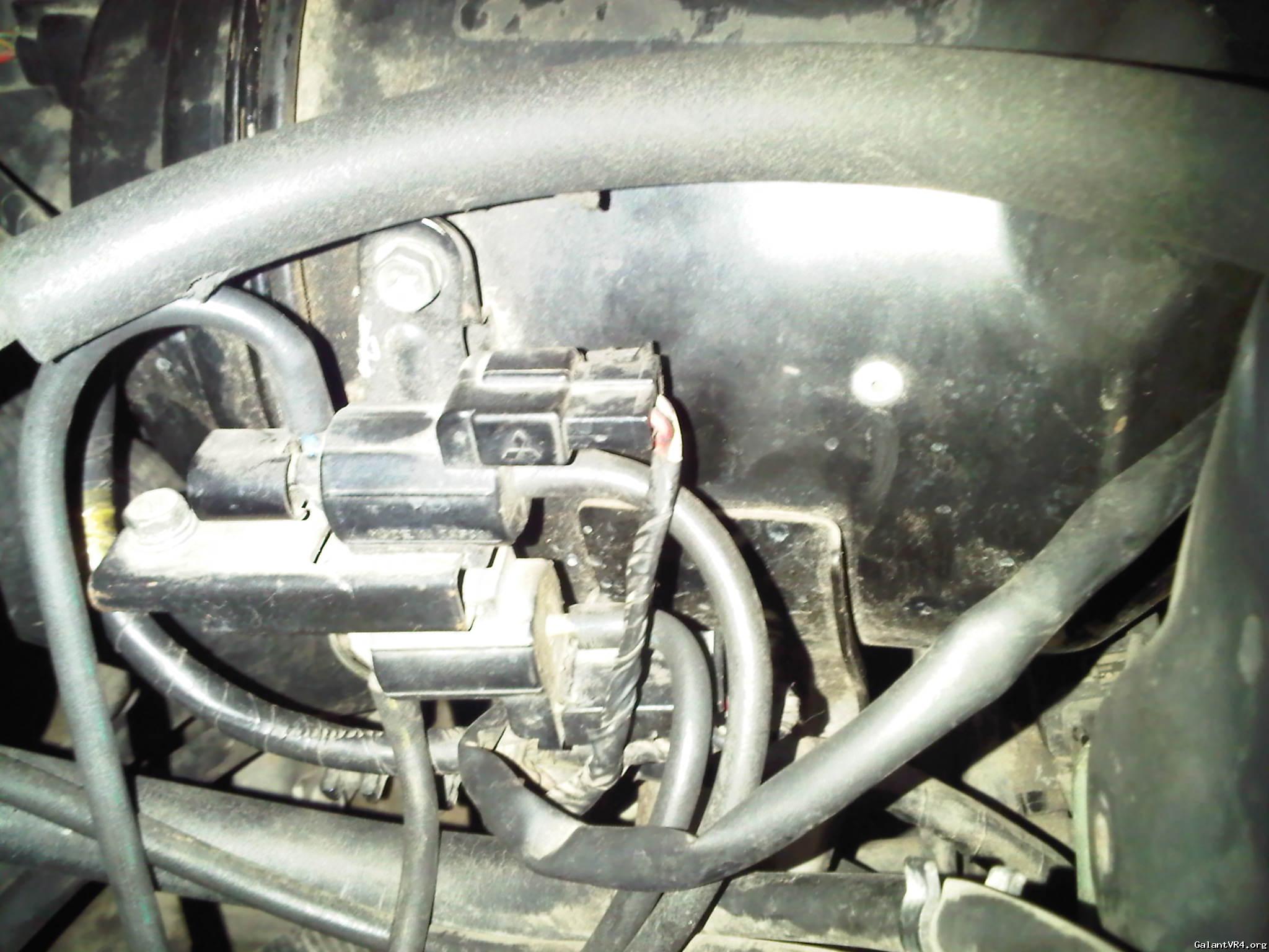

There's 2 of these wired in, and the wiring is all taped up. What's this?

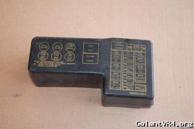

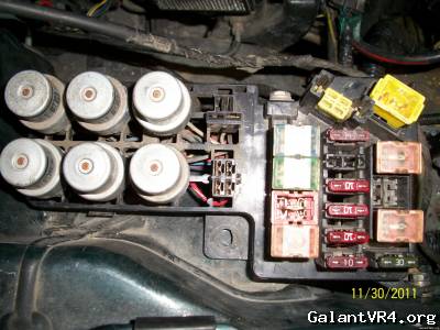

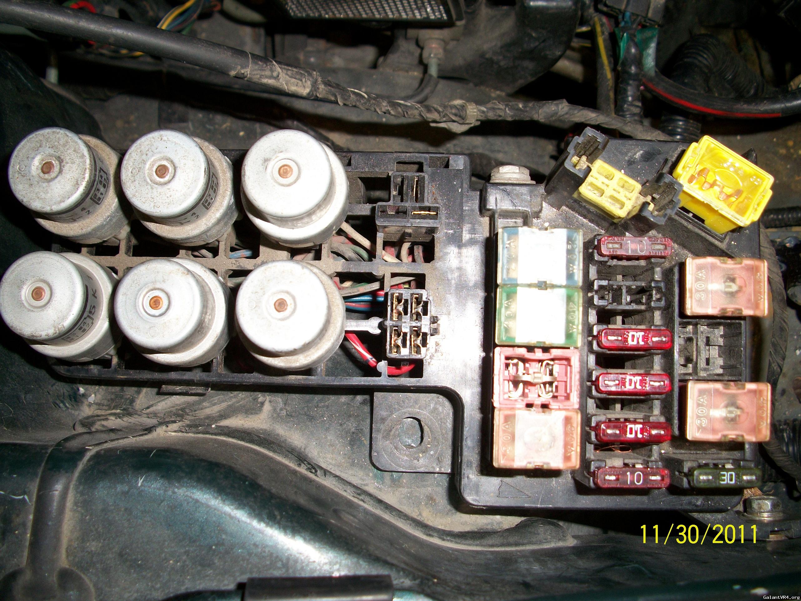

Am I missing fuses? I suck at reading the diagram. I'm guessing headlight maybe? Dunno, just seeing if this looks right.

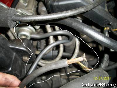

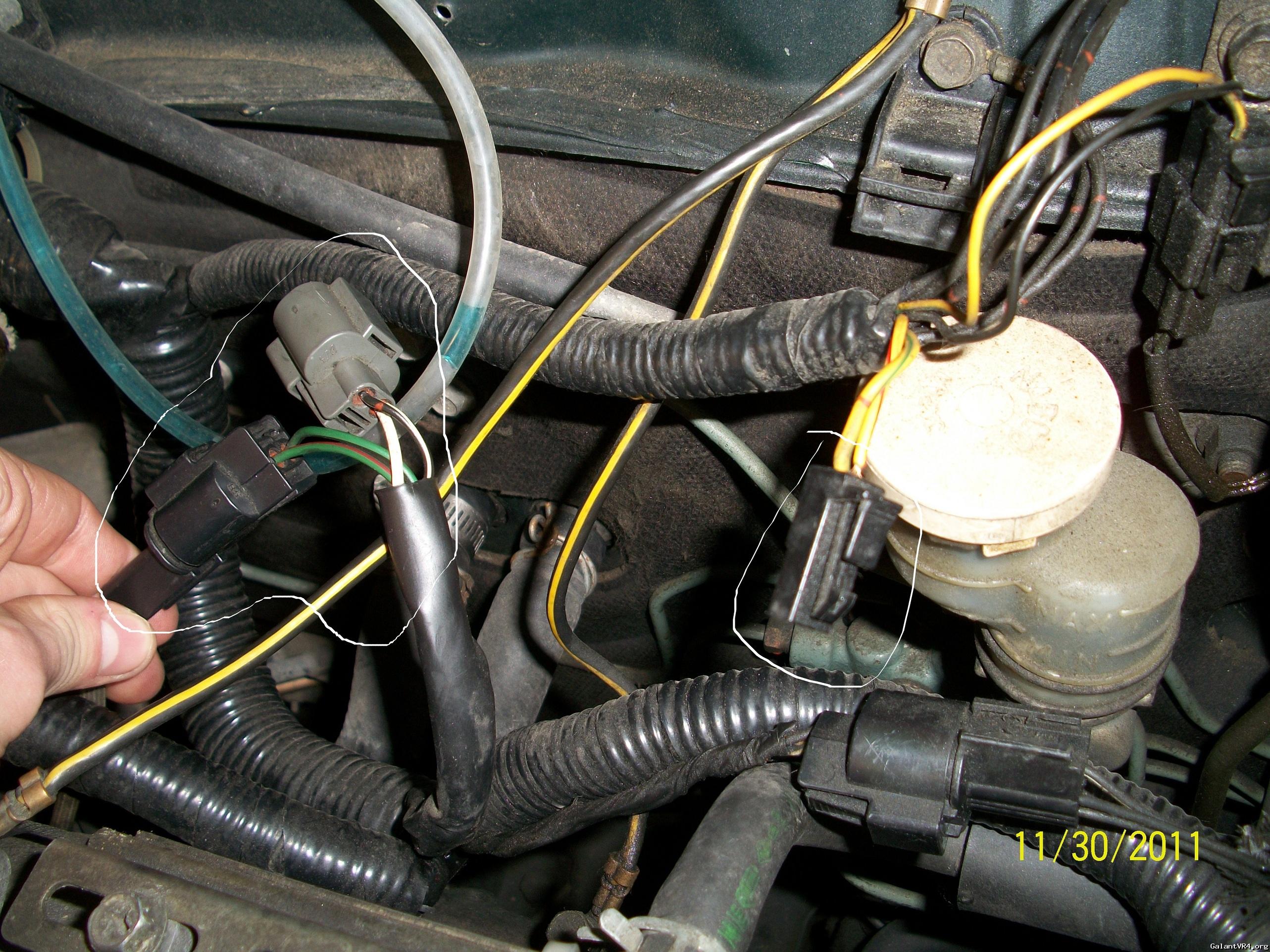

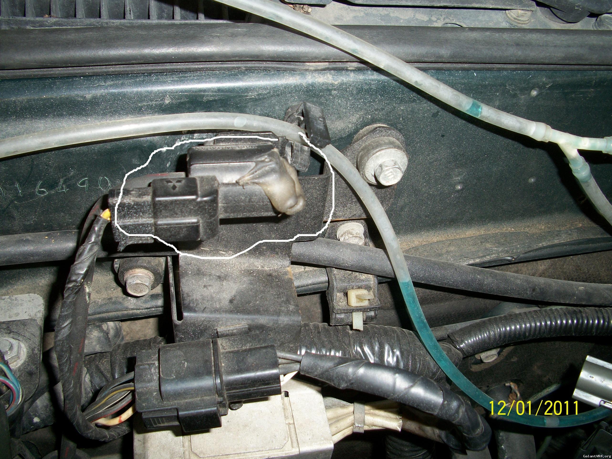

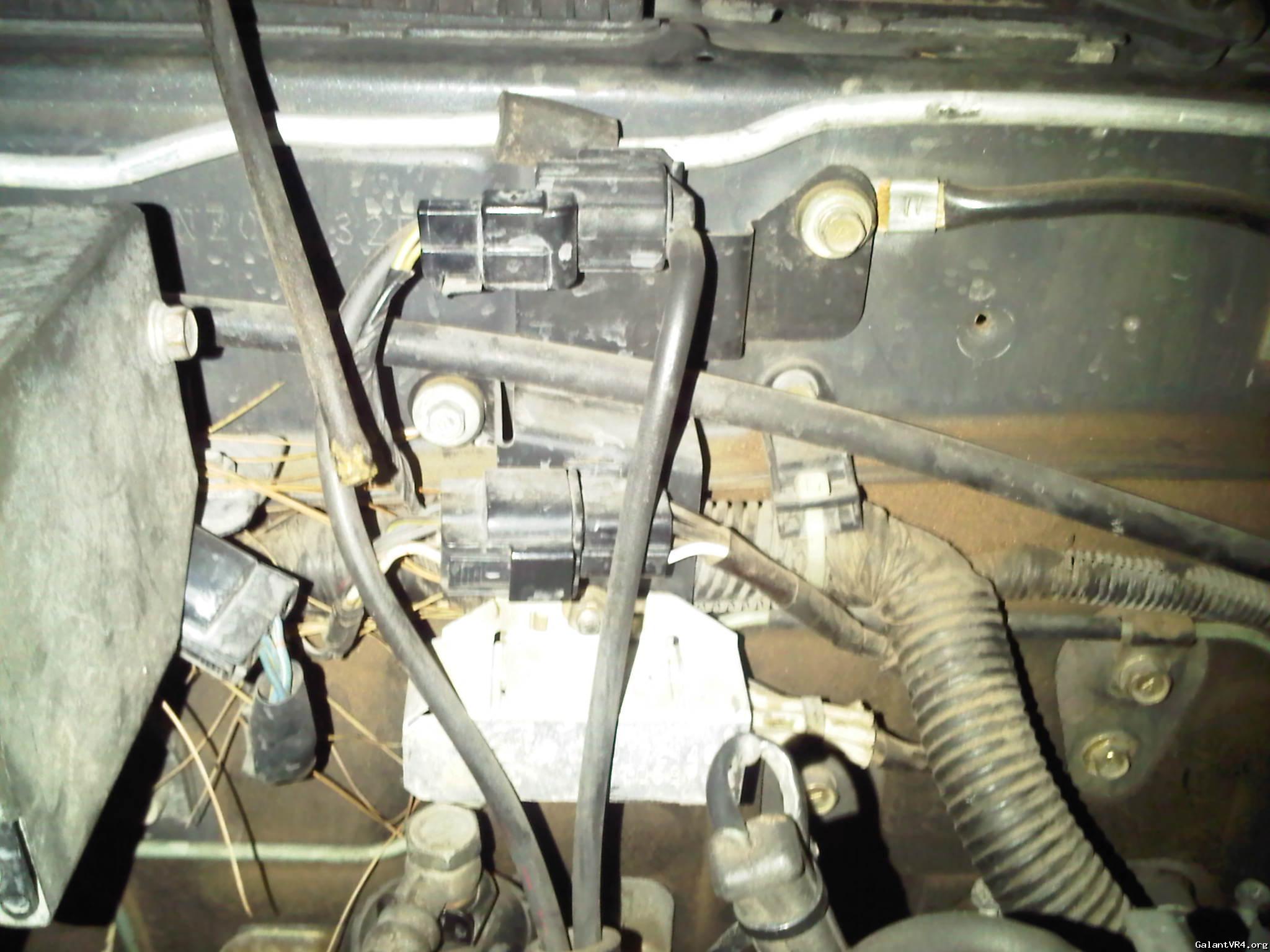

There's a couple plugs here that were unplugged, not sure what they're too? And near that there was some sort of maybe vacuum line that was just plugged with a screw..

from first pic on it look's like those are both boost silonoids.
I cant think of all the plugs in third pic, but the Grey plug is deff. your knock sensor.
So why would I have 2 boost solenoids wired in?
And could that be one of the reasons the Check Engine light is on? Isn't it bad that it's unplugged?

You can have the boost control solenoid removed if you're running a aftermarket manual boost controller.

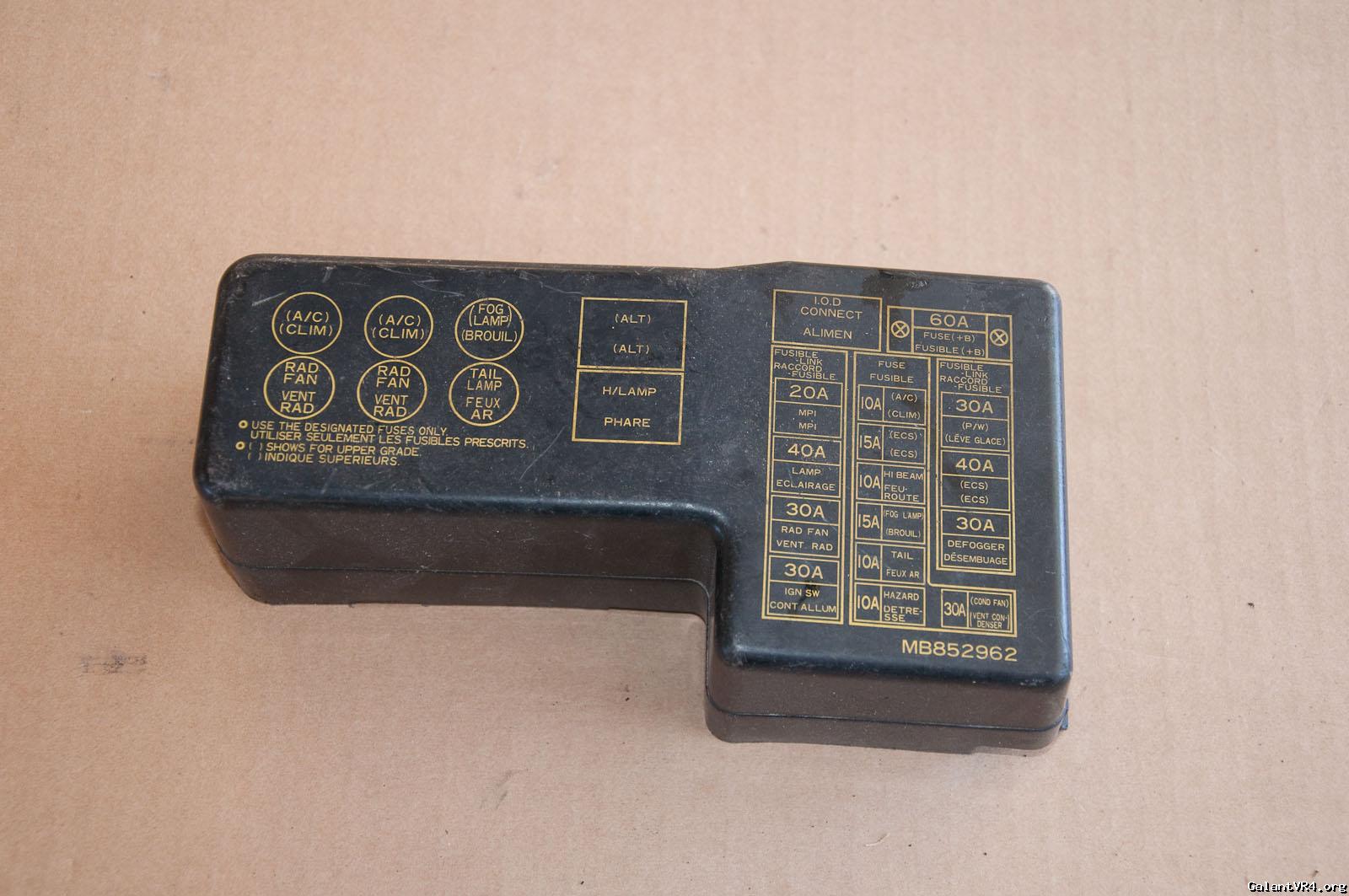

Do you have the cover for that fuse block? That will help you in figuring out what fuse you do and don't have.

But I don't see a manual boost controller, it just looks like 2 stock boost solenoids wired in?
And I do, but it's confusing. I don't need the ecs right? And I'm missing my H lamp fuse, headlight? And what is the fuse for that?

Well you'll have different solinoids all over your engine bay, not just your boost ones, The reason of them is for all the Vaccum hose's that used to be in it's place.. However with it being hacked up i'm sure you don't need them. the simple way of getting rid of them on stock boost would be to unplug them, Take the vaccum line of the turbo's J-pipe and loop it to the waste gate..i've never seen those problems trigger the Check Engine light but it might?.. Out of every Mitsubishi motor i worked on it's Almost ALWAY's the O2sensor..

If the car is running and it's all as hacked as these look, I'd actually check out vacuum lines first & get that knock sensor sorted. You'll want:
- an MBC
- boost gauge
- probably some new tubing
- to make a home depot boost leak tester
Go over each vacuum line & replace as needed, get the knock sensor back together and then boost leak test. There's vacuum line charts all over here, super easy. Establish the mechanical side first, if there's no ground shorts the electrical can wait (except your ECU if it hasn't been serviced)

Quoting AK_DSM:
Definitely missing a couple things, Chief. Alternator, headlights, and the main fusible link is either missing or seriously sketchy.

And, I figured out the fuses I were missing but what fuses do the headlights and alternator take? And the main fusible link I guess.

the dash lights not working was a under hood fuse for me too, i think it was a 15a

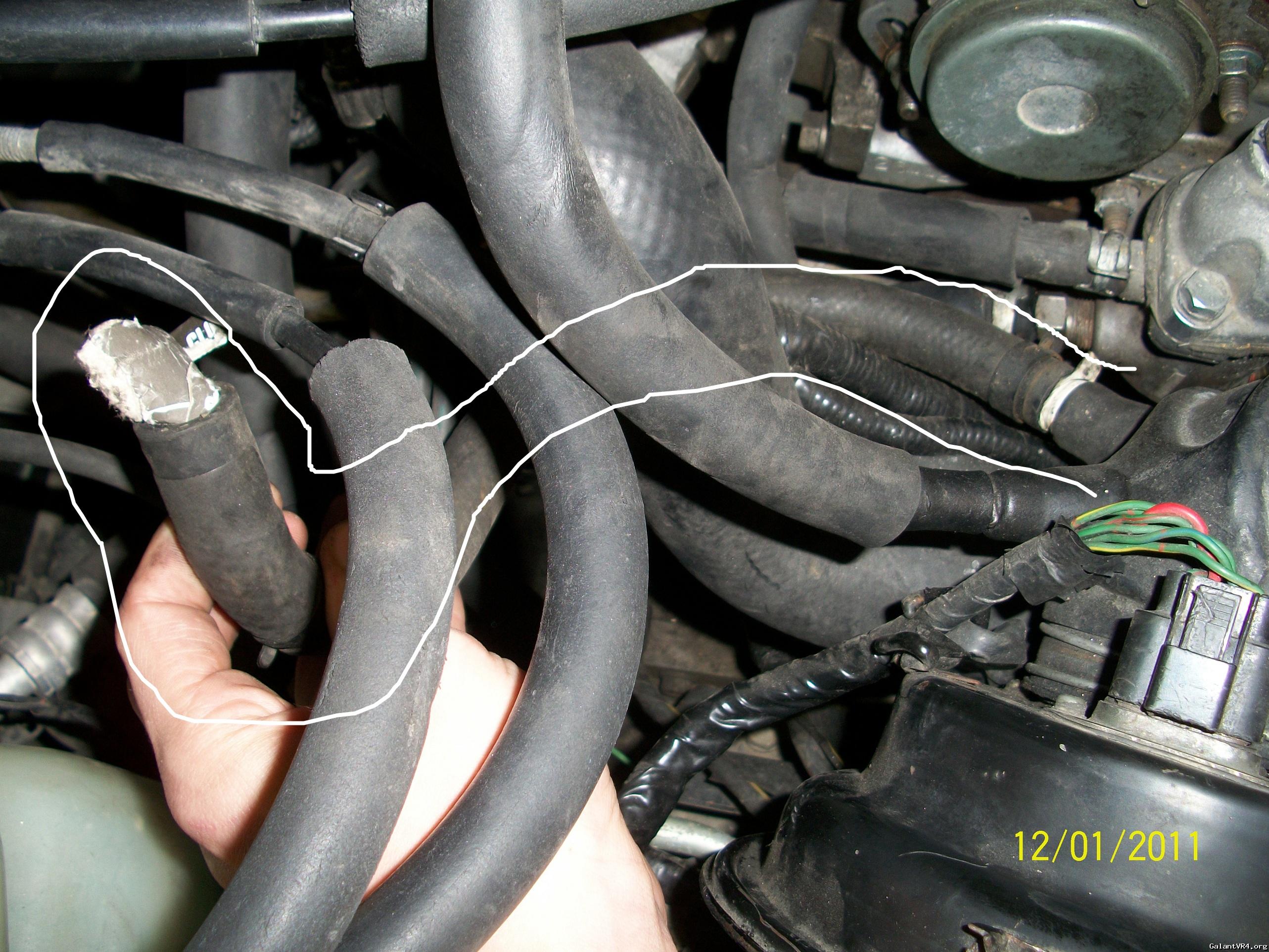

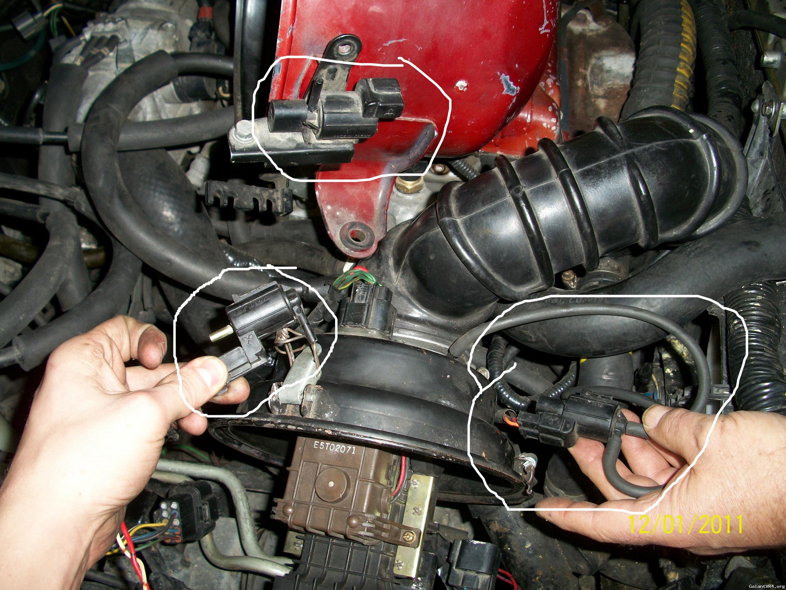

As I'm looking through that tech website, which is really helpful by the way, i see that my BCS is not hooked up to any sort of hoses? It plugs in but has no hoses coming off either end.

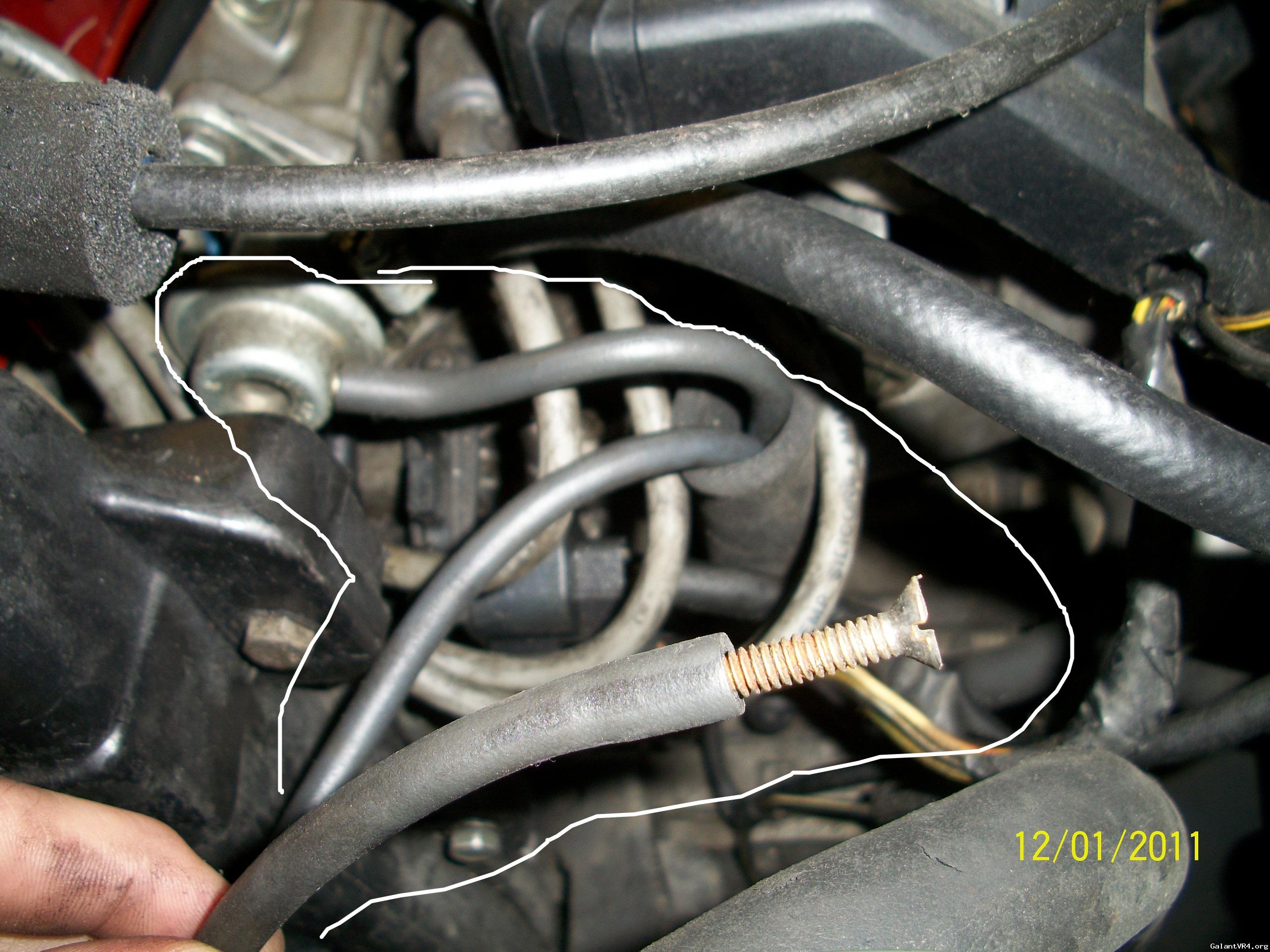

also, off of the Fuel Pressure Regulator, theres a hose that's attached, and in that same bundle theres another hose that comes out that is just plugged?

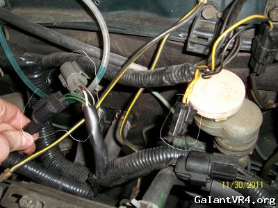

There's a wire off my intake? that appears to be plugged with paper, and the side attached to the intake? is shittly done also.
This one's a little harder to see. I'm not sure what this is, but it comes off one of the solenoids and it's pretty taped or glued up and an empty spot?
This is just glued off, is there anything that is suppose to go there?
I've checked all the fuses, and they're all good.

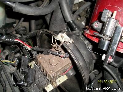

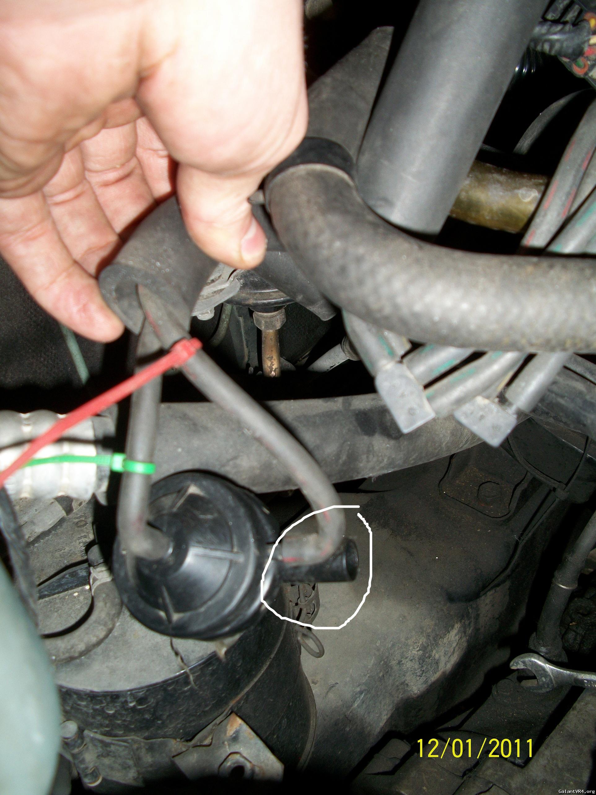

Okay, so theres 3 BCS's I'm guessing. 1 is wired in what looks like correctly, and was not connected.
Theres another one that was plugged into something else, with no tubes coming off of it.

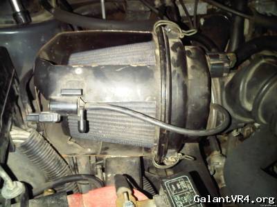

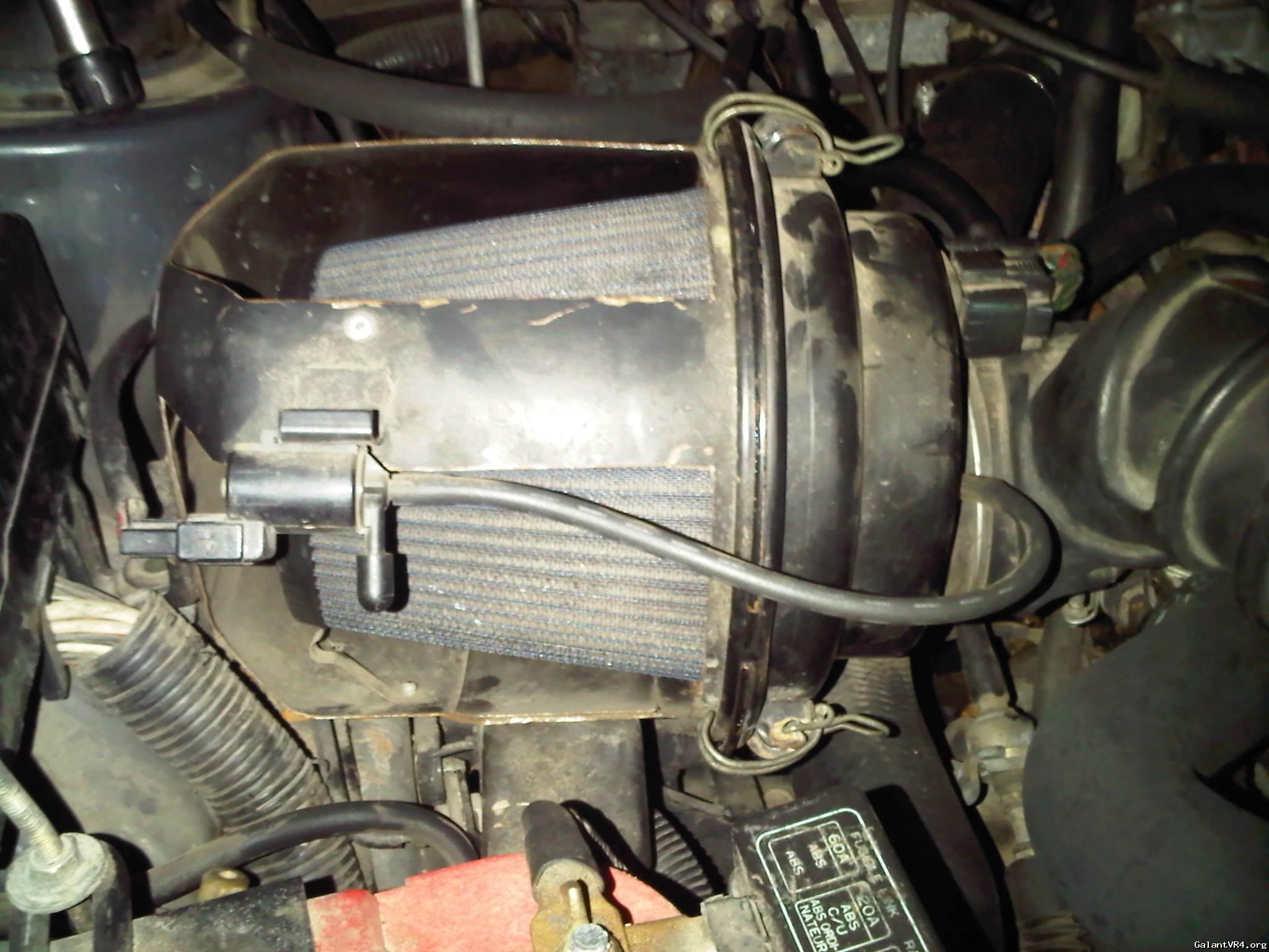

and there was a third one on the aircan itself that was plugged in with no lines off of it either.

I stepped out to snag a couple pictures under the hood of 464/1000 for you, but it was raining and my wife pulled up, distracted me, and I forgot to grab shots of the alternator and headlight relays you're missing from that underhood panel. The alternator is a larger, square relay and the headlight is slightly smaller and more rectangular. You know, in case you have that sort of thing lying around. Should be fairly common replacements. 5-finger discount at the pick-a-part or a couple bucks at the local Autozone/NAPA. The fusible link in the top right corner of the panel is a 60A unit. Fairly beefy.
I recently had the headlight relay sh*t the bed and had to replace it. Only pictures I got are the ones used in the GBXM article on DIY: Electrical Spares Kit (hat tip to my good friend toybreaker)
On to pictures: (These may or may not be correct, but 464/1000 seems to run fine like this.) /ubbthreads/images/graemlins/dunno.gif
Solenoid on firewall, viewed from front of car. Two vac lines go into a larger sleeve before heading toward front of car.
2-pin "BCS" solenoid on front of aircan. Clearly pointless, but again, no glaring issues. (And it passes emissions testing.)
Solenoid cluster on firewall side of aircan (looking toward front of car). No idea what these do, to be perfectly honest.

Route a new hose from the driverside (small) port on the top of the intake manifold directly to the fuel regulator.

On that first picture, can you tell me where both those vacuum lines go? I'm missing one of them. From that solenoid.
