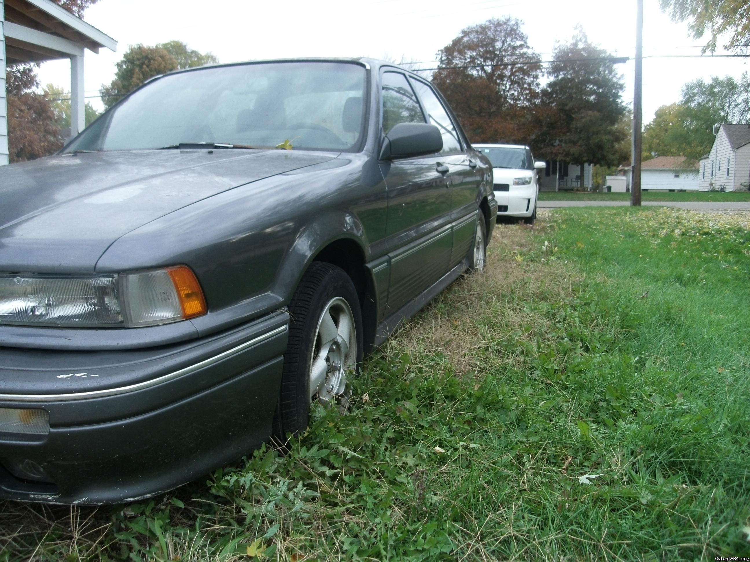

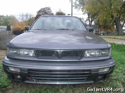

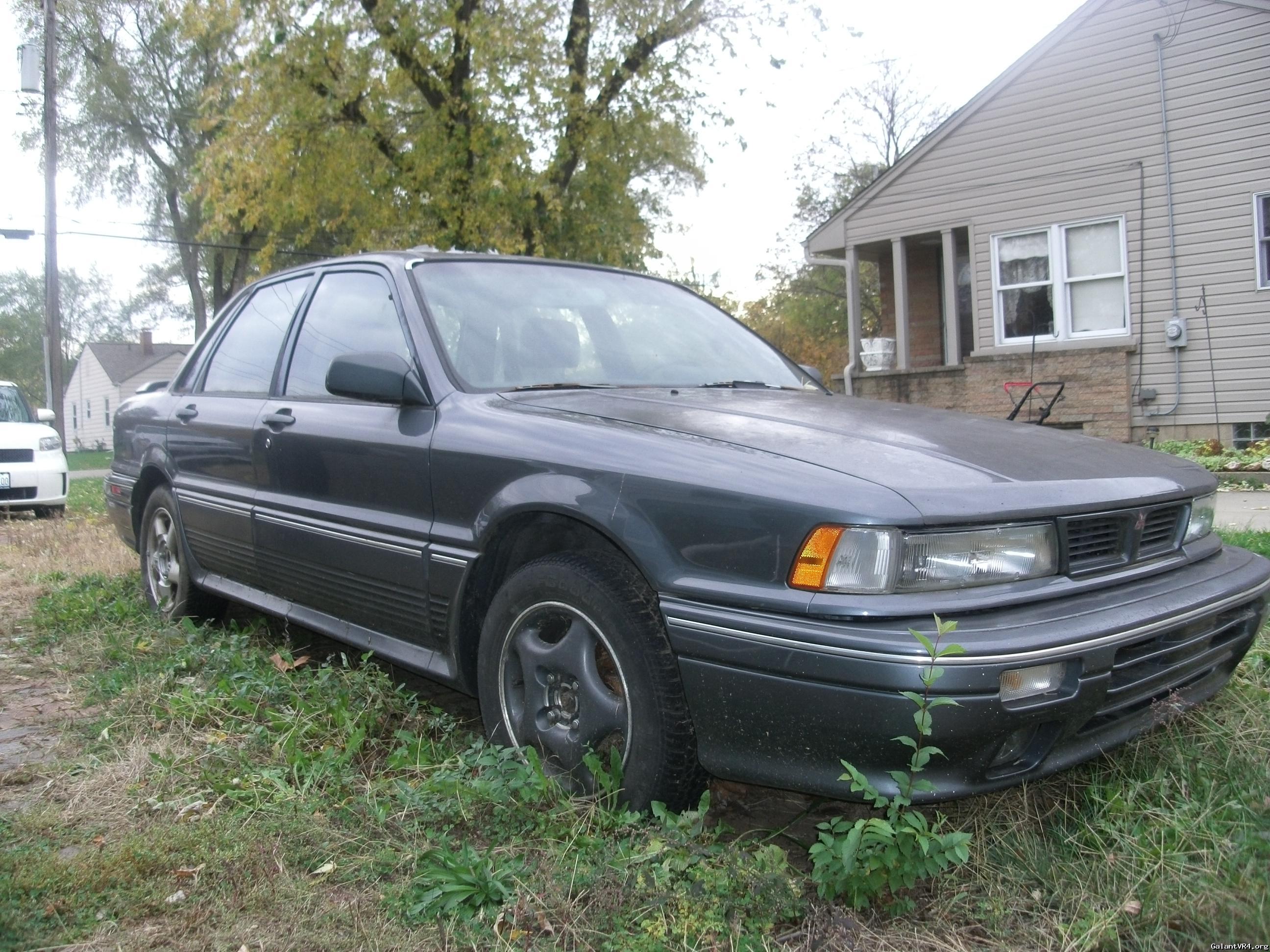

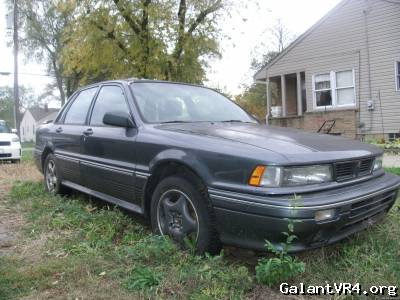

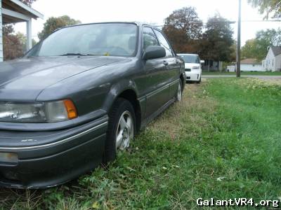

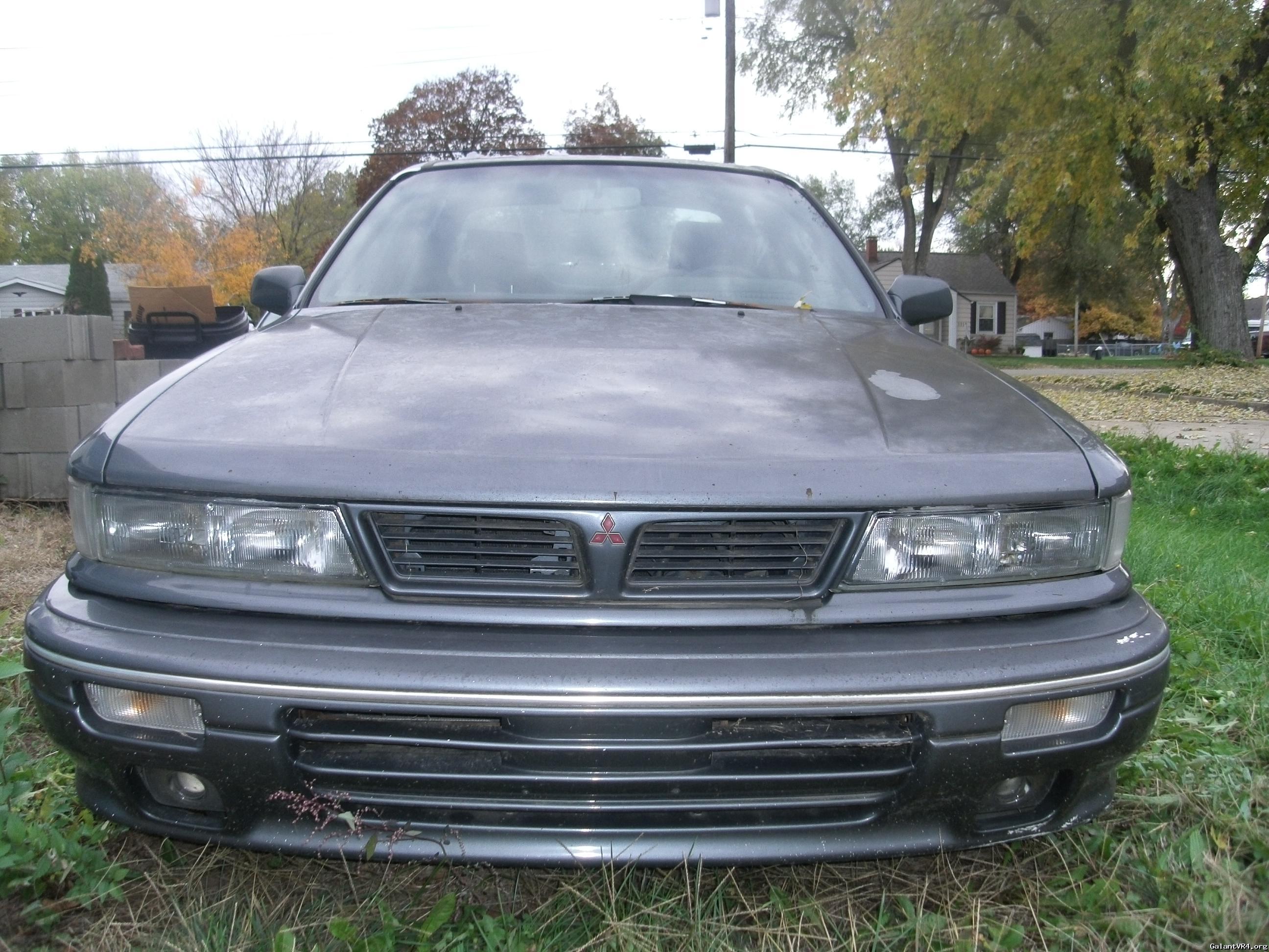

Been in the DSM game for about 8 years now and this is the first GVR4 that I have owned/purchased. After spending the last two years rebuilding my 1993 Talon Tsi AWD I finally got it done about three months ago and have been just browsing the forums and driving the talon. About a month ago I decided that I was going to buy myself a new project to start for this years winter months and why not switch up and build a galant. So, over the past few weeks I started watching the forums and the FB pages for the right deal and wasn't really having any luck until I caught wind that an old DSM friend was selling his 1992. He had owned the car for the past 7 or 8 years and it has been sitting for a lot of that time. He finally decided to throw it up for sale about three weeks ago and it took nearly no time at all for me to be trailering the beast home to take up the empty space that is in the garage for the winter months. Here are a few pics of the current appearance:
