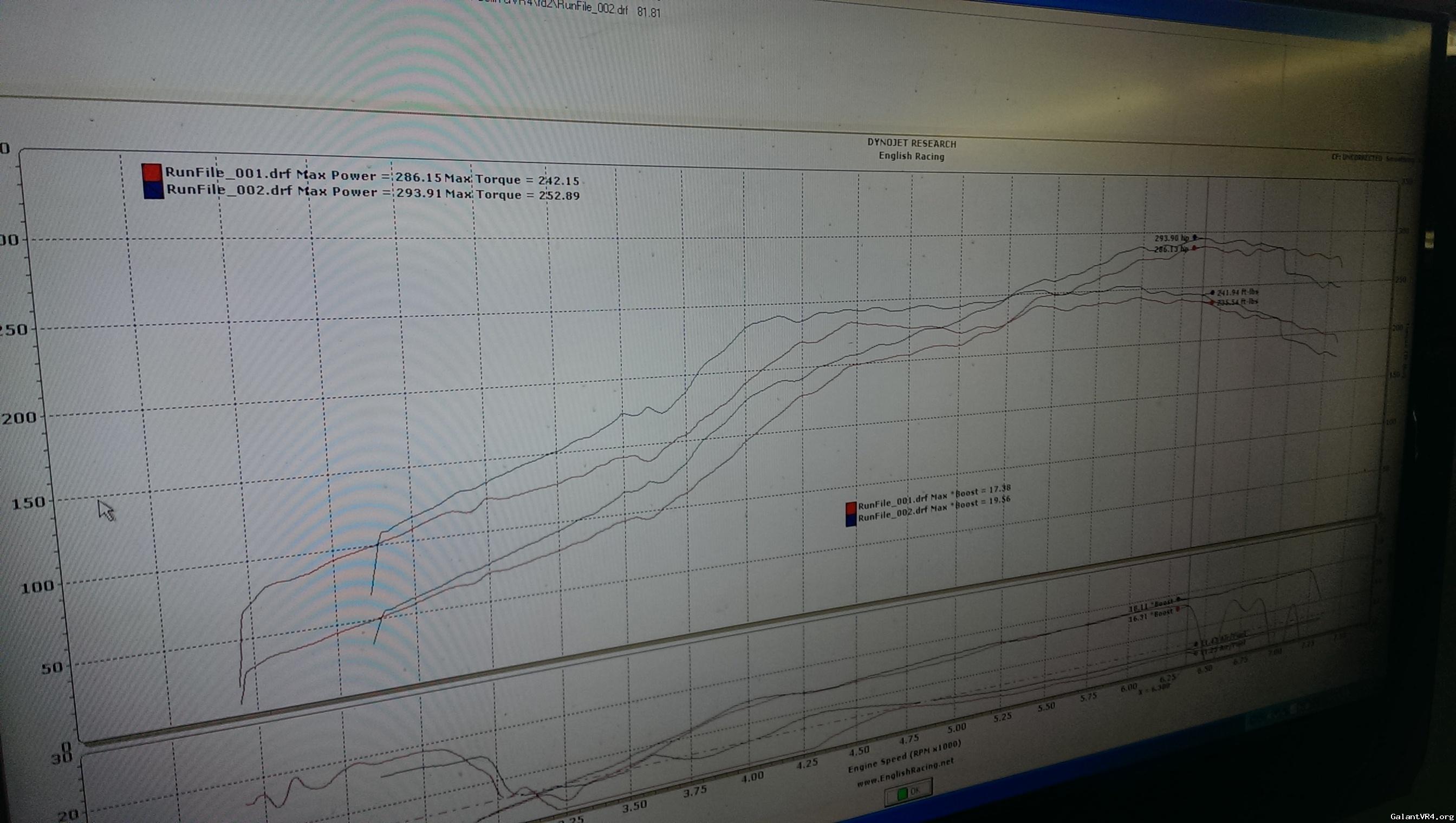

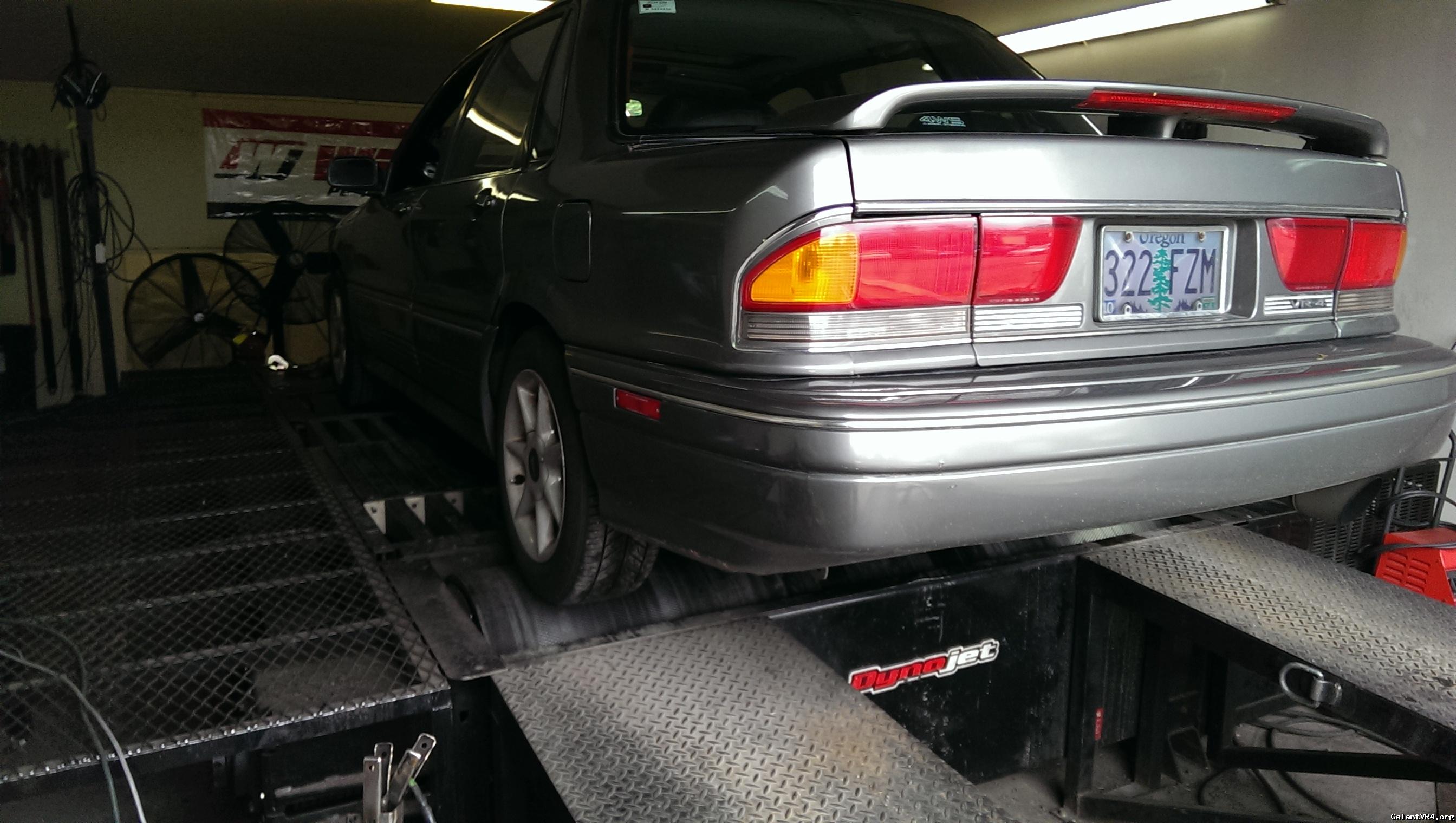

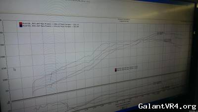

First things first. I took it straight to English Racing for an Innovate Wideband, ETS intercooler, DSMLink v3, and dyno tune. The car made a shade under 300hp @19.7 psi through what I thought at the time was a 20g turbo (more on that later). However, the first sign of things to come reared its ugly head. Lucas explained to me that when the #3 plug came out to get gapped, it took some of the threads on the head out with it. We figured that this meant that the last person to put the plugs in cross-threaded the plug.
However it held compression and ran like an angry honey badger, so I was happy. These were the halcyon days, two weeks of boosted bliss that almost had me convinced that I was in the clear.

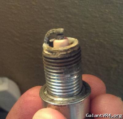

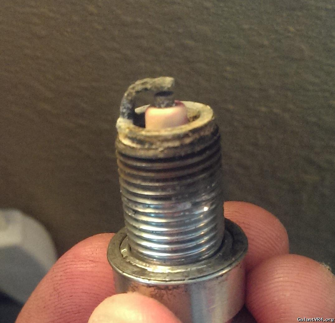

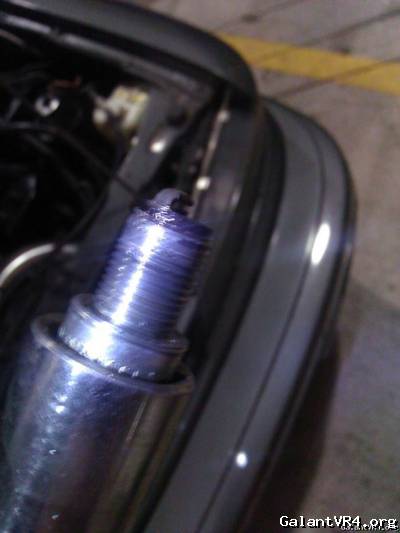

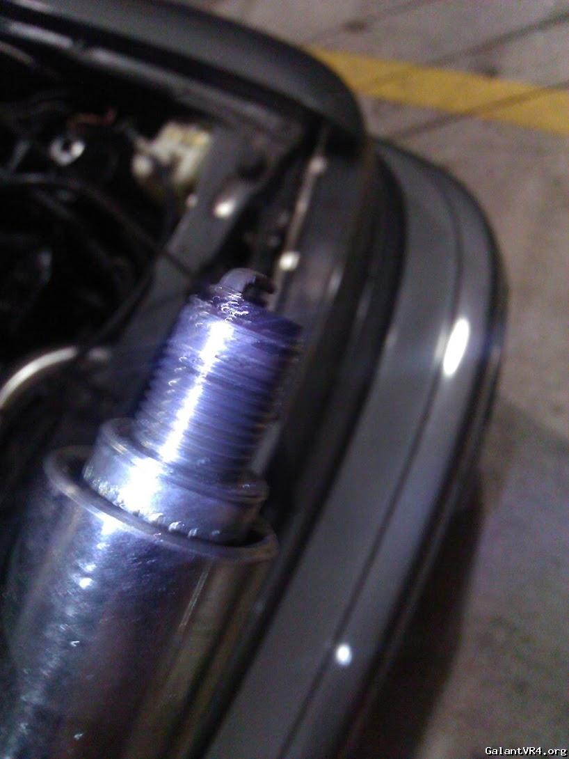

Then… well I had to accept when the plug came out with metal on the threads that I would eventually need a new head. I checked the records (of which the previous owner meticulously kept) and it looked like I was probably about a year from hitting the replace-the-timing belt window. In fact I could have gone a few years since the belt was the Kevlar one from Greddy and appeared in good condition. But I also knew that things can happen, so when I started to see knock at higher RPM’s, I figured… Well I figured something ugly was happening.

Fast-forward to that fateful day I pulled the #3 plug and saw the state it was in. I had plans to hunt in Bend, and since the scariest part of the process was getting the old plug out, I tossed a brand new plug in and was on my way. I knew something was wrong, but I figured I could get through the weekend. Halfway to Bend (2 hours into the drive), I was going up a hill and at 10psi, the car fell flat on its face. I turned around and called Evan.
This was it. The head was coming off.

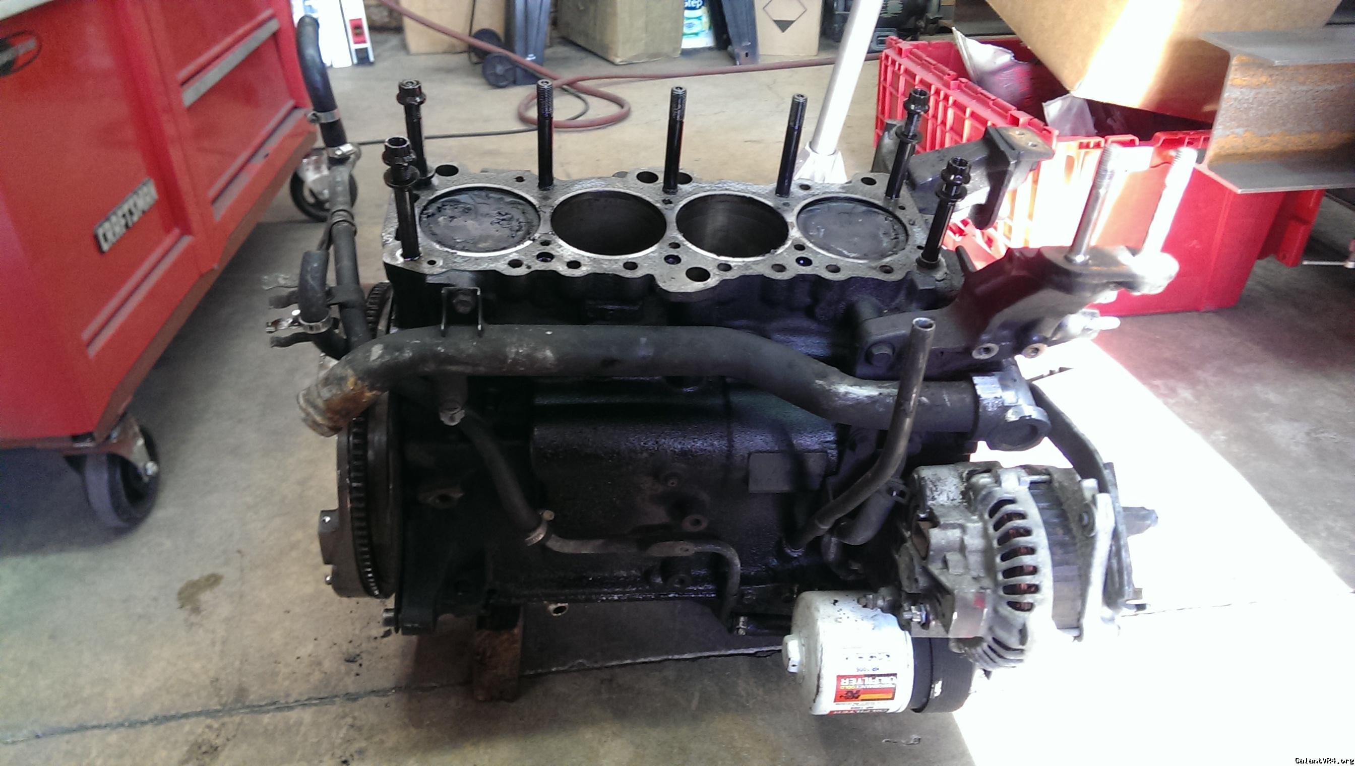

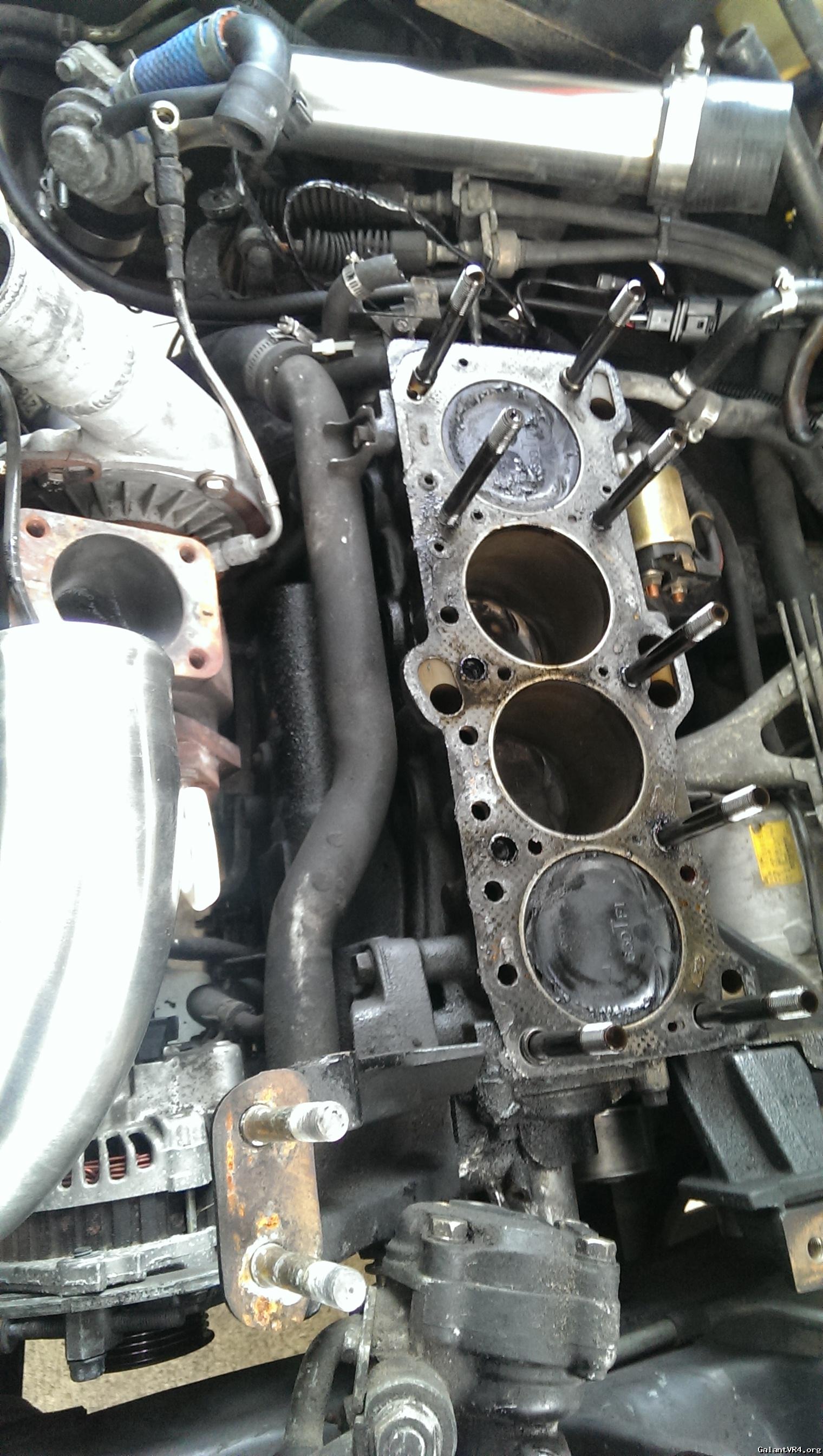

Evan got the old head off and I got a phonecall.

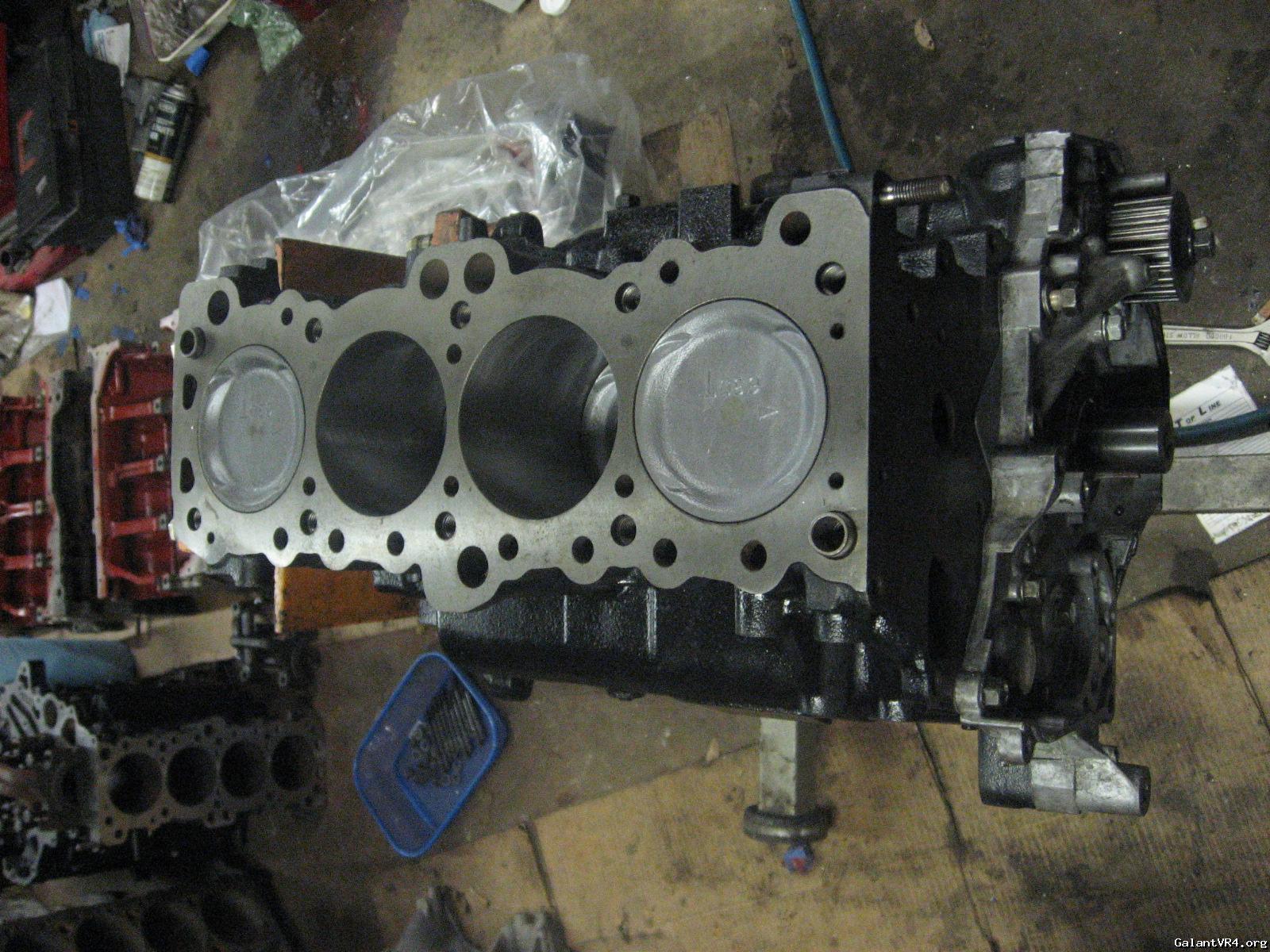

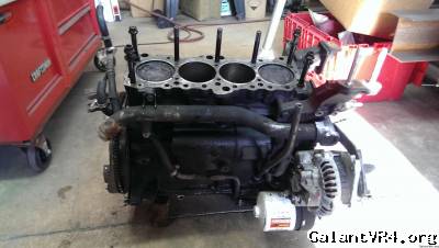

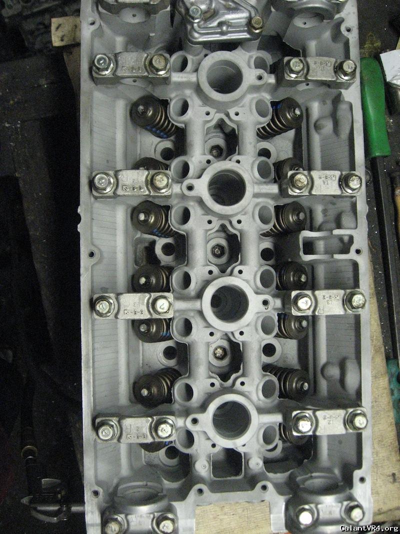

The #3 cylinder was scorched and warped. We were going to need a new motor. At time I was in an airport headed to China. I got Dale on the phone and asked him how long it would take to get a block, too.
Out with the old
In with the new

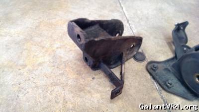

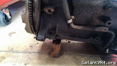

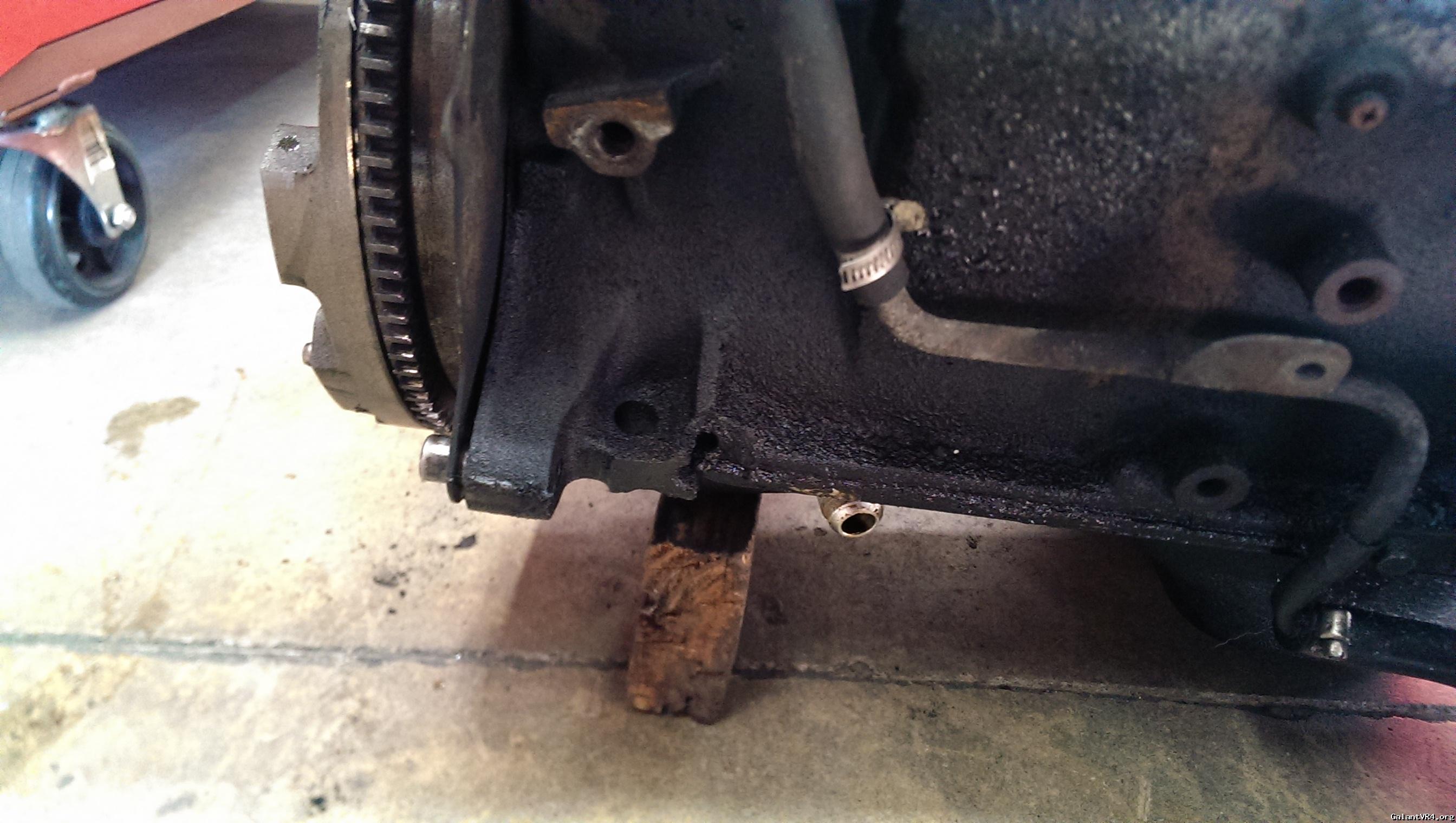

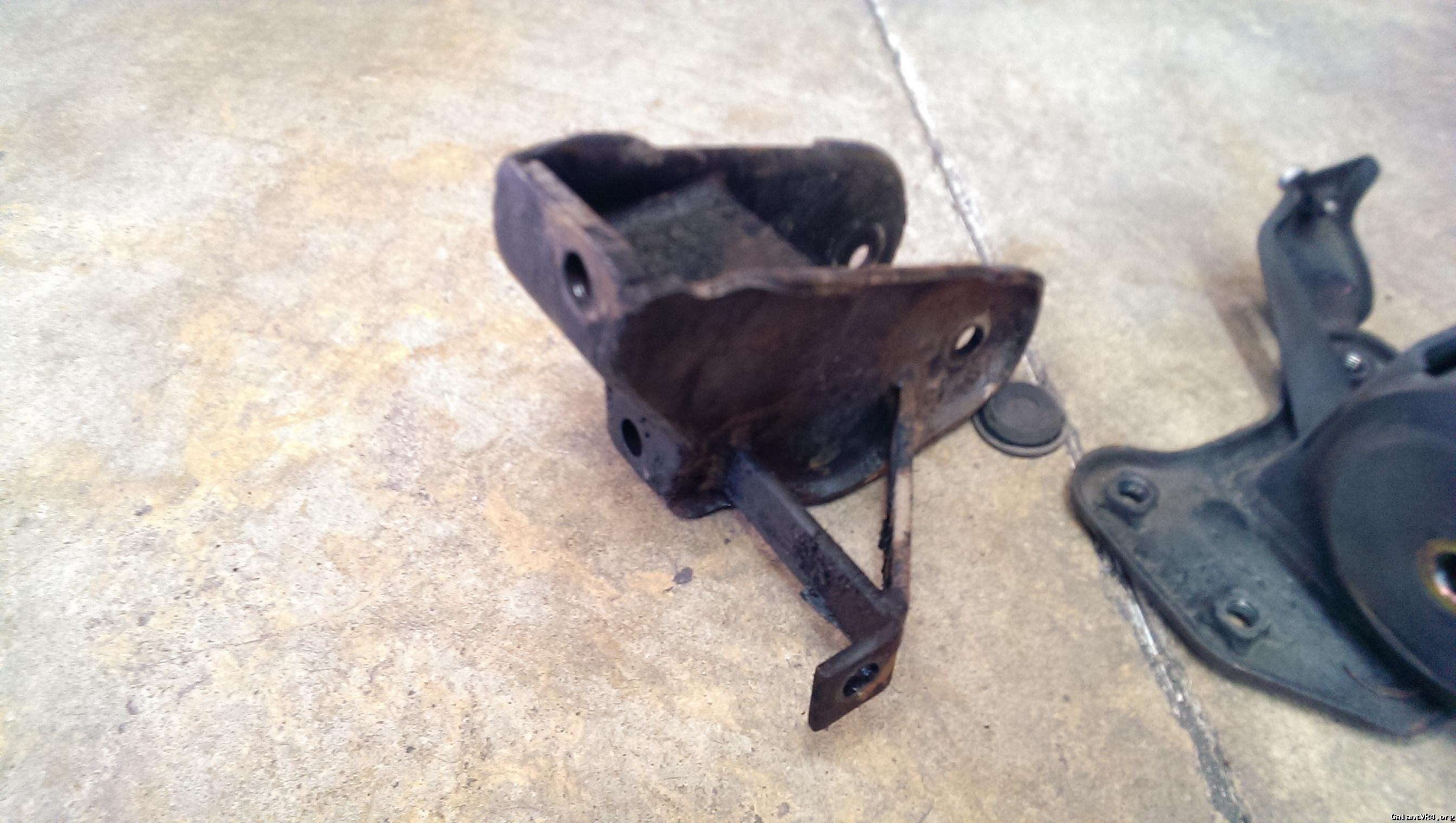

Turns out the old block had already been through the ringer and couldn’t be reused as a core. Props to whoever fabricated the transmission mount in lieu of the broken stock mount.

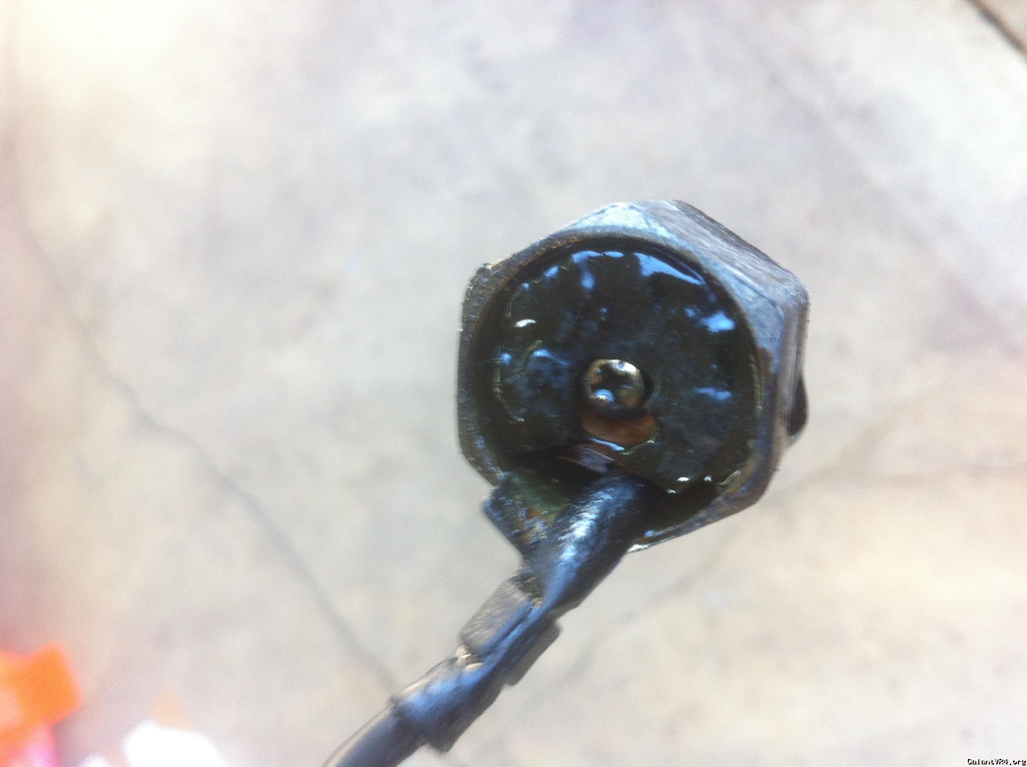

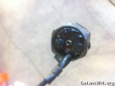

Knock sensor? More like a Not Sensor

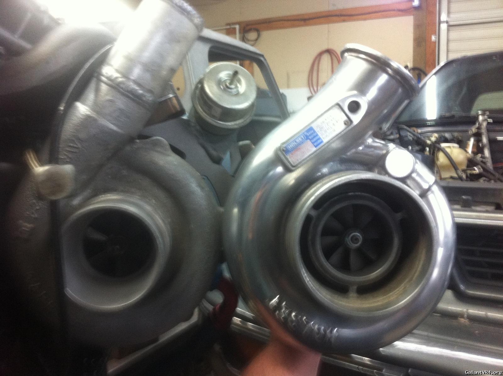

And that 20g the PO thought he had? Not quite…
That’s my T3-T04 on the left (and Evan’s HX35 on the right). Similar boost characteristics to a 20g, but certainly not a 20g.

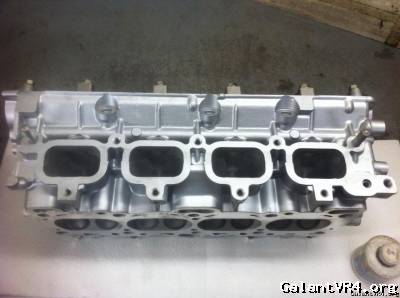

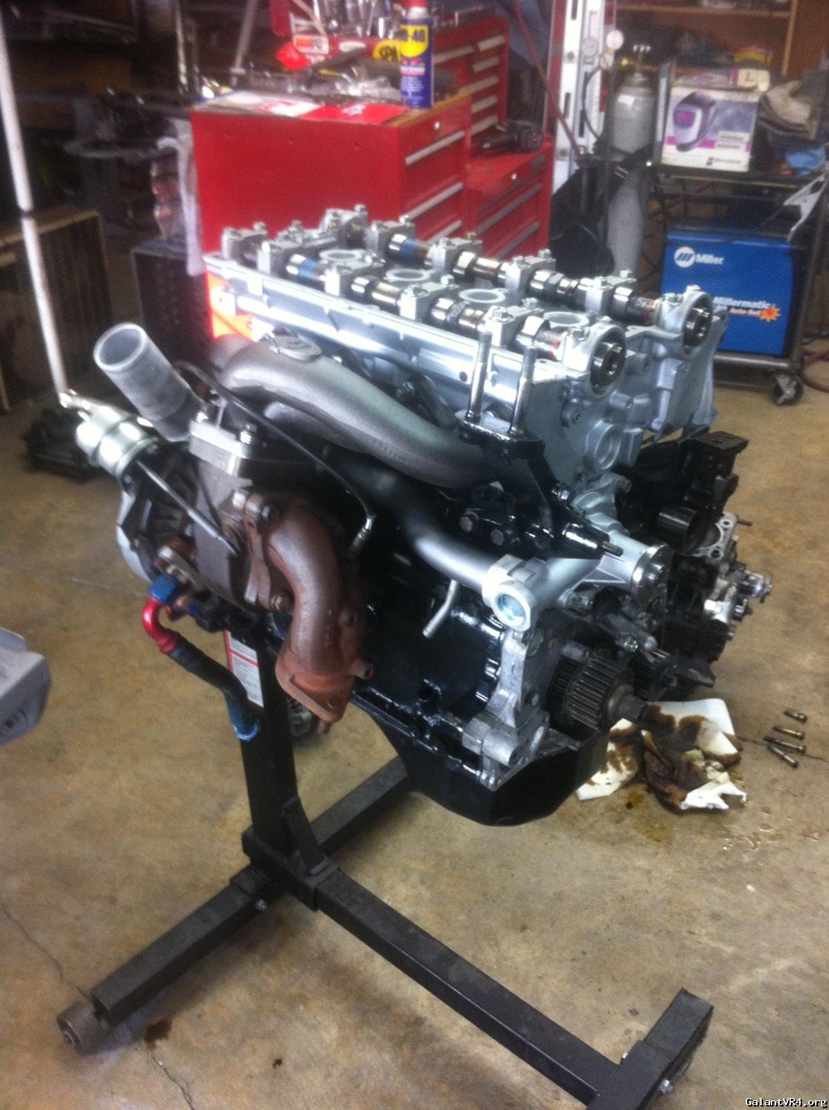

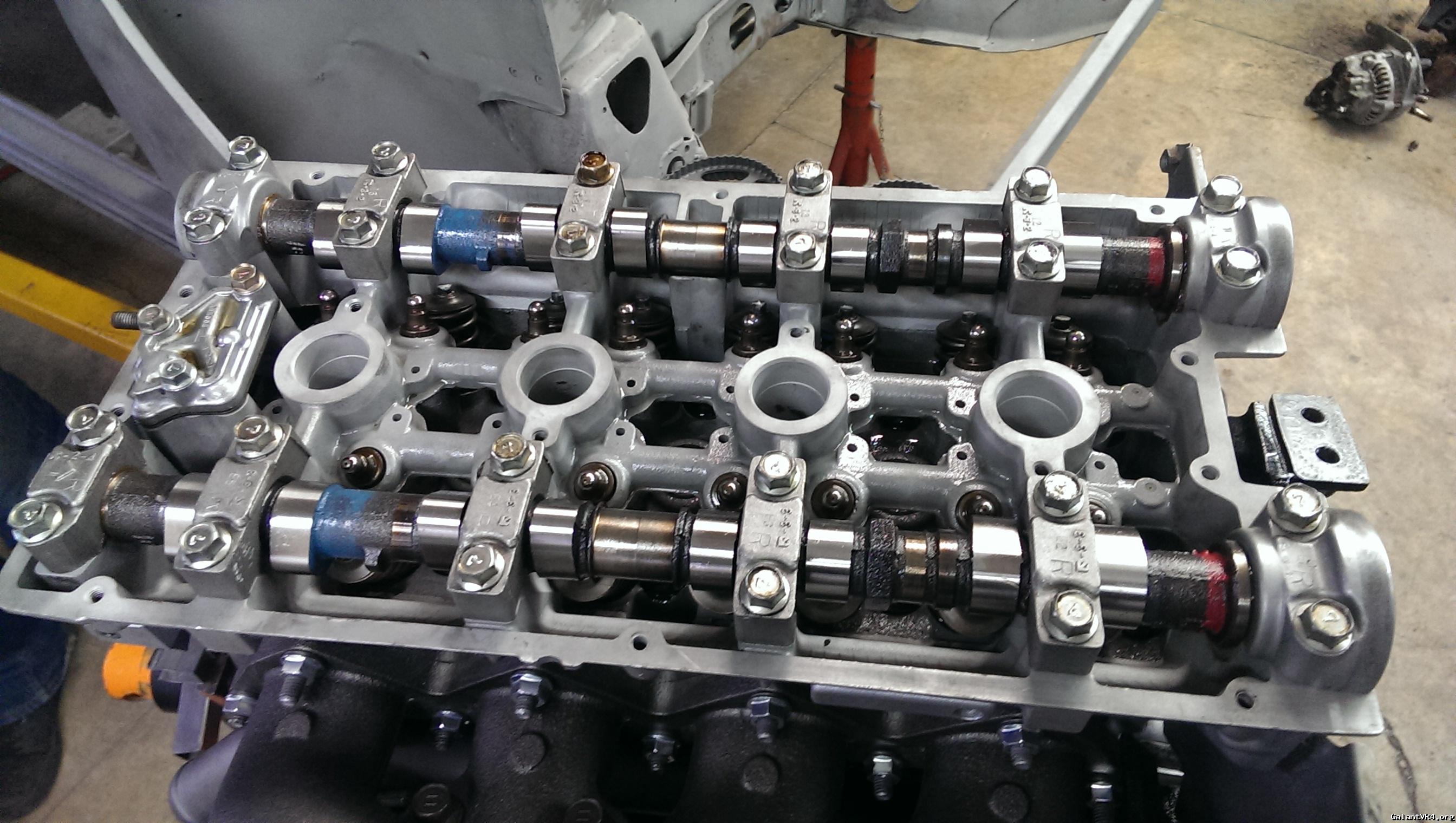

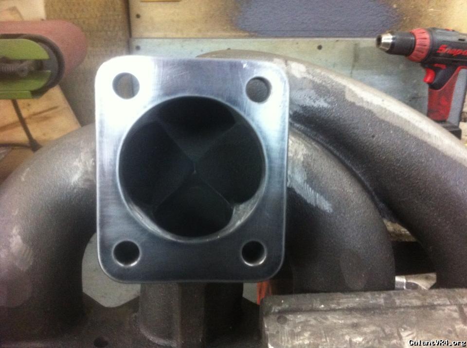

And now the magic starts. Since I was getting the whole tourist package, it didn’t seem right to put it all back together without adding a little something. So I got a pair of regrind 264’s from Delta Cam.

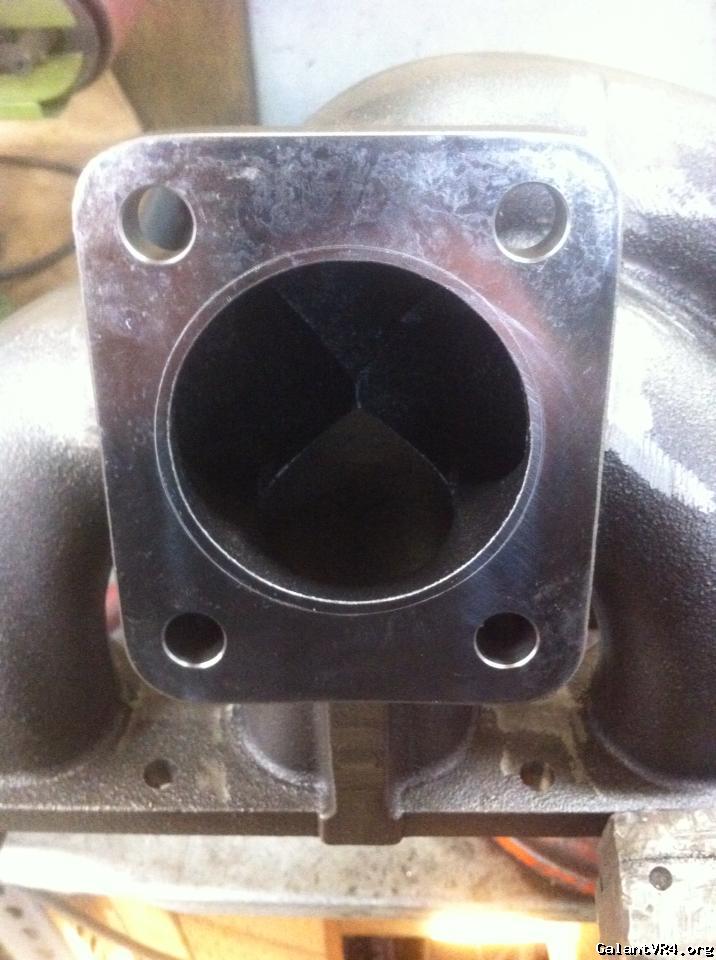

And that Forced Performance manifold is on sale? Why I’d be crazy NOT to buy it!!!

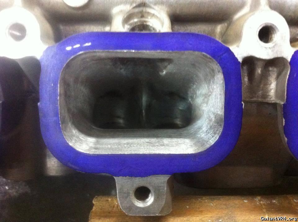

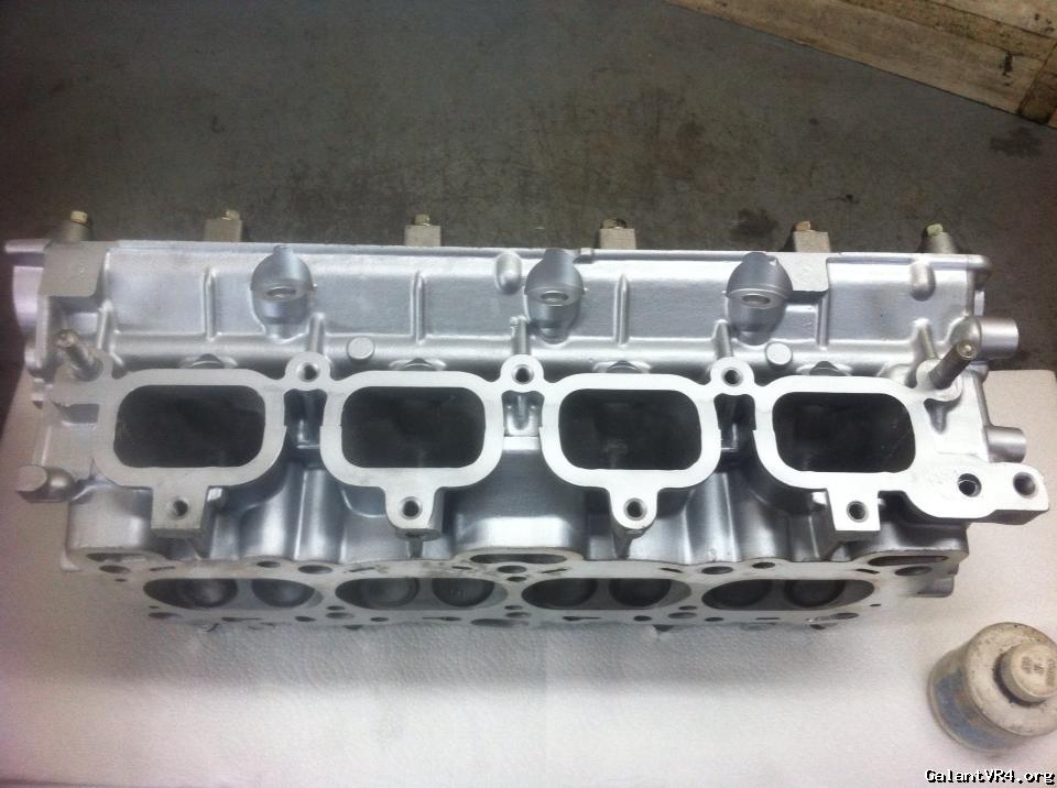

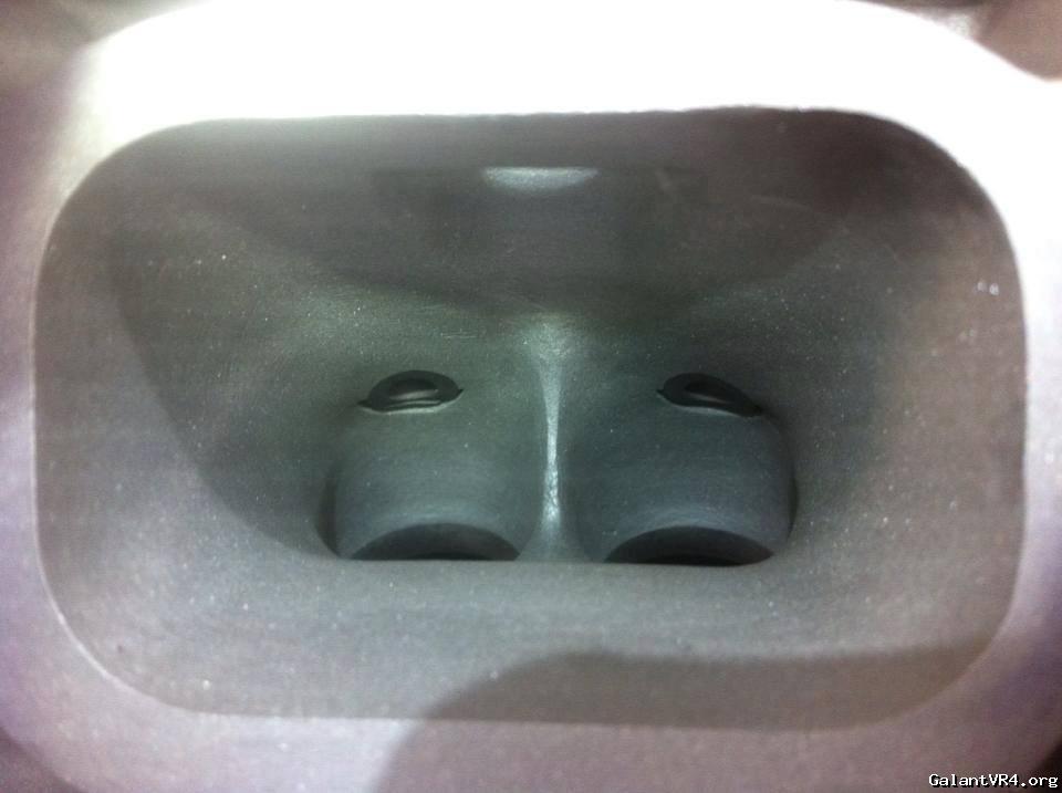

And why not get everything ported while it’s all out? Again, great work by Evan.
Let’s get started!

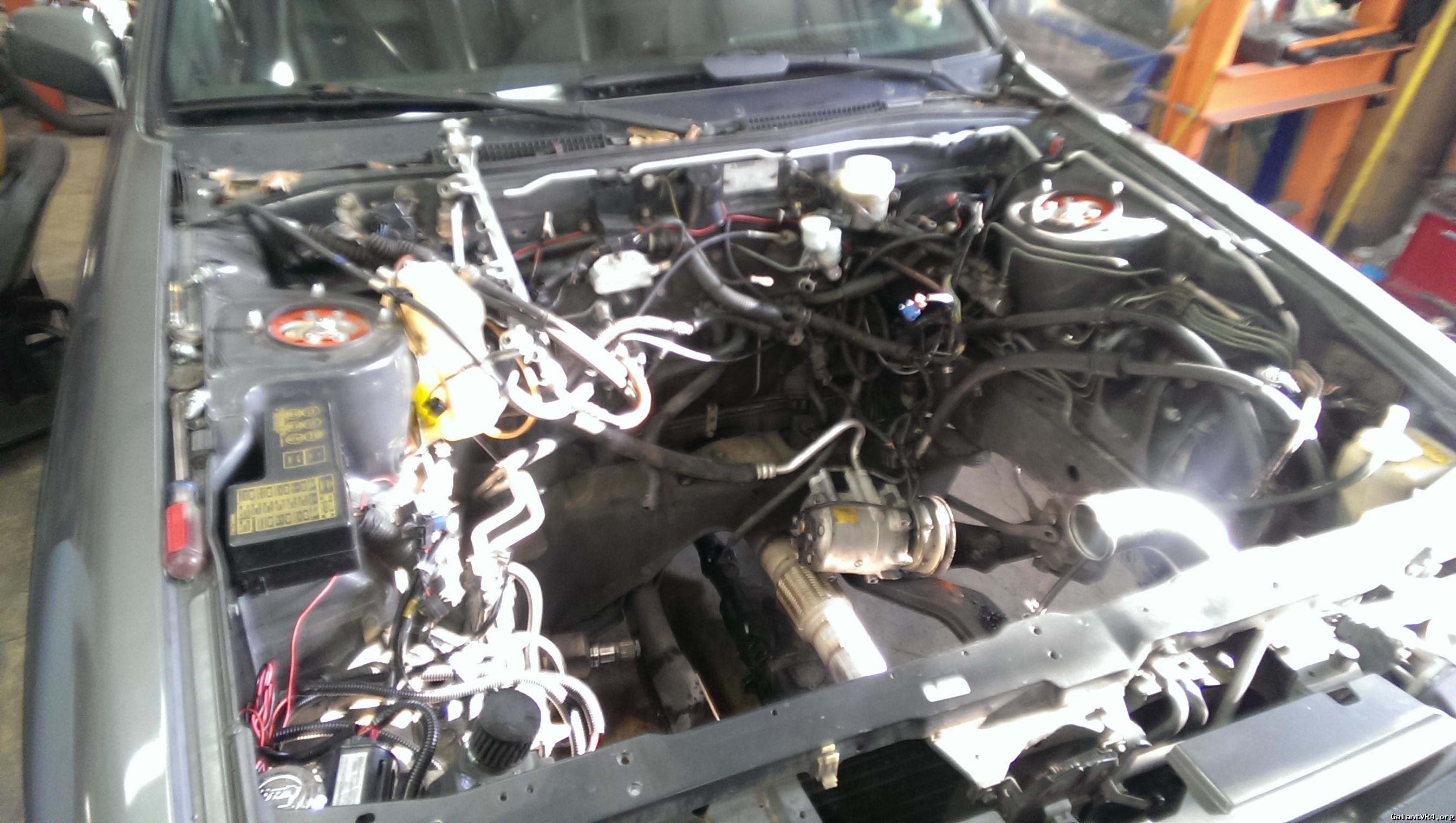

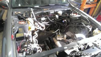

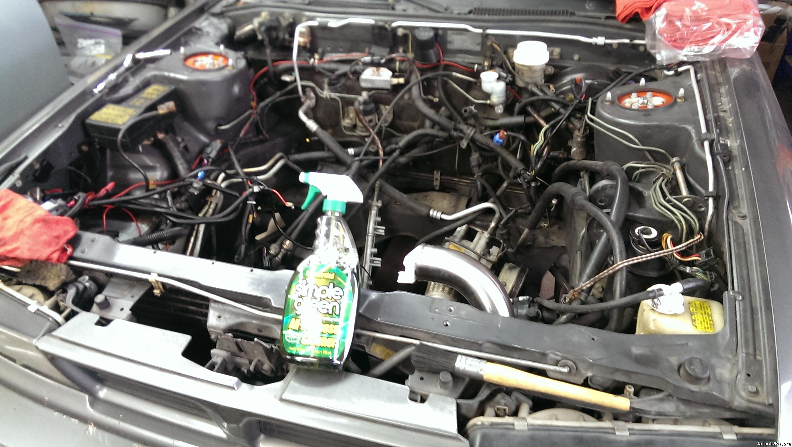

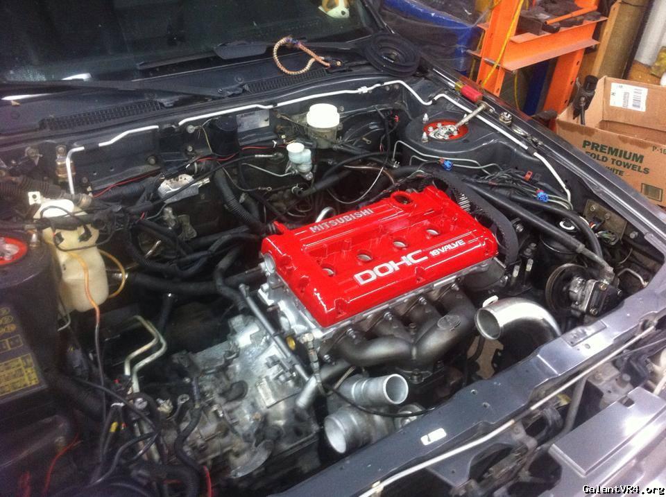

And this is the only time you can really clean the engine bay out.

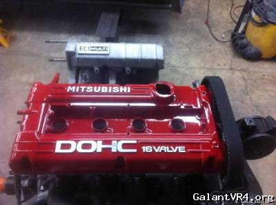

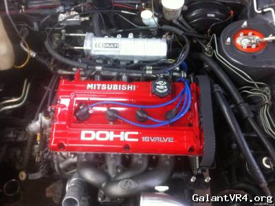

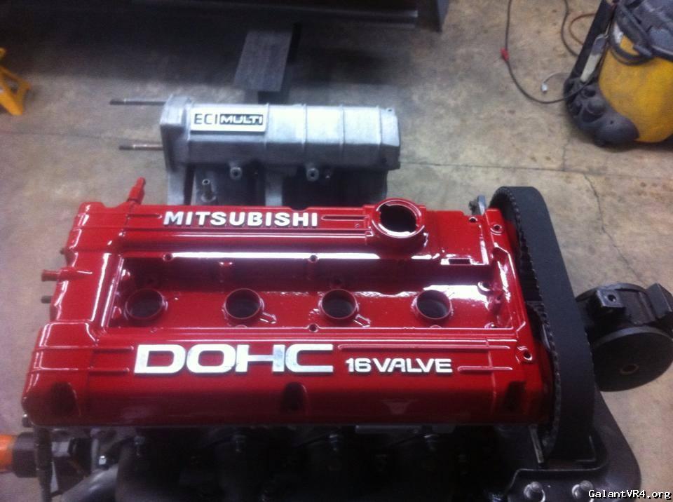

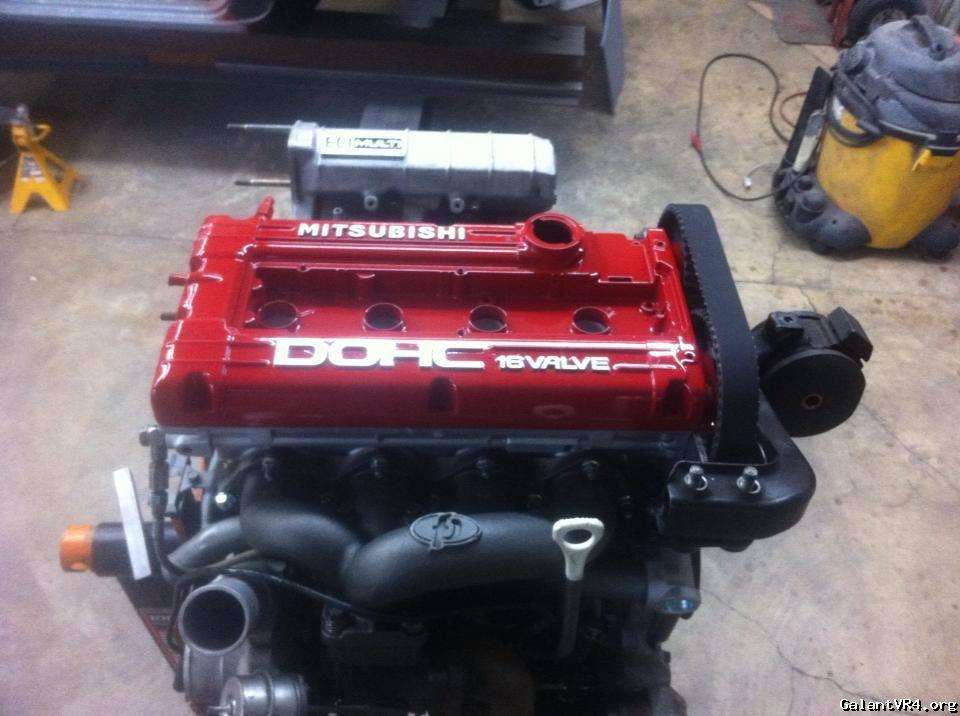

Evan decided my valve cover could use a refresh as well. He removed the baffles and gave it some paint.

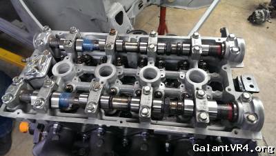

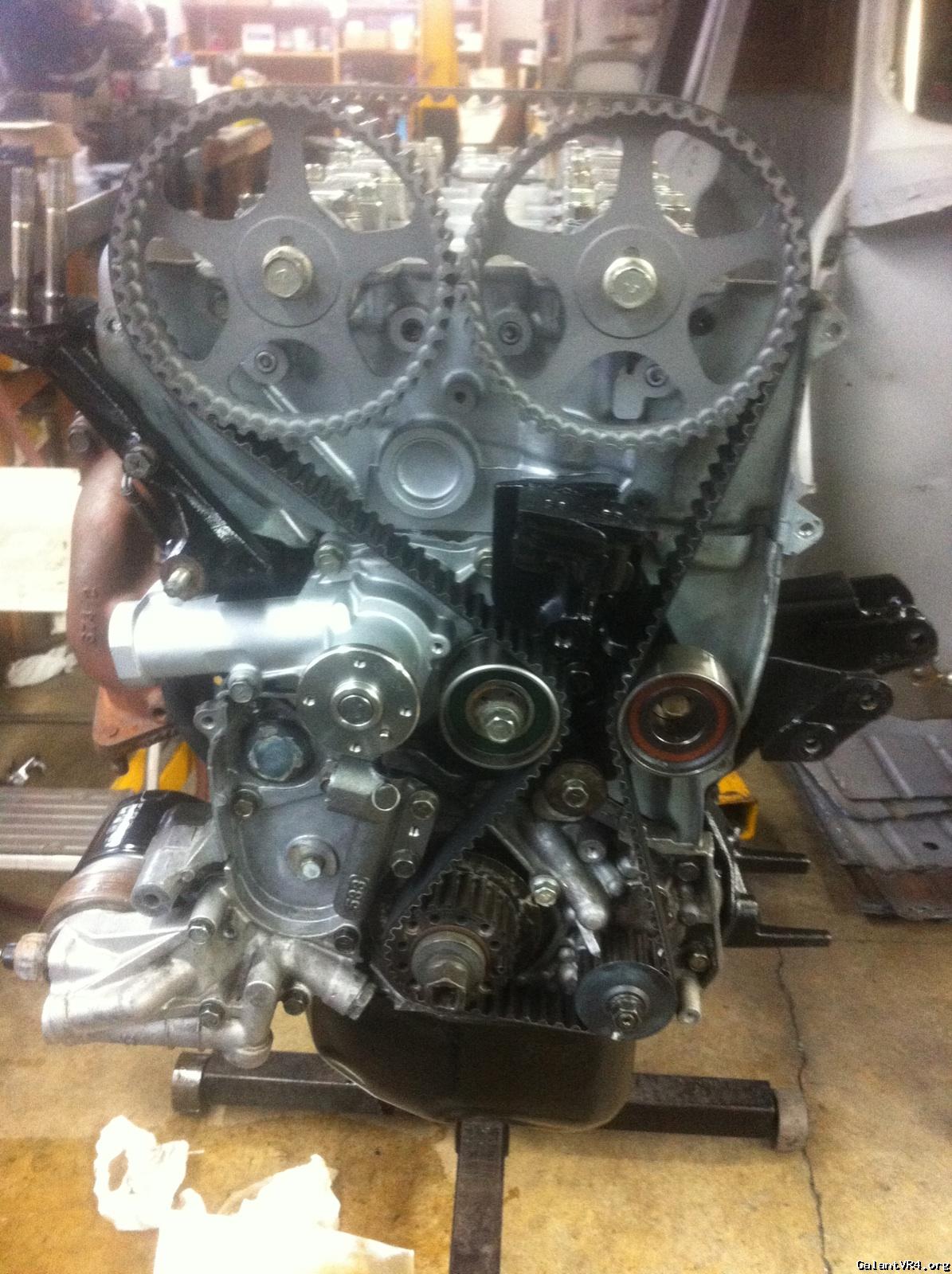

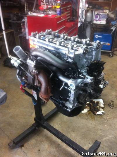

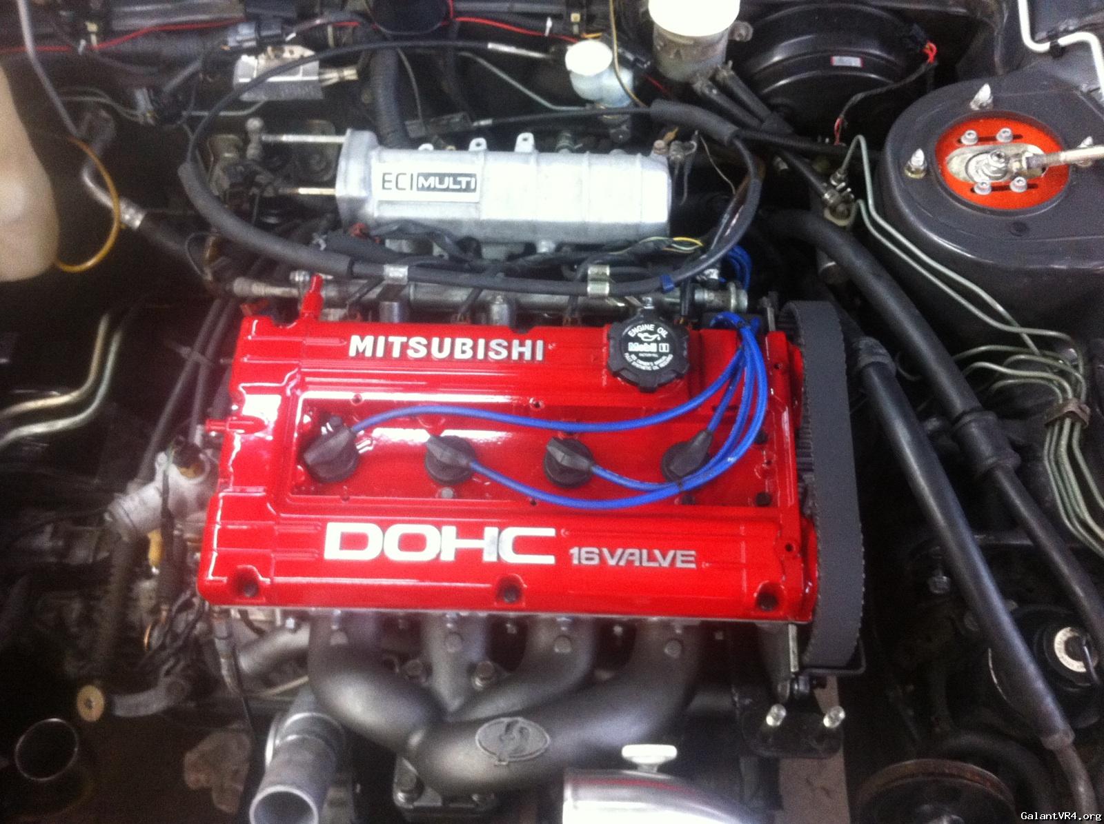

and now it’s all ready to go in

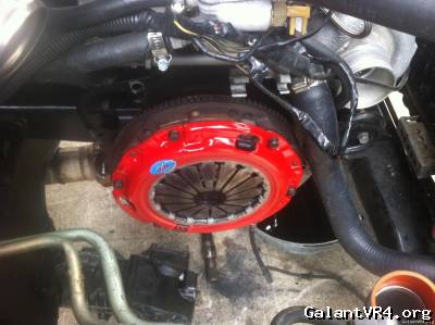

…but first…
ok. Now we’re ready
So after all of this, what was the problem? Well we sent off the injectors to get cleaned and calibrated and FIC informed us that the #3 injector was, for lack of a better word, fucked. Seems as though it was just dumping gas into the cylinder without really spraying it. Now it’s all starting to make sense. The fouled plug. The threads. Link being tuned for 850cc injectors. #3 was running hot as hell. The plug wasn’t cross-threaded; it was fused! The heat is what wrecked the cylinder and caused the glazing on the piston. Costly problem, to be sure, but in the end, I’ve got a new motor with new bits and 543 is alive once again.

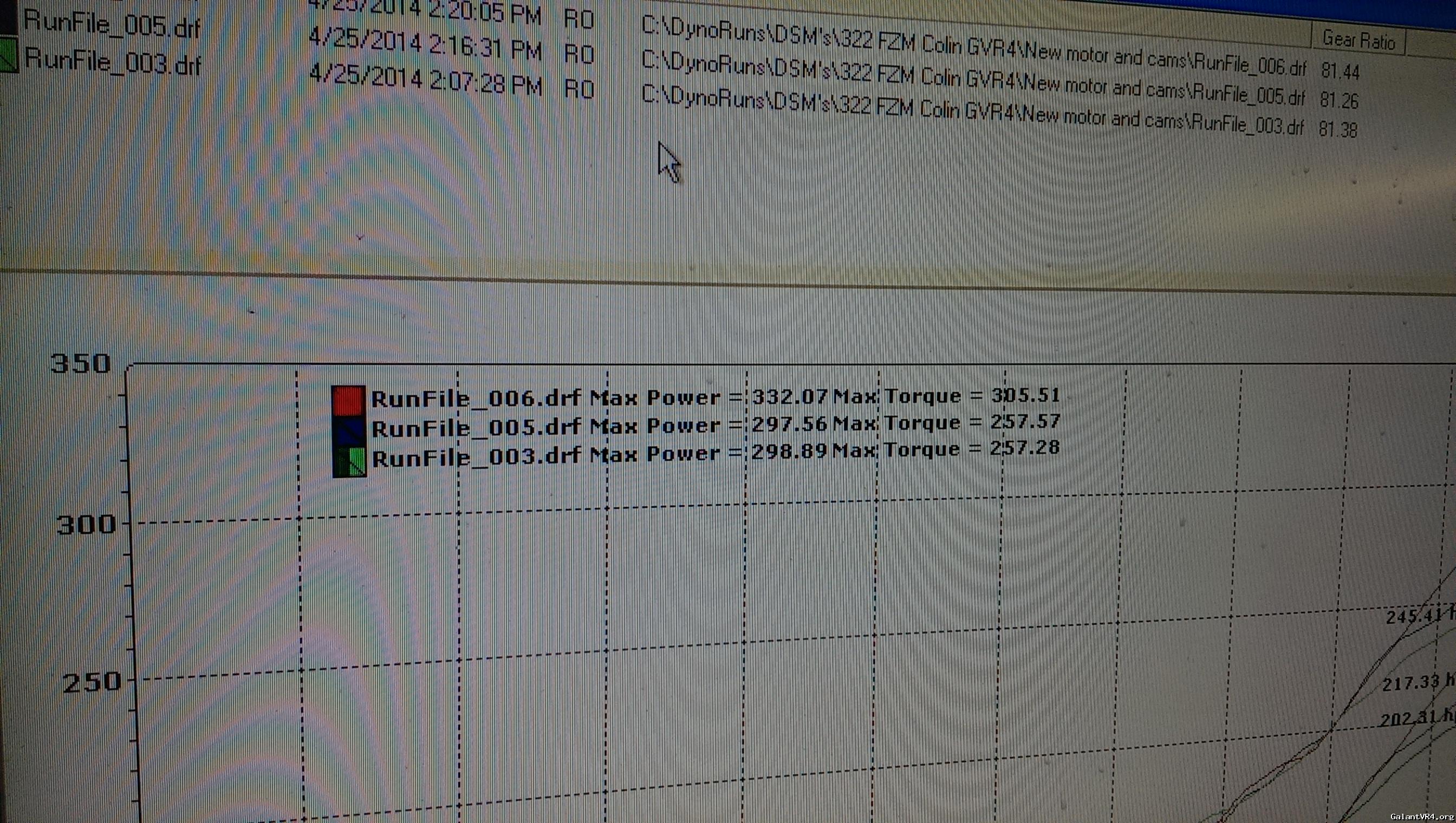

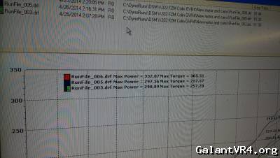

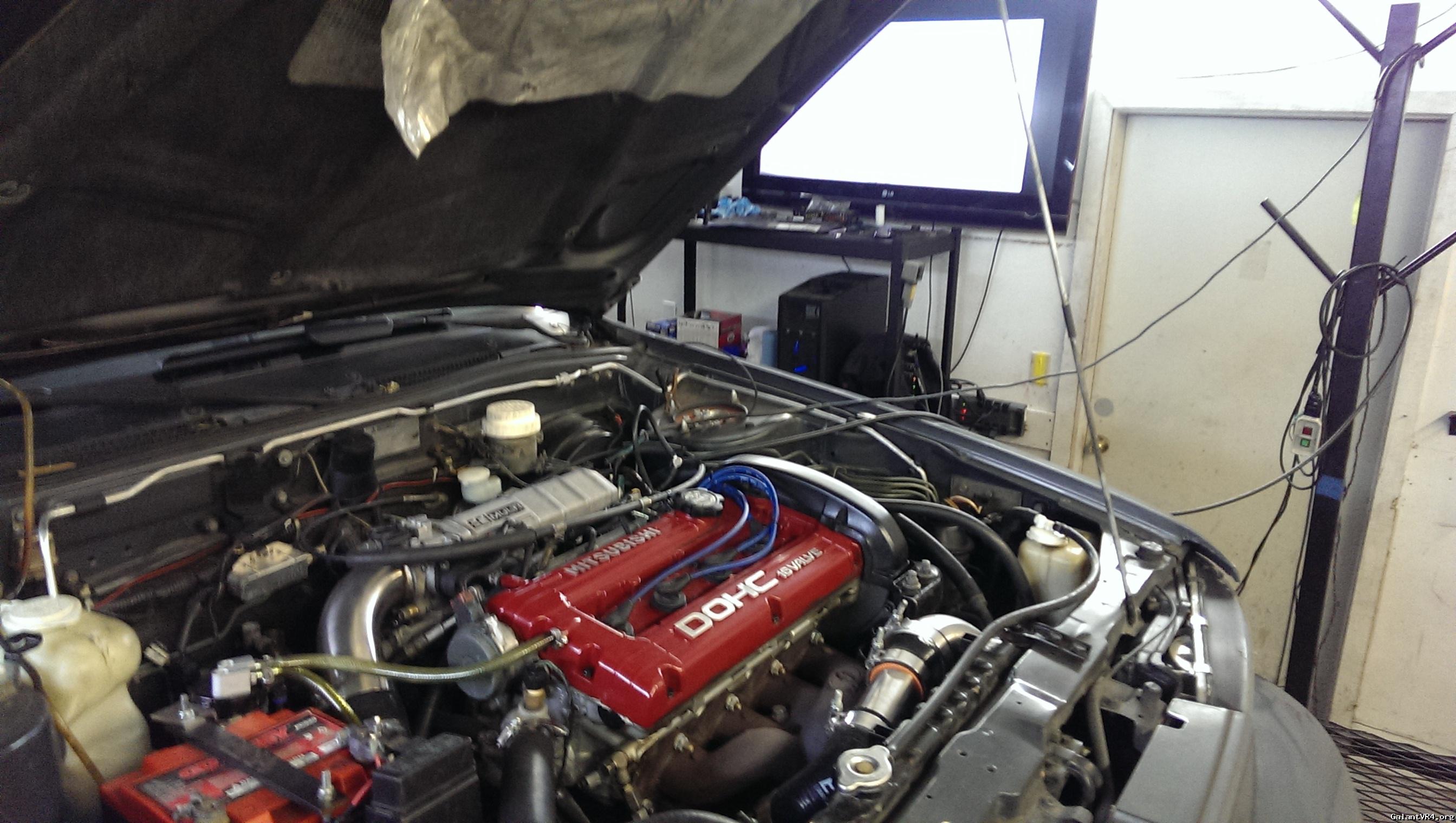

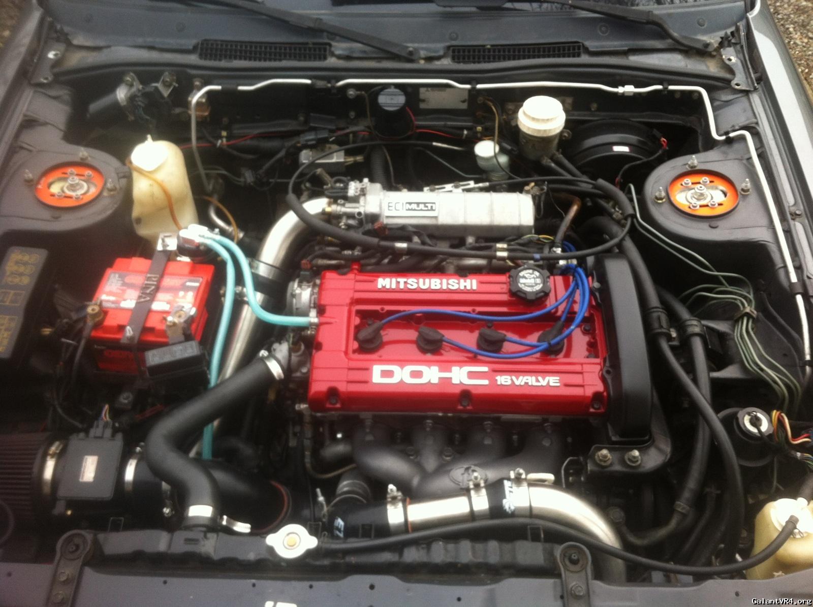

It’s rolling on a street tune right now until it can get on the dyno @ English in a few weeks. I’ll post the results here once I have them! For now, the vitals:

63DT 1g pistons
.25mm/.010 rods
.25mm/.010 mains
King bearings
rings gapped for boost (.22 top/.20 second)

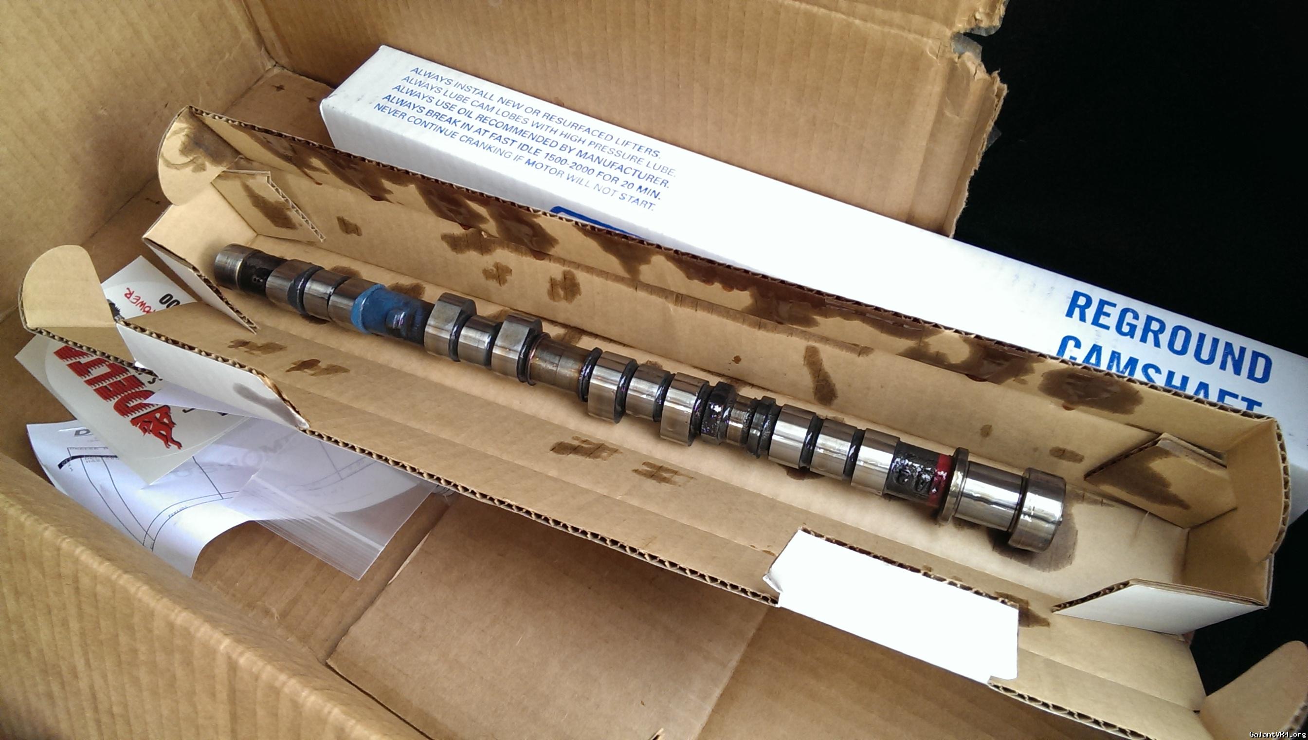

264/264 Delta cam regrinds

Greddy Kevlar timing belt

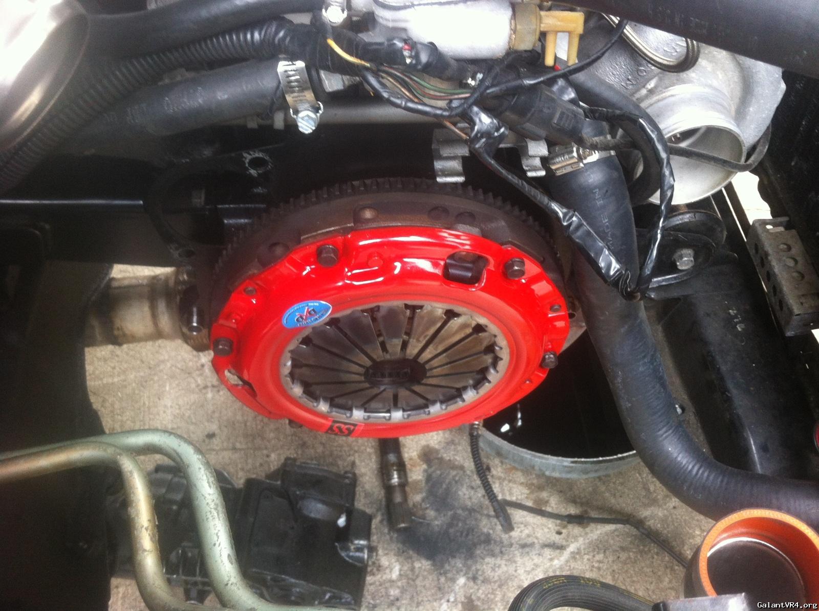

Southbend clutch (TZ Kevlar disk/SS-Series 2200# pressure plate)
