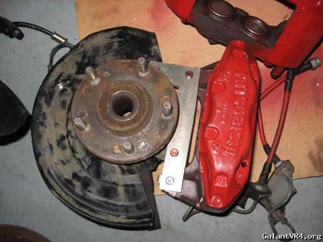

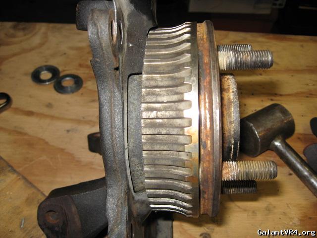

I decided to take the challenge, and remove the stud in my 5 lug knuckle with abs. The knucle has the abs hub,that makes it impossible to remove the stud, without removing the bearings or getting rid of the hub that's in the way.

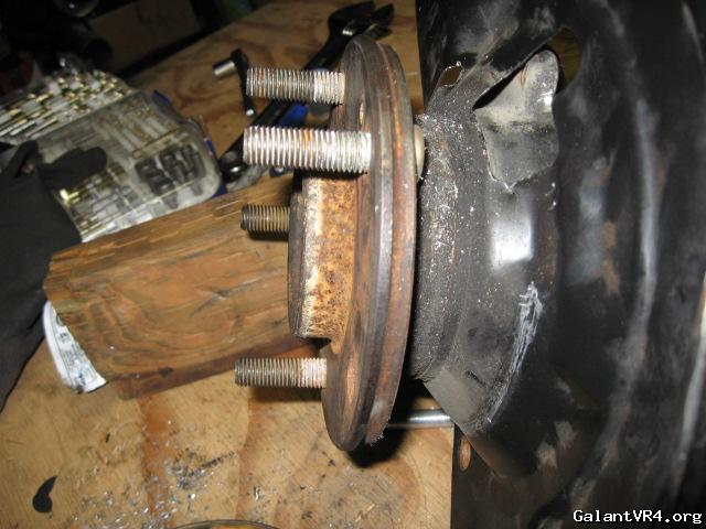

I put the studs resting in a piece of wood 4by6,to keep it stable, this was very helpful because the cut off wheels brake with just a little twist.

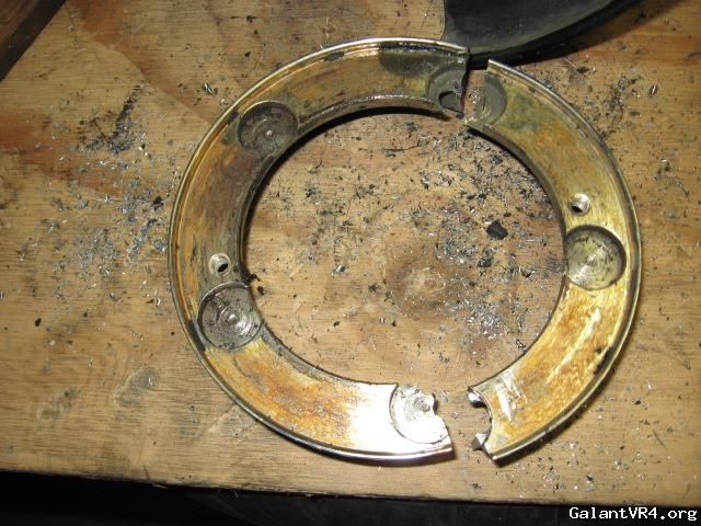

Cut a groove all the way thru in one of the teeth that's right above one of the studs, as it will have less material to cut.
It needs to be cut all the way thru, then I skipped 2 studs and made another cut.

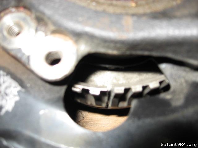

I used the opening where the abs was, to drill a hole, but before making the hole I used a punch to put a dent in the center and guide the drill.
I used 3 drill sizes to make the hole bigger. You will notice that after using the last drill bit 3/8" or so, the groove and the hole are pretty close to be cut all the way.

After all the drilling and cutting, you can get easy access to the studs.
